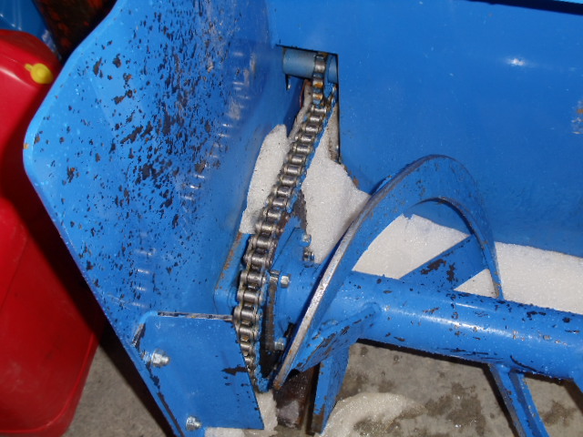

Here is the infamous chain that is weaker than the bolts. :mad:

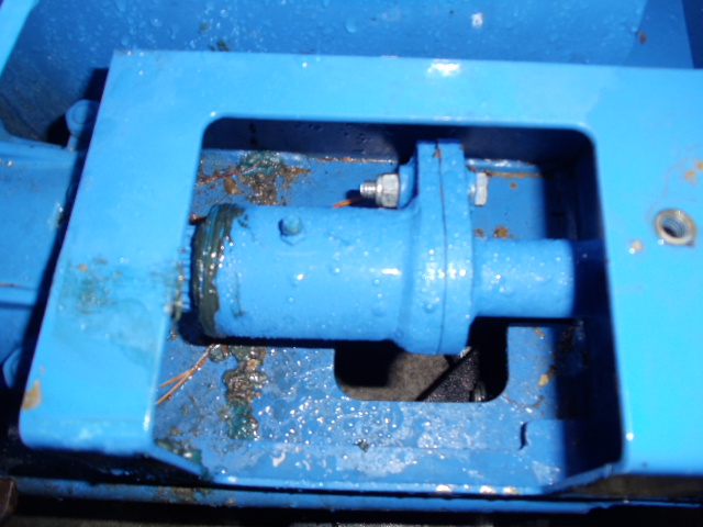

Here is the second stage shear bolt.

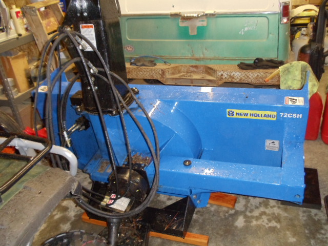

This is the back of the blower. If you look close you can see the black knob that you unscrew to access the auger shear bolt.

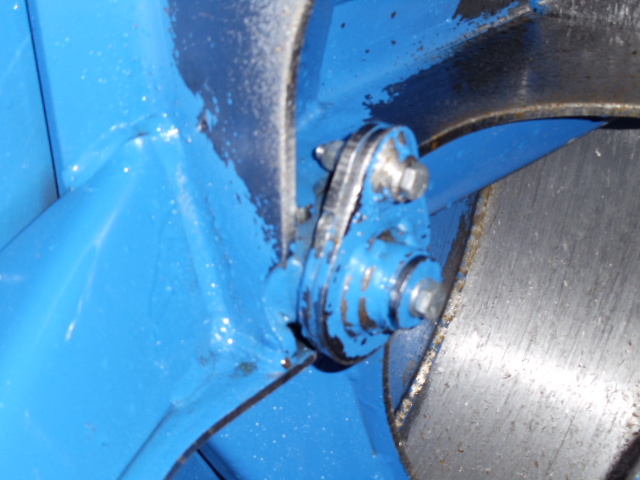

This is the auger shear bolt.
As you can see it is not a tube in a tube. It is two flanges bolted together. The do spin freely when the bolts are not in. Remember that I may have at most 25 hours on this blower. Only 70 hours on the tractor total. I also use the blade a lot like today. Rain sucks in winter.:mad:

That's how both my auger and impeller are set up and I tighten them down, they came tight from the factory. I figure I don't want them loose. If the plates are loose they'll move just a little during normal operation and will cause wear and the hole for the shear bolt to oblong. I've sheared one auger bolt but about 4 impeller bolts so far this season so I would say extra friction of the plates isn't a problem.
Next time I am at the dealer I will see if they have a service manual.
Mine were slightly loose so I put the new one in the same and I have only replaced 1 bolt in the past 4 years.
/ snapped chain.....twice #44
Contact your dealer and see if they have a torque spec. Crazyal tightens his more than I do but would tighten and then back off about 1/4 turn, be sure to use a lock nut.
Check the teeth on the sprockets, especially the one in the back that we can't see in the photos.
If a rock entered there, and broke a tooth off...............that could cause the chain to snap repeatedly.
Or if you are picking up gravel while blowing, that could snap a chain also, if it gets wedged between the sprocket and chain.
My old Cub Cadet, with the belt drive rear tiller.................I could till acres of ground without a problem..............until I picked up a rock, about the size of a 50 cent piece and about 1/4 to 1/2 inch thick. It would get caught between the idler pulley and the belt, cutting that 125 dollar belt in half every time.
My neighbors garden is about 15 ft by 25 feet..............I went thru 2 belts tilling his garden as a favor.

Everything is clear and there are no broken teeth. This has been an issue since I got the tractor and blower. I think I will put the new chain on and see if I have better luck.
That shear arrangement puts the shear point well outward of the shaft axis. This increases the leverage of the bolt -- essentially decreasing the shear force, increasing torque necessary from the sprocket. With this arrangement in particular your bolt should not be backed off but snugged to a couple ft-lb. Are you sure the mfg does not call for shearbolts that are grooved at the shearpoint?

Negative, the bolts will shear when something gets into the augers(or fan) bad enough to stop them, but I think you are getting rocks into your chain, which is before the augers. Thus snapping the chain.
A 2 to 6 inch rock getting in between the chain and the sprocket is probably going to cause a problem.
(Blower picks it up with the snow......snow packs it into the the sides...........gets lodged between sprocket and gear...........snow keeps piling in pushing rock into sprocket.............)
I think we've found the problem.
What lead me to this conclusion was the amount of paint wear (and the pattern) on the blower, in such a short period of time.

I spoke to both of my dealers this morning and they said Kubota does not give a spec for shear bolt torque.
They both did say that they should be snugged and then backed off so the bolt could be rotated but the parts did not rattle around.
They both said too tight and they will not shear reliably.
Hope this helps someone.
