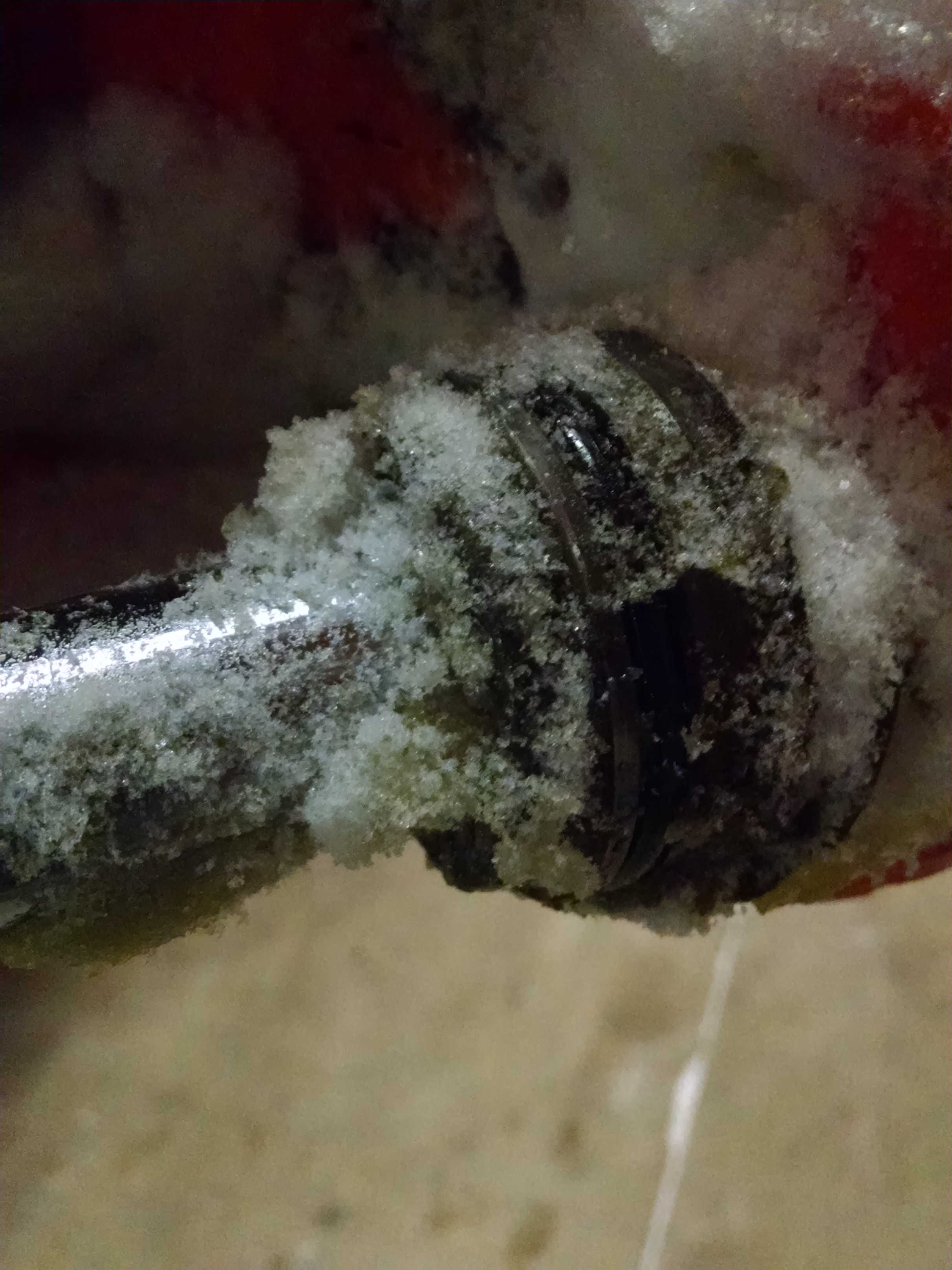

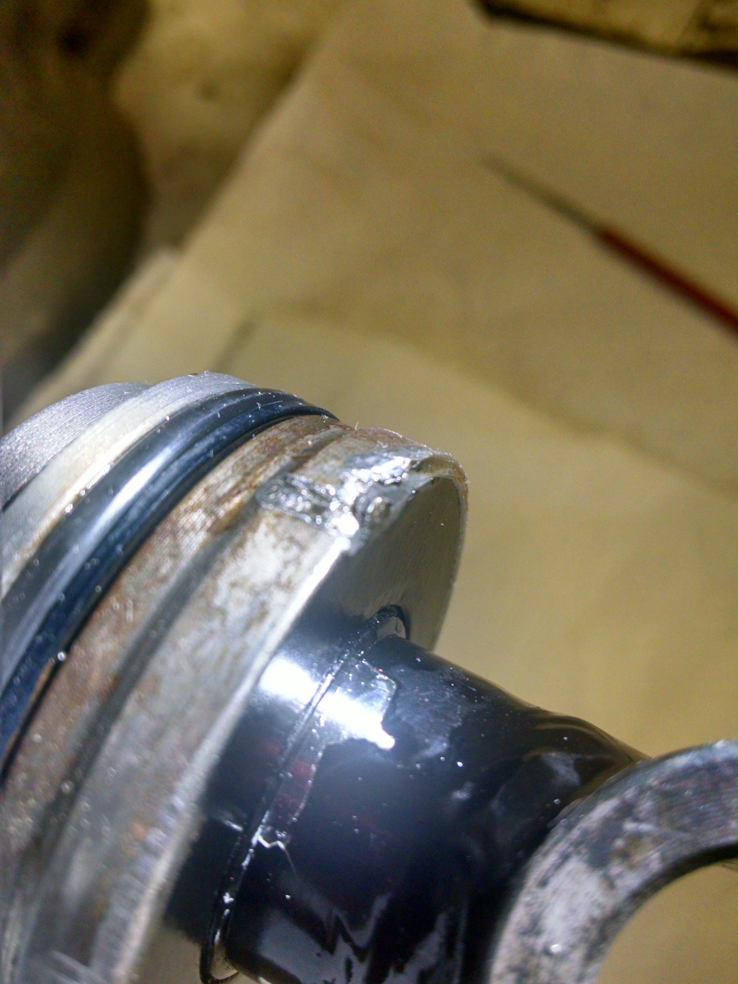

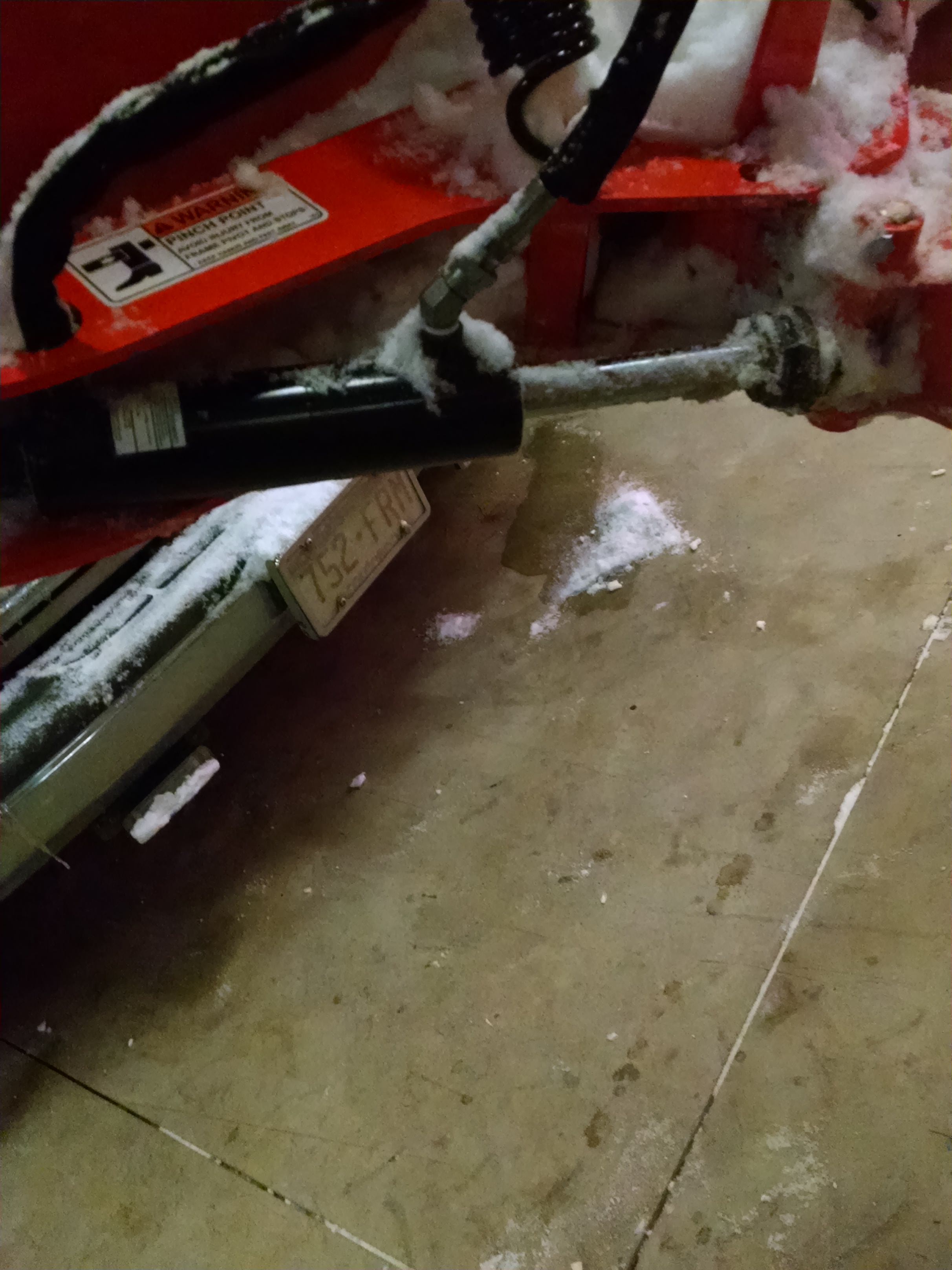

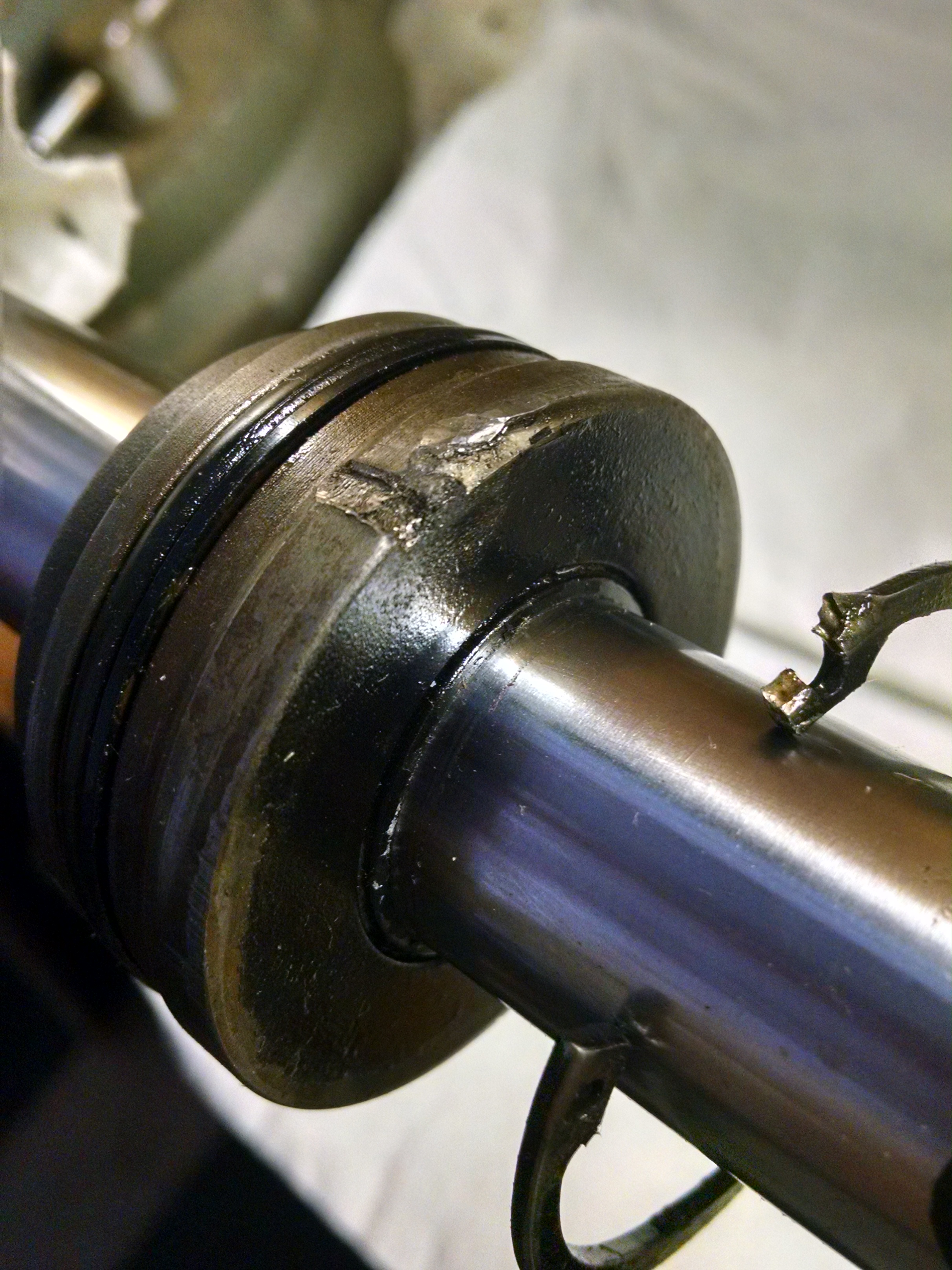

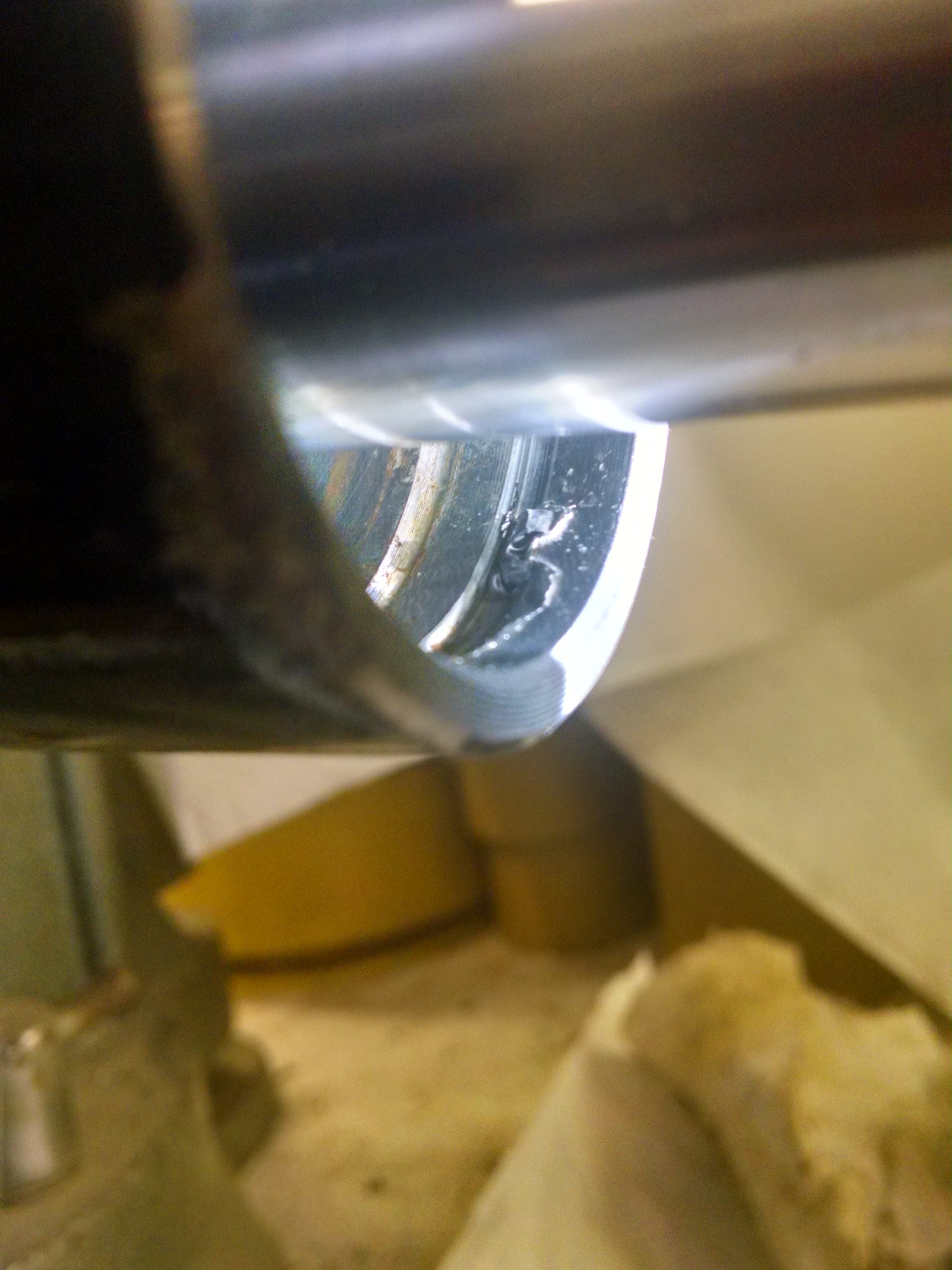

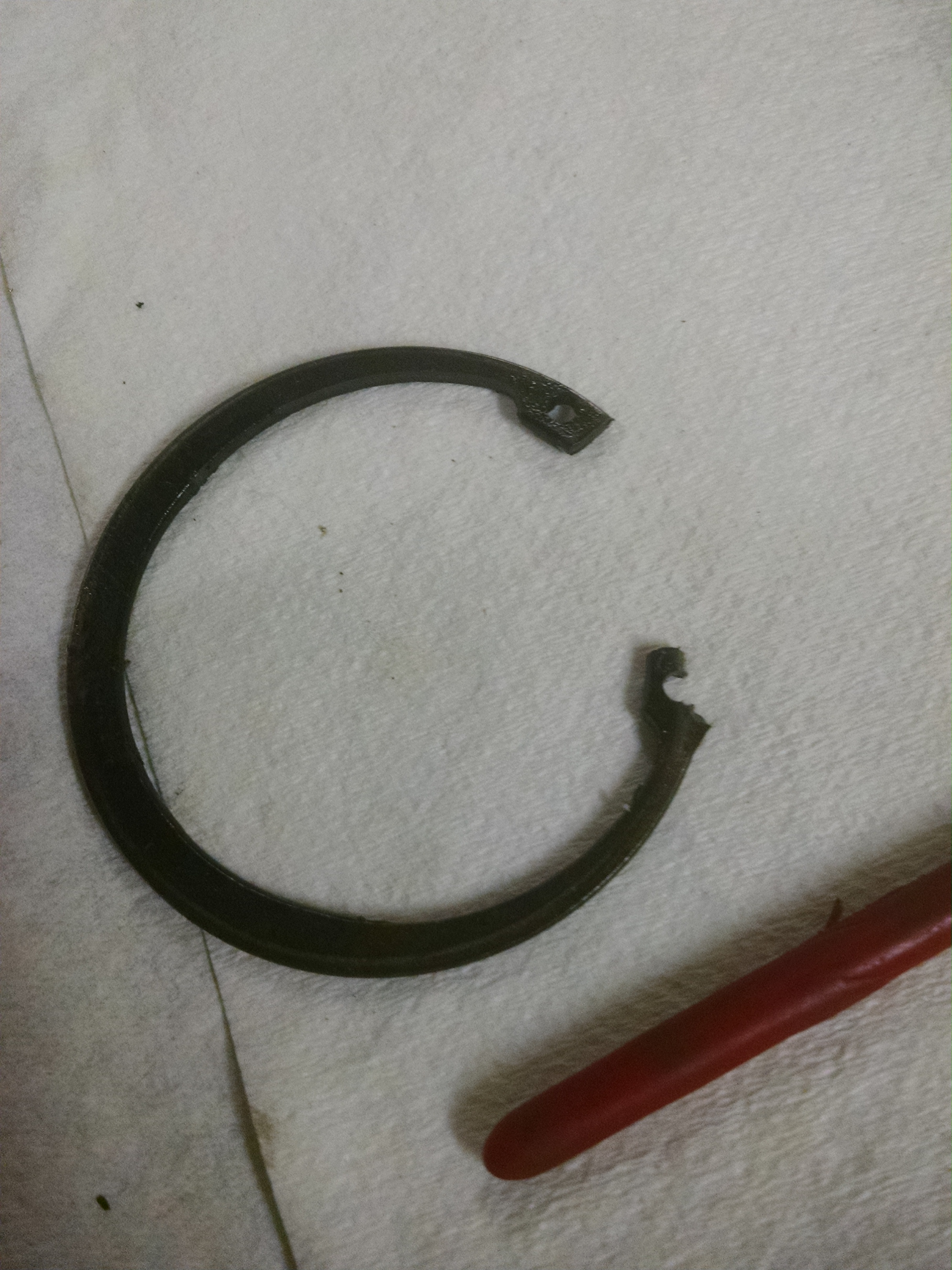

I use a B2759 snow blade. Finishing up my work during the last snow event, I discovered the plow would no longer pivot from right to left. Backing up, I noticed a pool of hydro fluid under the blade. Climbed out to investigate and discovered the DA cylinder end cap had blown out. After pulling the cylinder, I found damage to the end cap and the cylinder. Also, one end of the snap ring was broken. [see photos]
Best guess, gravel got lodged between the cylinder mount and the end cap, and when the angle was reversed, it was driven into the end of the cylinder causing the damage seen in the pictures.
I've got little experience with hydraulics so, my question is: can this damage be repaired, or must I replace the cylinder?
Initial research shows a replacement Kubota cylinder costs $525. I'll explore after-market sources Monday, and will bring the cylinder to some local shops for estimates.
Has anyone else experienced this sort of failure? Is there anything I can do to prevent a repeat? Thinking of cutting a piece of pipe insulation or pool noodle to place on the cylinder rod to keep out debris. I'd welcome any other ideas or suggestions. TIA!

Id for sure go aftermarket cylinder.
But I'd question what actually caused it. And if I was you and could swing it....get a larger diameter cylinder. It dont take much hydraulic power to angle the blade. The trick is HOLDING the blade. When plowing, the cylinder basically becomes the pump.....like on a floor jack or bottle jack. And the plow is the handle, which has a lot of leverage + the momentum/weight of the tractor pushing. This creates ALOT of pressure and cna break things.
A larger cylinder means more surface area the "handle" has to distribute the load over. Meaning less pressure and less likely to damage something or blow a hose or cylinder.
I HATE having a single DA cylinder on a plow for this very reason. A PAIR of SA cylinders and incorporate a $60 crossover valve solves this issue.
   / Snow Blade Cylinder Damaged Repair or Replace? #8
To add to the previous post....."assuming" alot here.
But assuming that the 59 in the model number means its a 59" blade.......and 6-1/2" stroke cylinder.....and "assuming" you have about 30* of angle left and right.....the plow has ~5:1 mechanical advantage over that cylinder.
With your cylinder size.....@ 2500psi.....you have ~5800# of pull force (retracting the cylinder).
That equates to ~1160# at the edge of the plow. So in "theory".....if you hit something with the edge of the plow that makes the cylinder try to extend.....with a force greater than 1160# (which isnt hard to do with any momentum at all)....you are over pressurizing the cylinder and have potential for failure just like you experienced.
Going to a 2-1/2" cylinder with a 1-1/8" rod like mentioned....gives you 9800# retract force. So you would have to hit something with more than 2000# to cause an overpressure situation.
