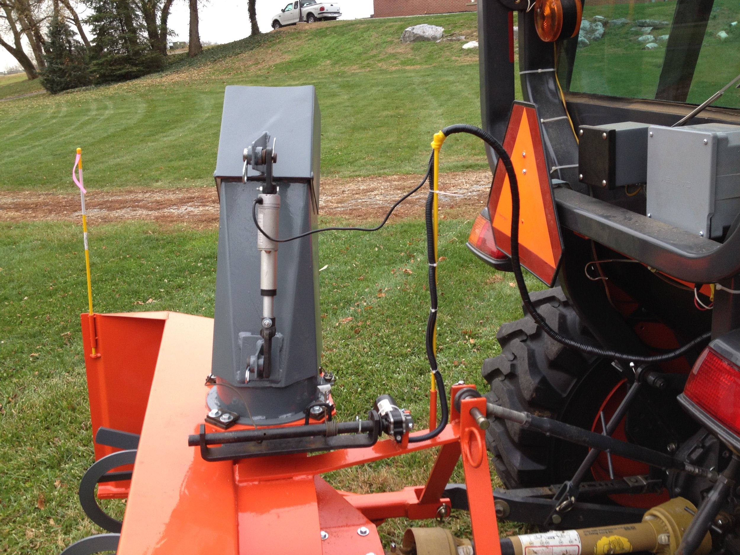

/ Snow blower chute rotate #7
Small electric motor with an adaptor for rotation and a linear actuator for chute up/down.
That looks like a great solution. What kind of geared motor is that?
It was for a car seat. It worked OK while I owned it, but it would sometimes need a little help when slush froze the metal-to-metal joint. Once broken free it was fine, but I'd use something with a little more torque if I started over.
