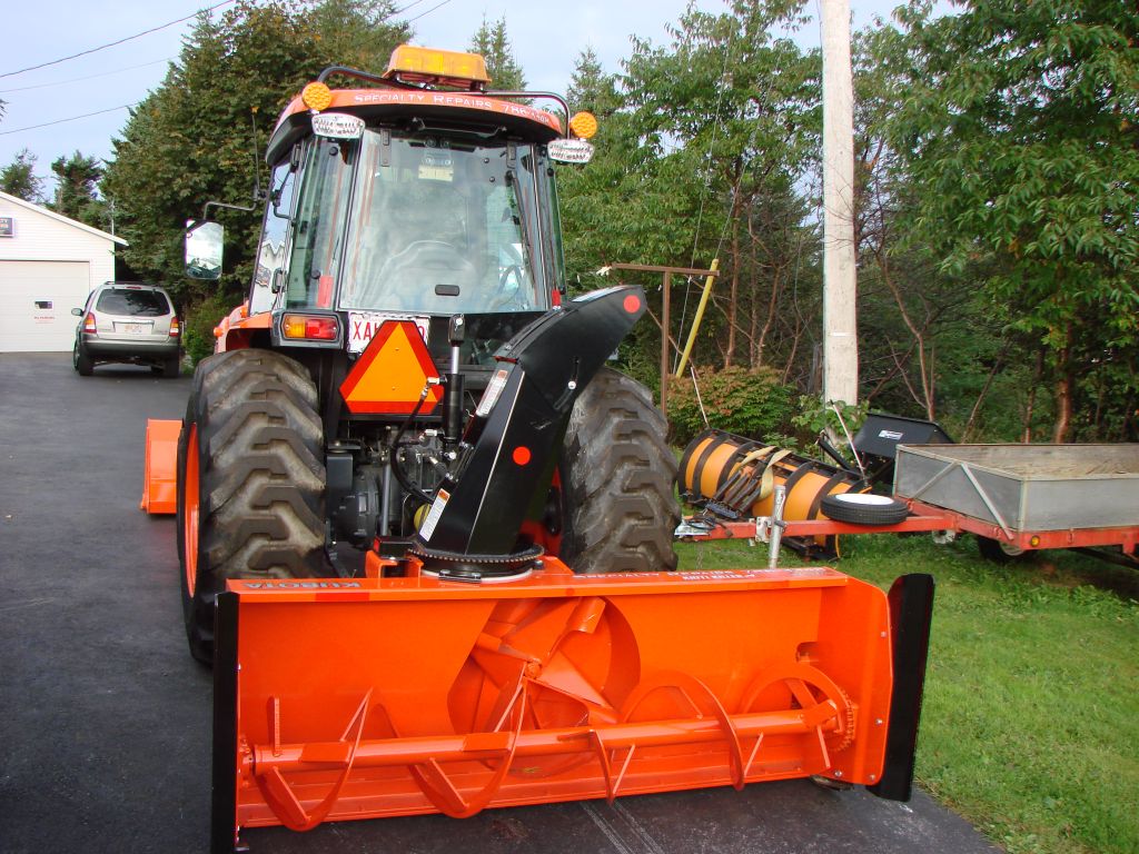

I just installed this on my Kubota. It was part of the deal when I purchased the tractor a few weeks ago. It was an easy install because my tractor came with two rear remotes. You could easly get all the stuff you need to maske it up at Princess Auto.
