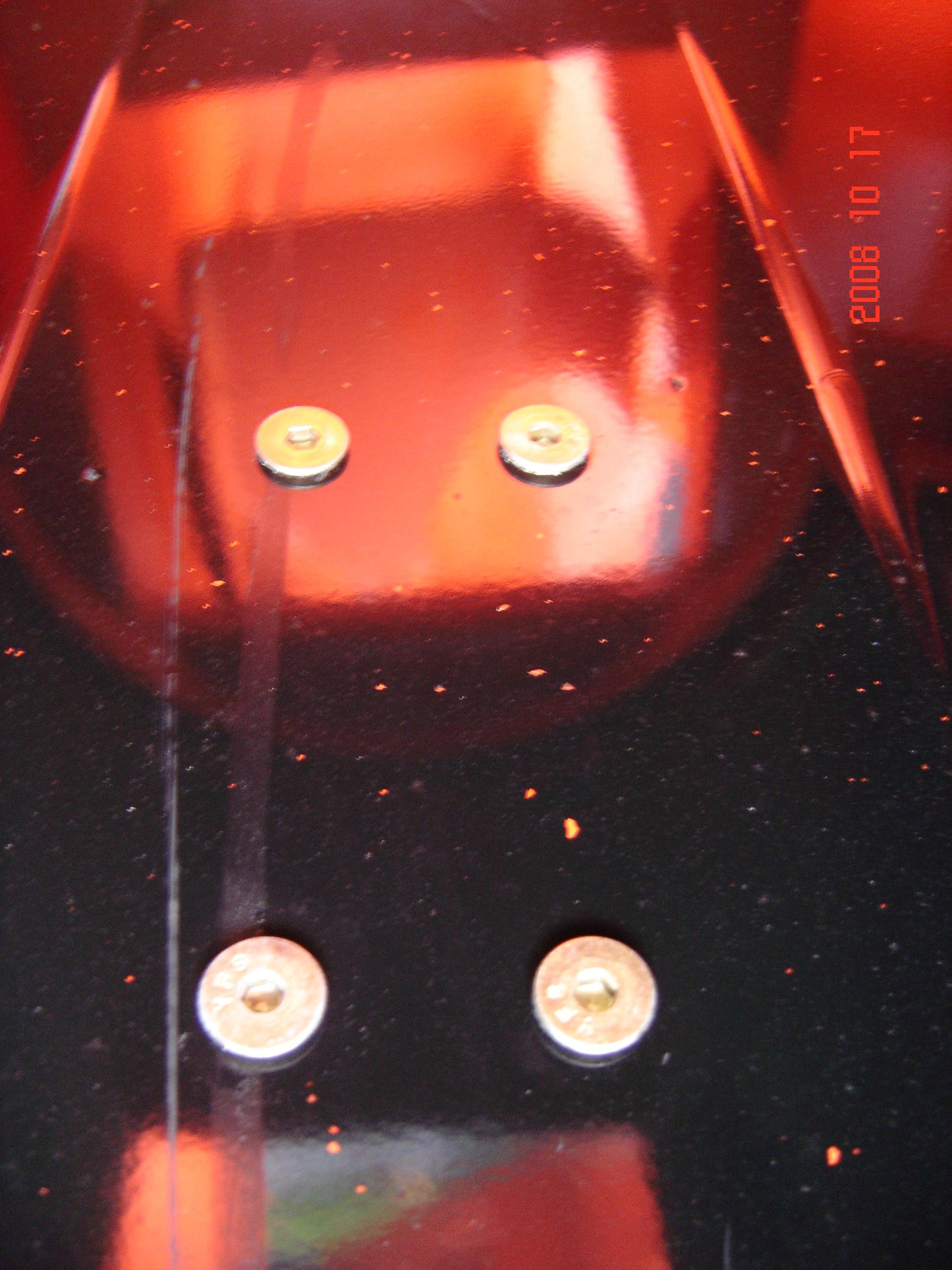

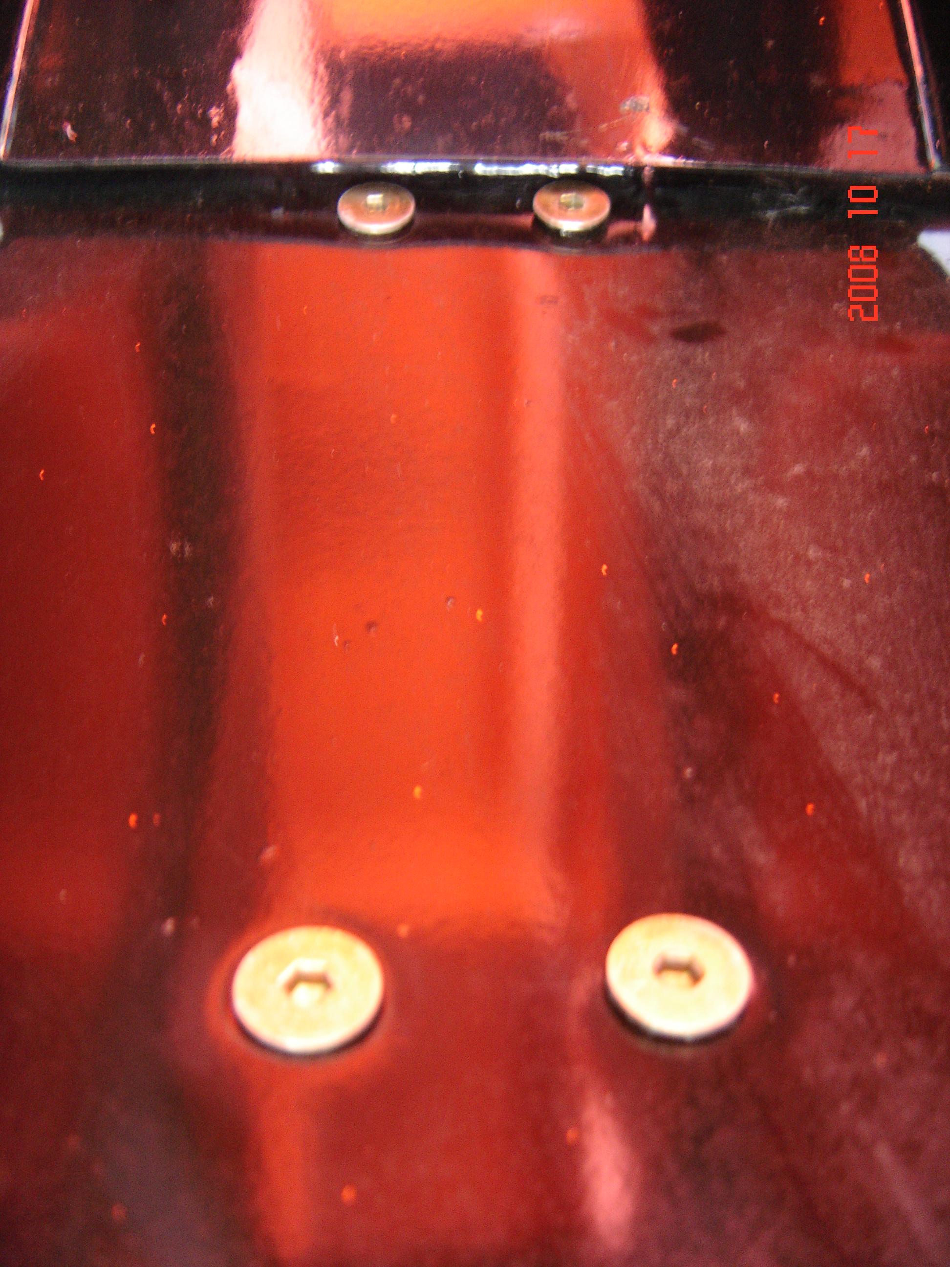

Great pictures and information on your chute set-up ! ! I'm assuming those are Kubota kits?? Do the brackets that are bolted to the chute for the cylinder mount have a plate on the inside of the chute, or just washers for the bolts??
Thanks for the help.
Great looking rig, by the way ! !

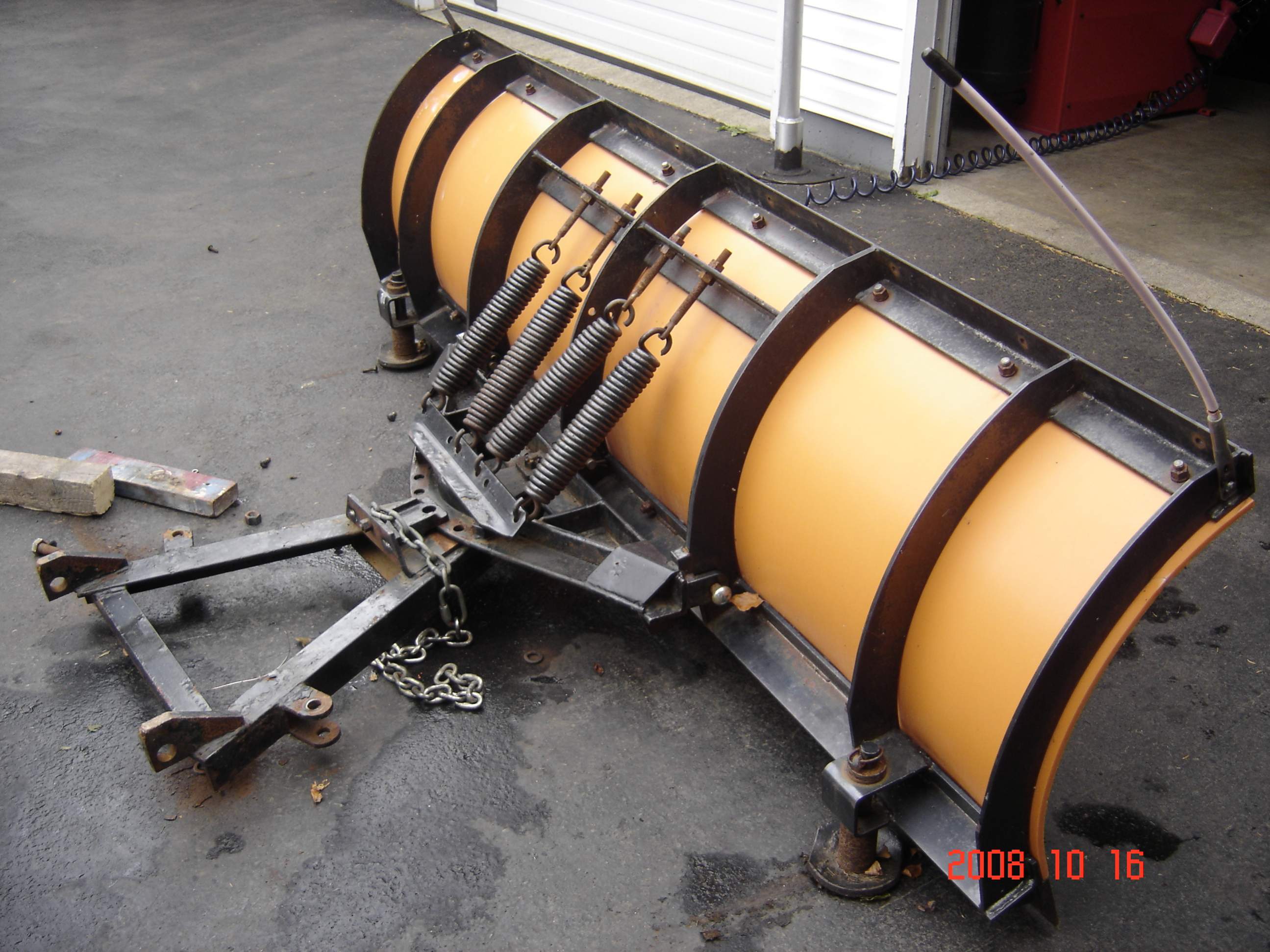

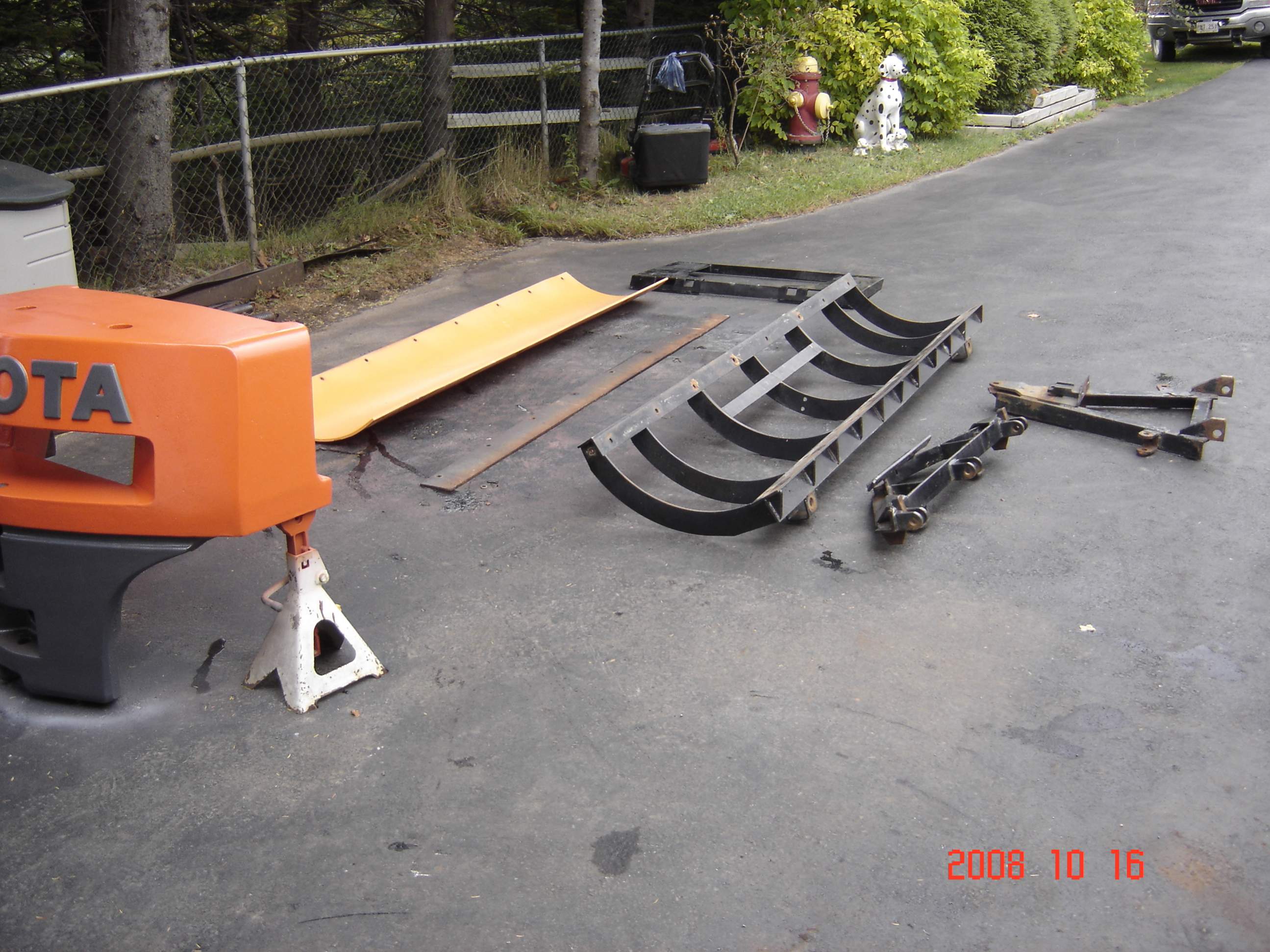

Yep that is a Kubota kit. There's no plates on the inside. It came with countersinking bolts. I guess they were countersinking so that the snow would hold up in the chute. Here's a few pics of them I just snapped for you. I'm about to do the fabracation work to adapt my angle blade that was on my truck to the Skid steer FEL so I'll be posting the process soon. Glad you liked the pics!:D
