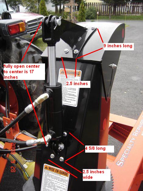

Thank you for the great picture...just one question!

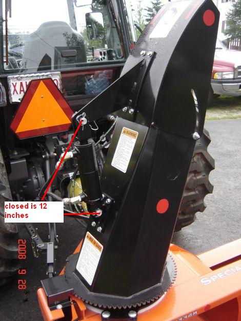

Can you give me the closed and open length of the cylinder and also the total length of the mounting brackets top and bottom?
I do realize that your blower is larger than mine but it will give me a rough idea for my electric actuator fab-job.
Thanks

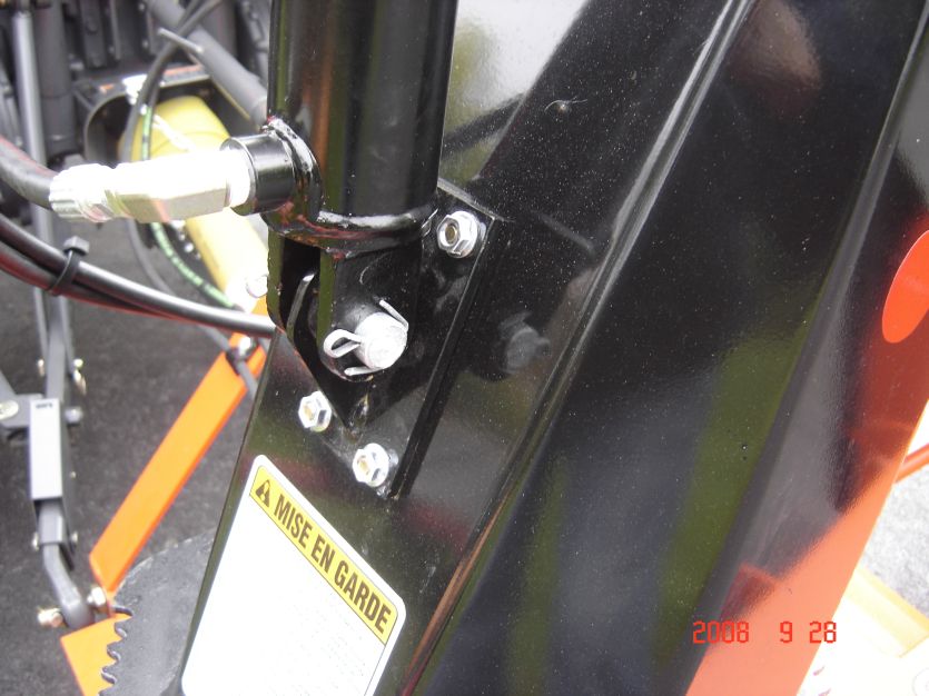

Hey you go. I attached a few pictures of it. If you need any more info feel free to ask me. I like the hydraulic system. It's very strong and very reliable.

Some more pictures. The rod dia on the cyl is one inch.

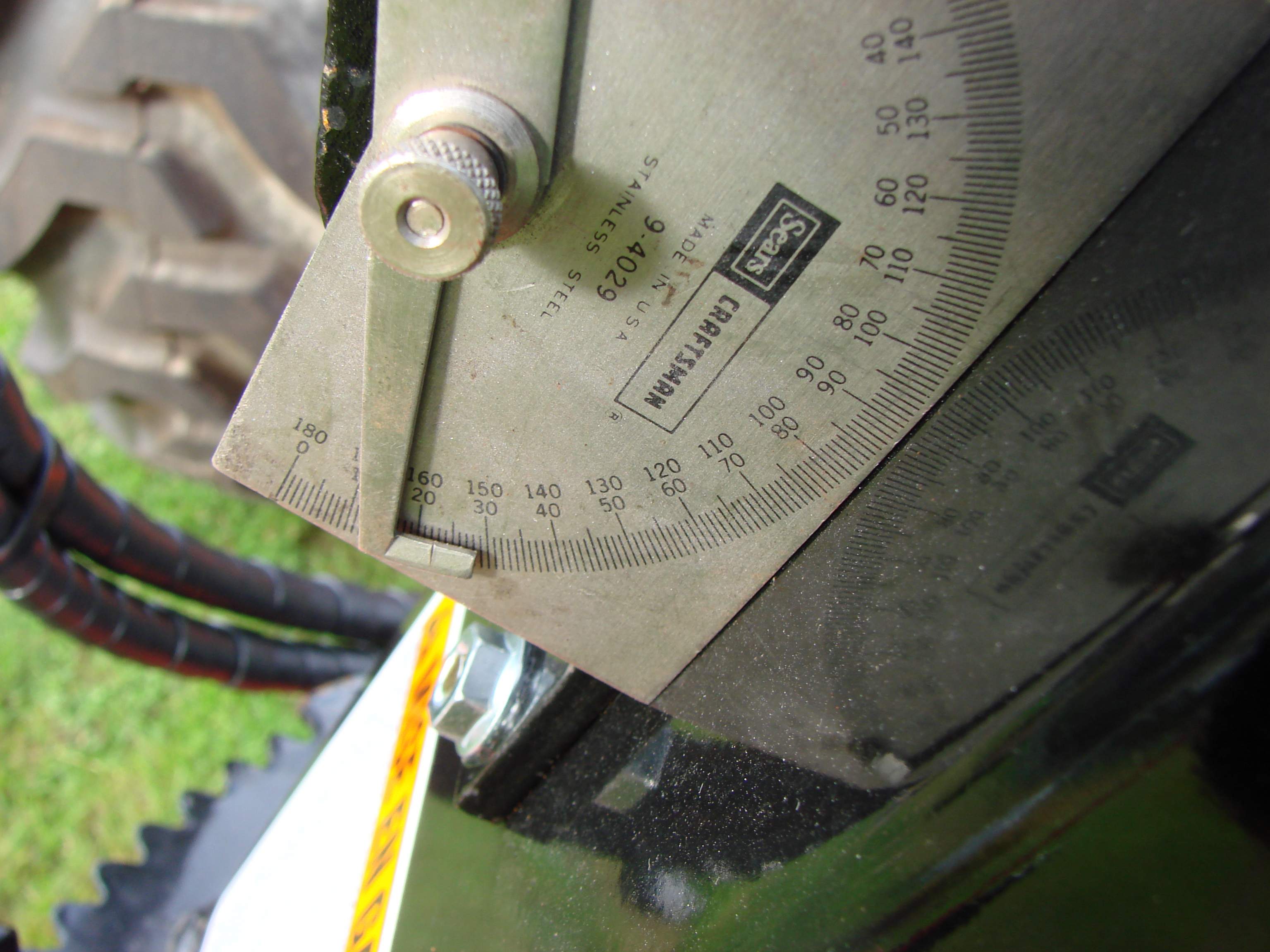

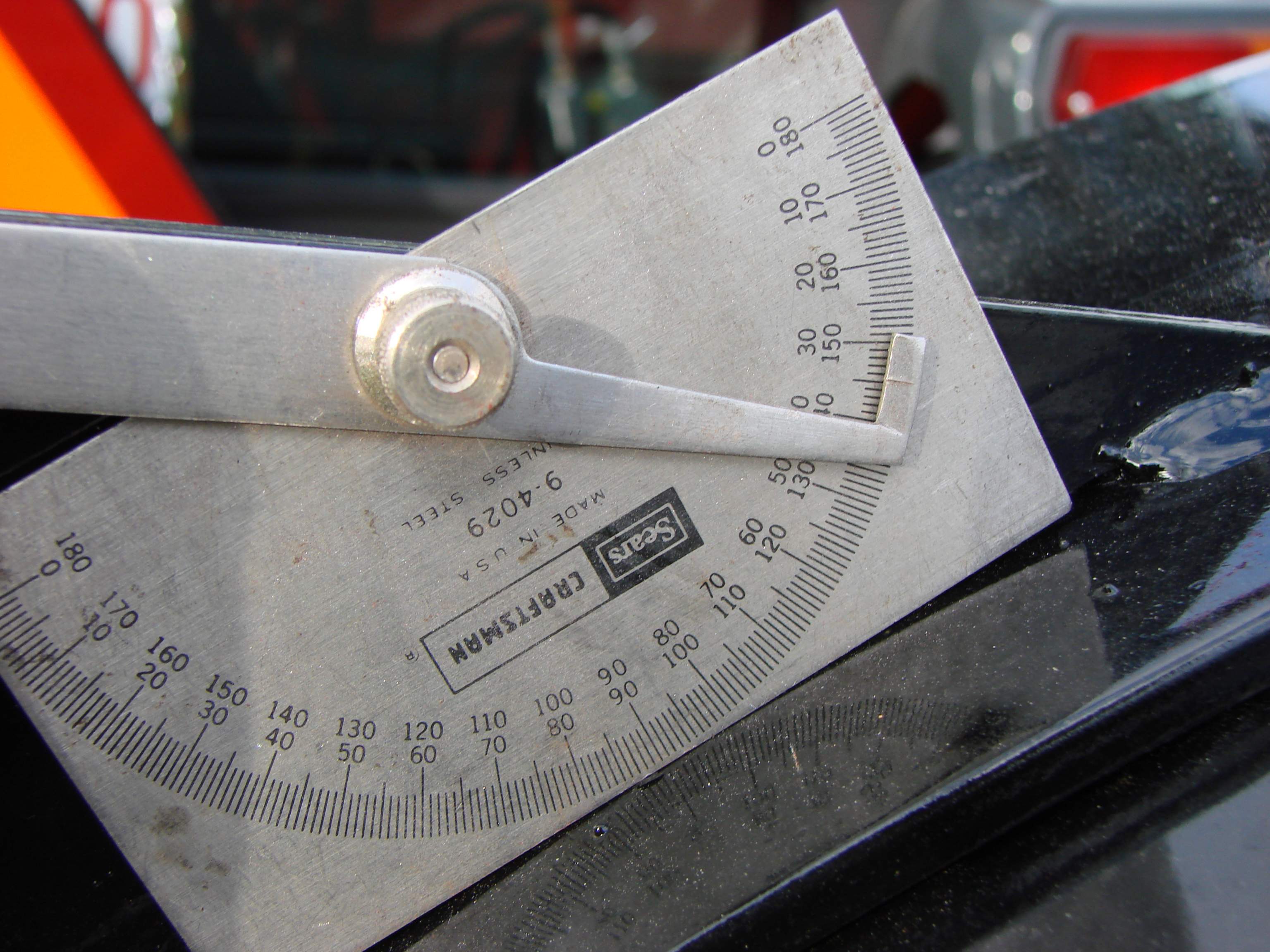

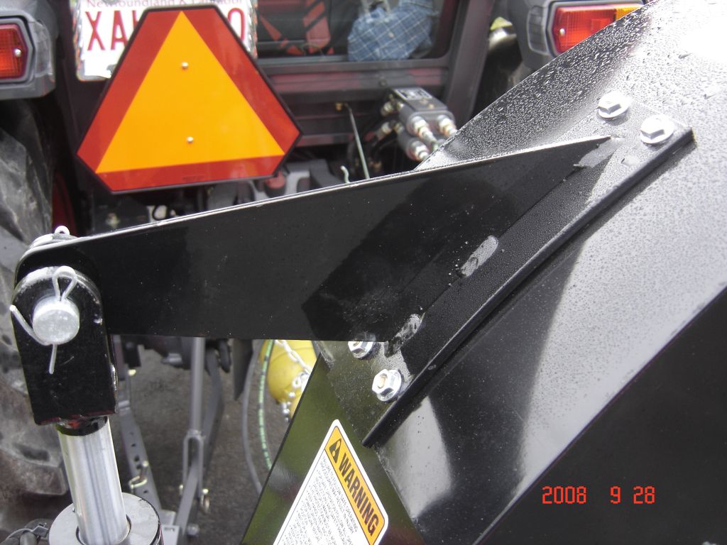

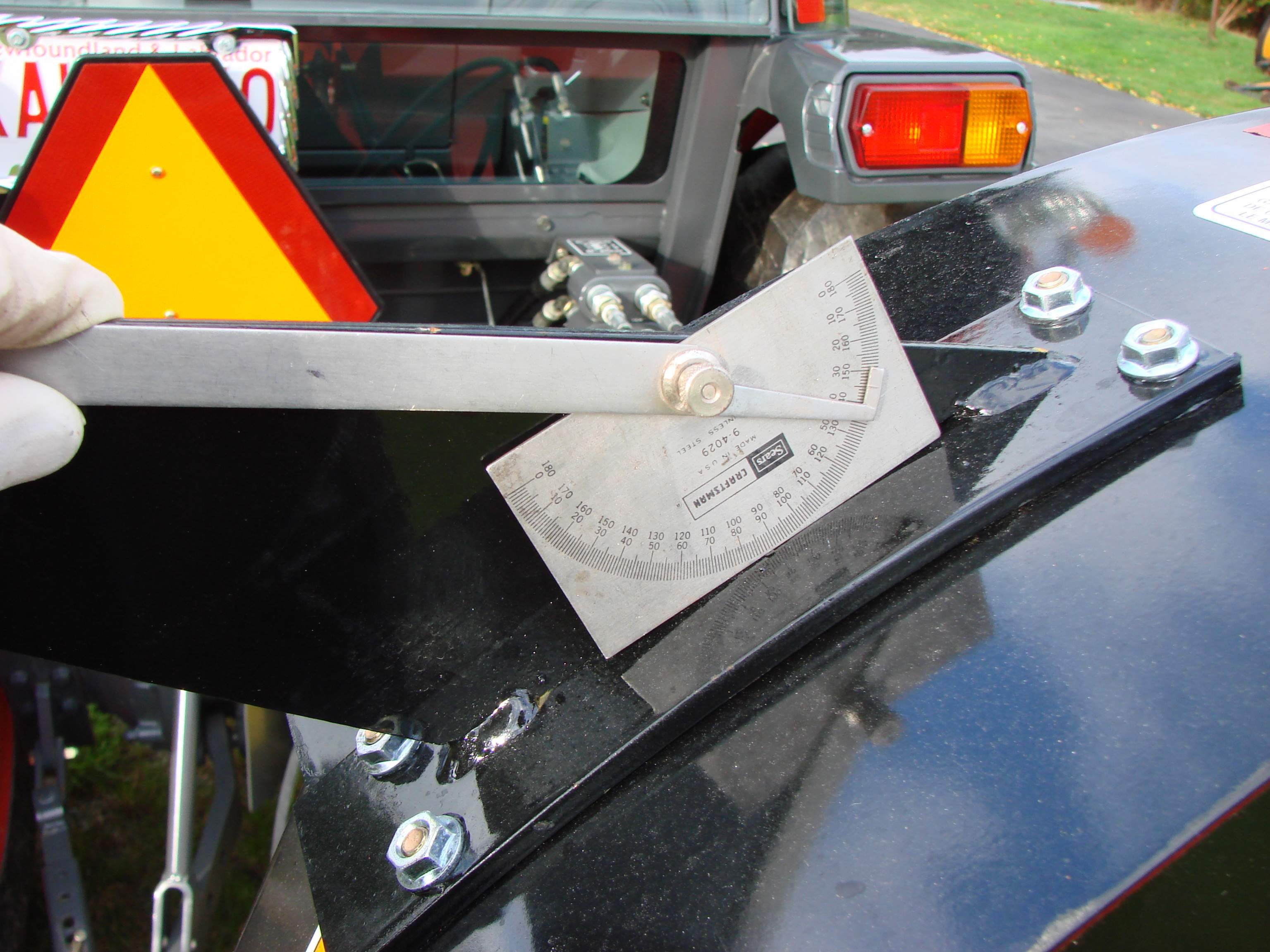

4 shorts;

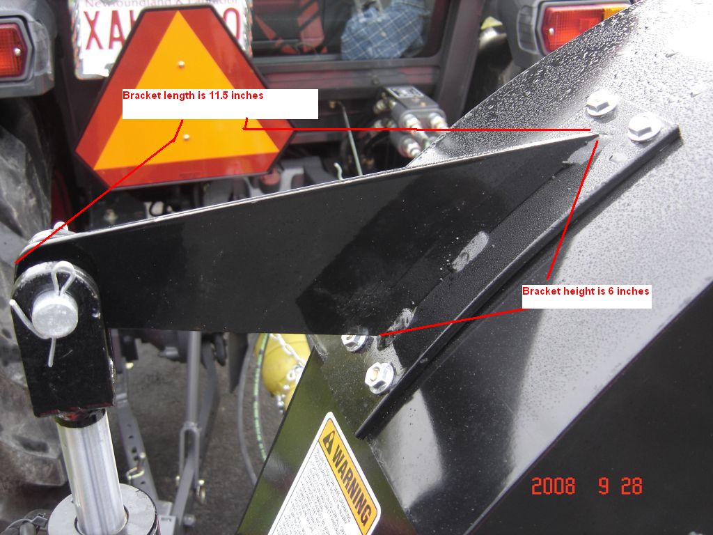

Sorry to be a pain in the **s but one more question...
Could you send me the angle of the top chute braket?
It looks like 120 on top and 45 on the bottom but I'm guessing.
Thanks a million!

Man your no pain. If I can help feel free to ask my friend. I attached a few pics of it for you. If you need any more info just ask. Paul

Great pictures and information on your chute set-up ! ! I'm assuming those are Kubota kits?? Do the brackets that are bolted to the chute for the cylinder mount have a plate on the inside of the chute, or just washers for the bolts??
Thanks for the help.
Great looking rig, by the way ! !
