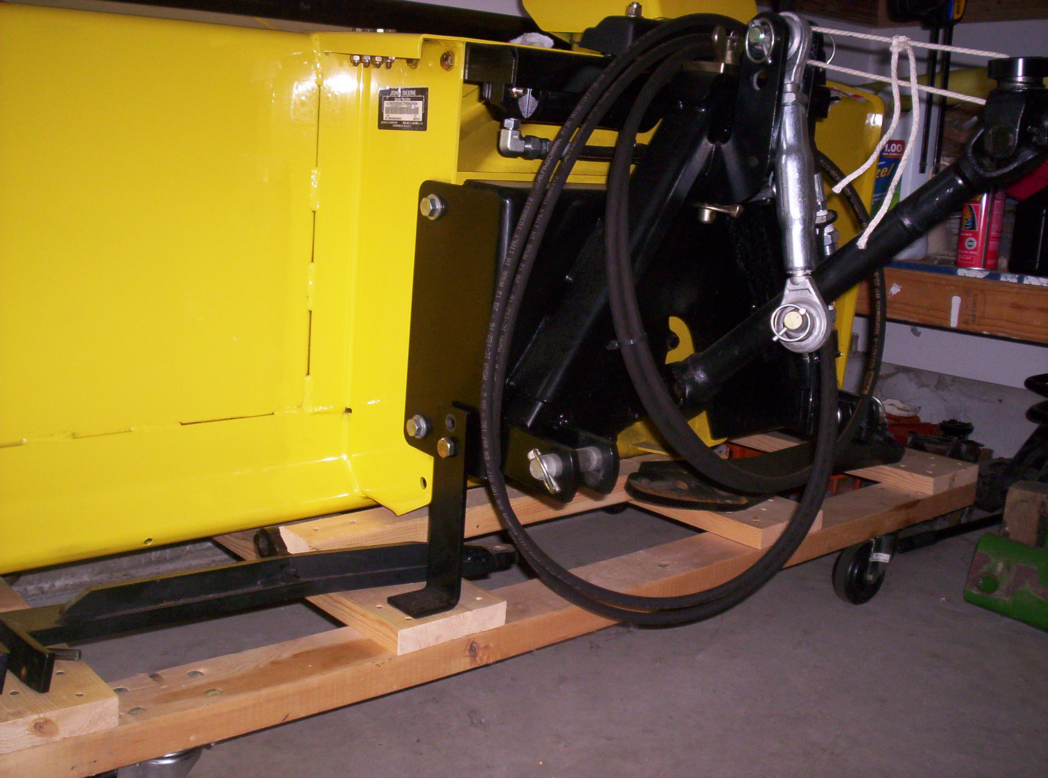

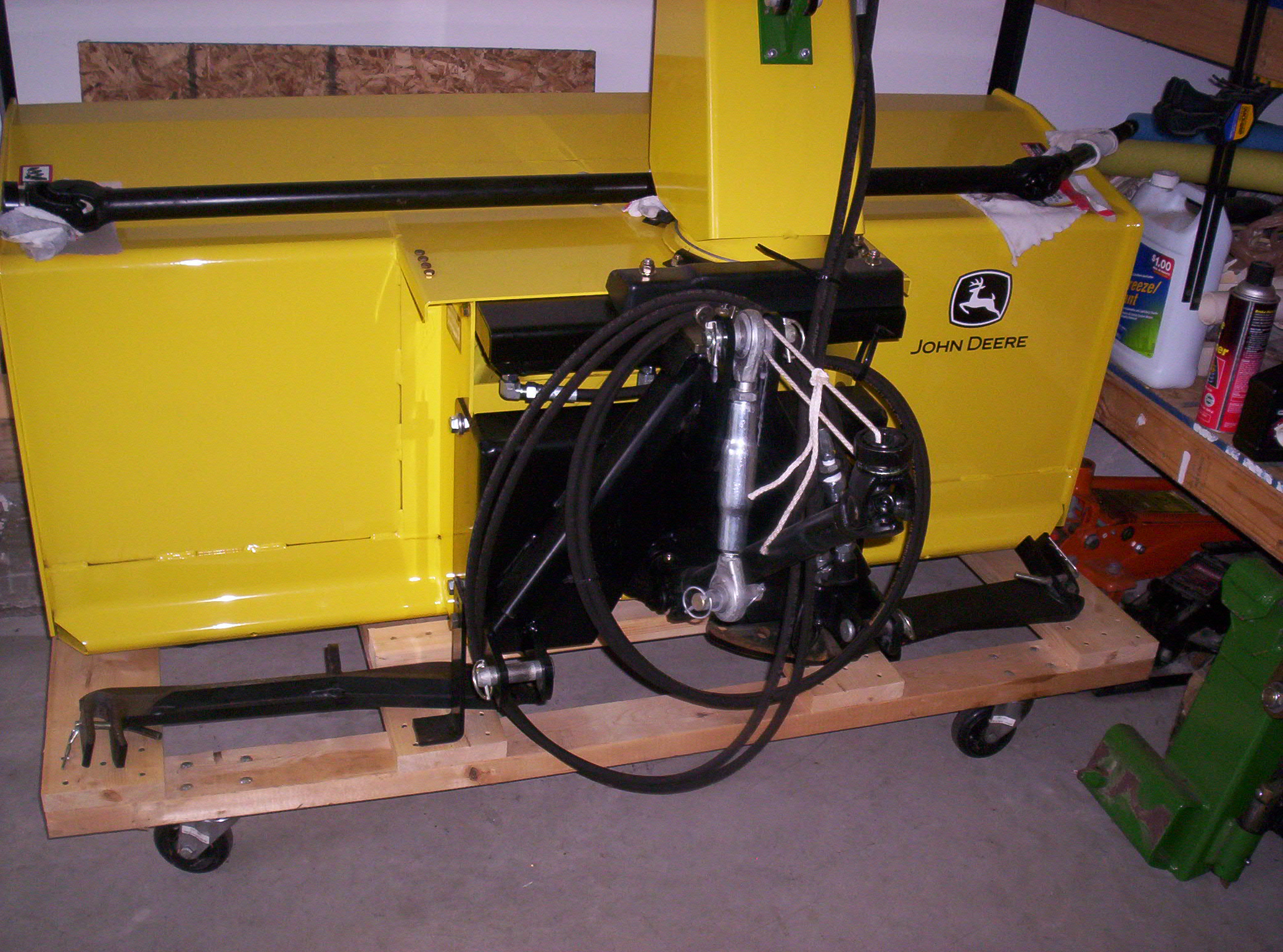

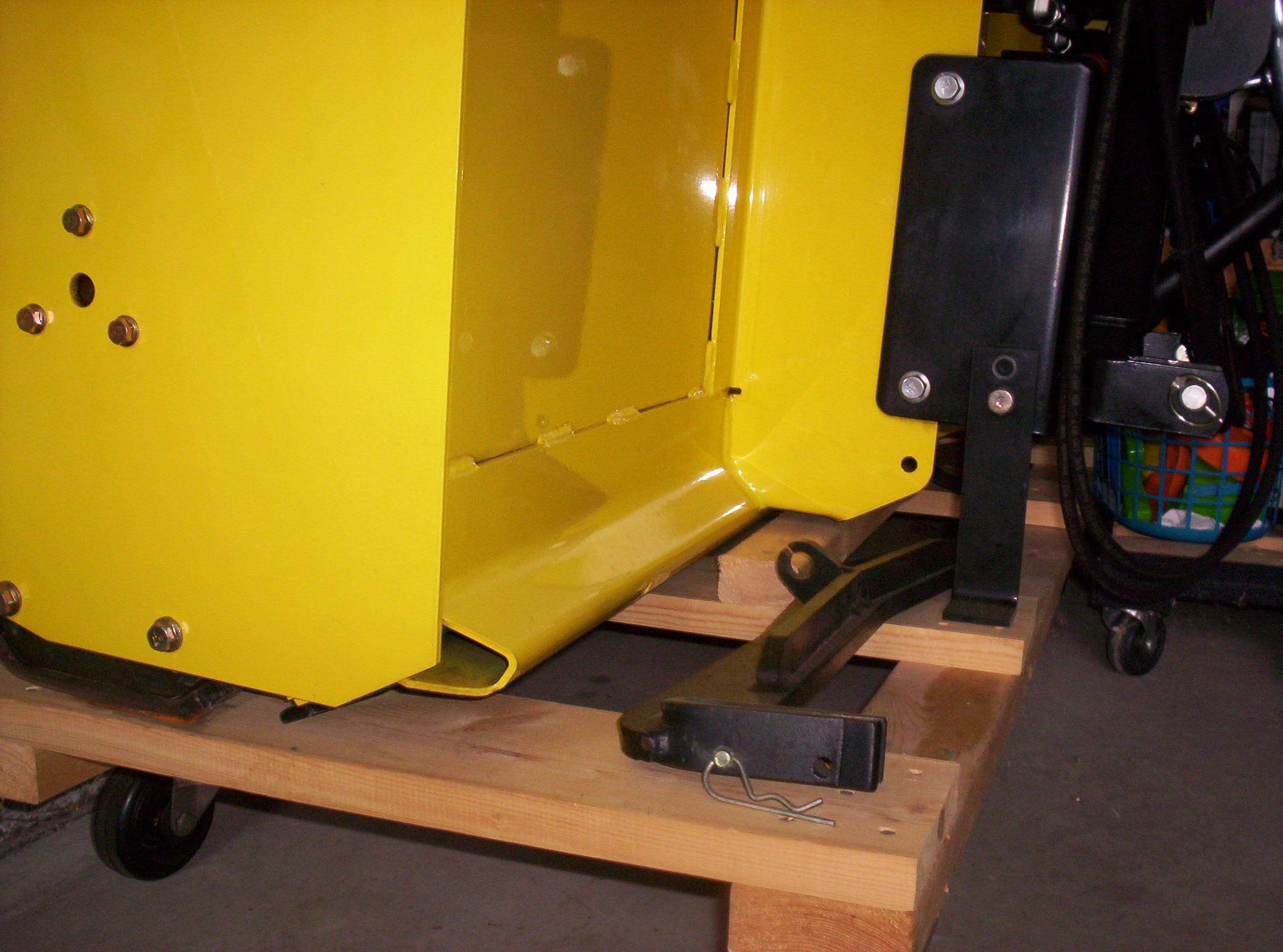

/ Snow Blower dolly #8
degerb, this is what I use. Four wheels from HF and a little wood. I can move it around with ease and it only took a hour or so to build.
I plan on having the blower for quite a while. IMO, it's worth the time to build it.
/ Snow Blower dolly
#9
Thanks Rockgod.. It looks good, what size casters did you use? I have a bunch of 2X lying ariound so think I will try to put one together. Heck, if I don't like it I'll build a rolling workbench or at the worst I'll tell my wife I built a rolling flower box! LOL
/ Snow Blower dolly #10
Those are 4" casters rated at 330lbs each. They might have cost $3.99 each at HF. I don't think you'd regret building one.. :thumbsup:
