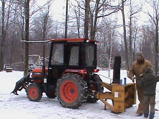

I have a Lorenz snow blower like yours maybe smaller and it will throw most snow upwards of 30 feet or more, really wet stuff half that distance.I dont use anything in the shute.Travel speed does make a differance with it, i can go faster in light snow than i can wet snow of the same depth.
