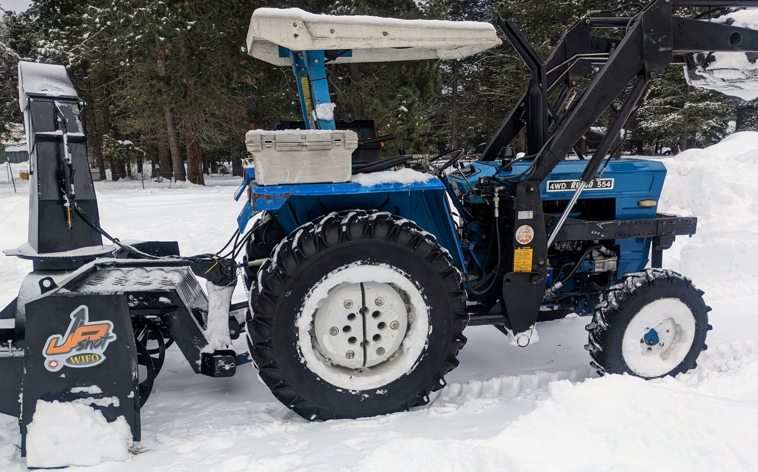

The chute on the WIFO It is tall.
I caught mine on some pine tree branches. Here is a pic the rear tires on the tractor are 14.9 x 28 R1's.

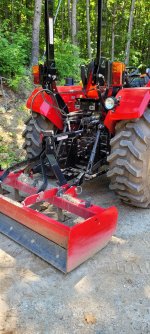

Also to update the thread, I have to admit that my avatar picture is outdated. Pictured is my old Mahindra 4540 with R1 ag's. I've since replaced that tractor with my 5155 with has R4 industrials. However, personally haven't noticed any difference in snow compared to the R1's. My Galaxy R4's have somewhat of a hybrid pattern, and I really like them compared to other tractors I've used with the traditional huge-lug R4 pattern. Those things suck IMO.
I do have studded aquiline chains mounted on the rear and an additional set for the front if I find I need them.
I actually haven't taken any snow photos of it, I should. I'll post some once I get the new blower and pusher attached, I'm picking them up later this week and by the looks of the forecast I'll be testing them out this coming weekend. But, here's an older pic to give you an idea of the tread pattern.

Hi Walt, With chains the hybrid R4's should provide Lots of traction.
If the distance from the PTO to blower input on your Mahindra is similar to my tractor you will have to shorten the PTO shaft.
It was a bit of a shame on mine since I had to cut enough off[part of the shaft, that took the 3 nicely installed zerks with it.
The shaft also comes with a tubing stiffener which will need to be slid on the tubing as well but is no big job.
One other thing I ran into was the Cat 2 spacing on my Rhino.
It pushed the 3 point arms really close to rubbing the tires inside.
For this year I ran it like that for the first snow and then switched to the Cat 1 mount width and used bushings and some washers to space it outwards.
This summer i will do a couple mods for next year along with a hose stand off or the rotator and deflector.
Here is Hoping you are as Happy with the WIFO Inverted blower as I have been.
