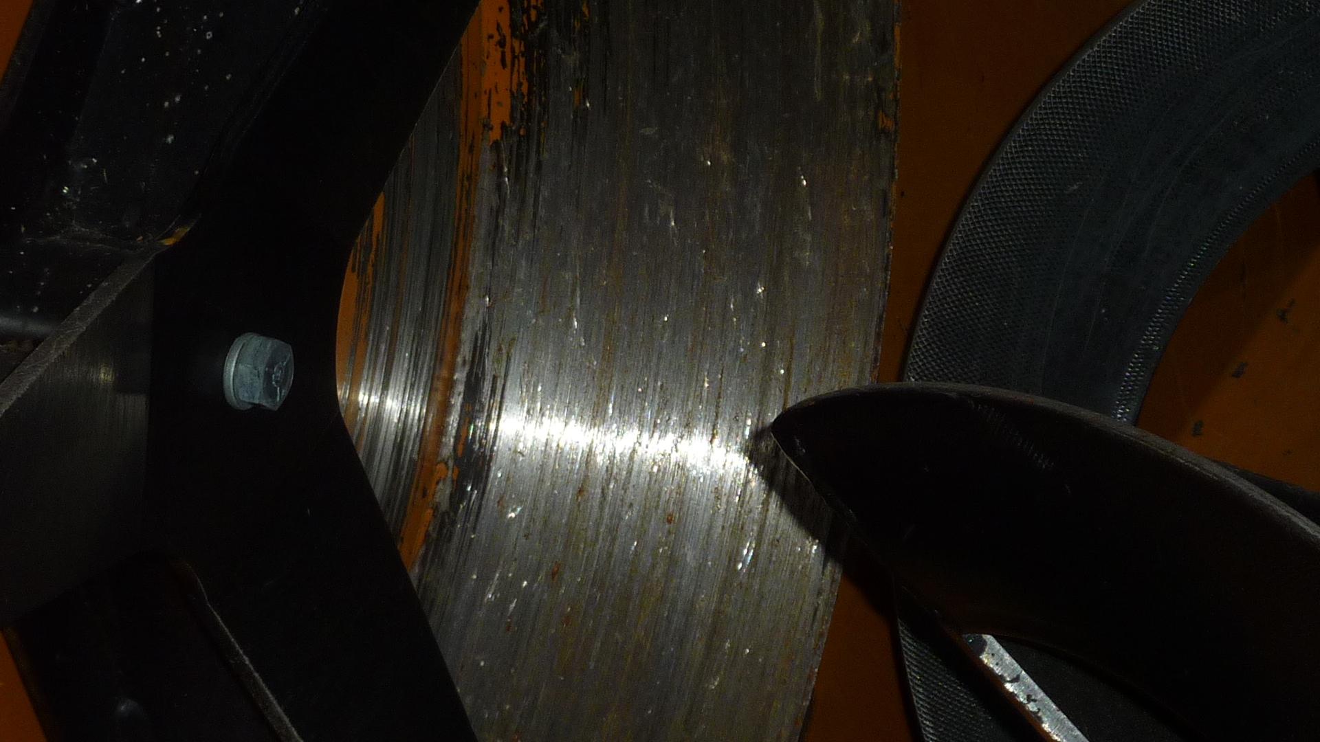

Unless frozen, gravel is definitely a problem for both a blower and a FEL plow. The plow leaves it in piles along with the snow and usually can be raked back into place. The blower spreads it out over a wide area making it difficult to recover. Gravel also does a fair amount of damage to the blower impeller housing.
Like several posters above, I find the hydraulic top link to be the best tool to minimize gravel pickup with the blower. Extending and retracting the top link causes the blower to "rock" back and forth on it's shoes thus raising and lowering the cutting edge without lifting the blower off the ground. I usually run with my hand on the valve handle and tilt the blower back as soon as I hear gravel in the discharge chute.
