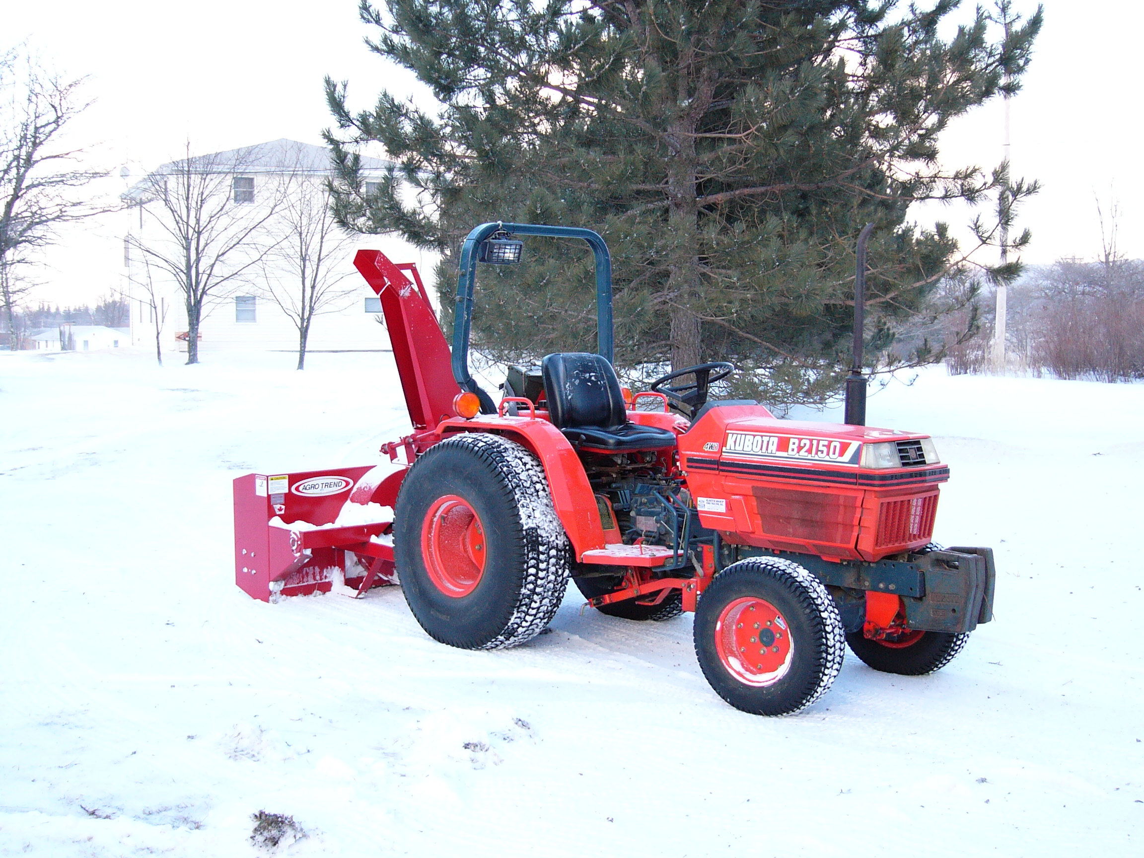

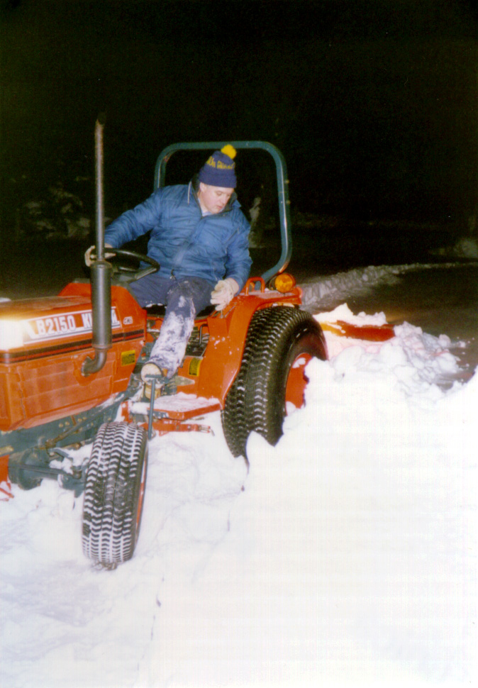

To respond to your inquiry: I do not live where there is frequent deep snow. However, every winter I go to my vacation property several times where the annual snowfall is often 200 inches and where many times the snow has been deep, hardpacked, drifted, wind packed, etc. before I ever get there. I do not have accurate statistics but there have been many times when the cars got hung, people with or without 4WD got hung, and when the packed snow was 2 or 3 feet deep. I use a Kubota B2150 4WD tractor. Eventually I evolved into using a front end loader and a rear mounted 5ft blower. In less challenging cases I use a rear blade . Then when the Kubota won't work with the rear blade (See below) WV Tractor.jpg I use something else.
I could have added chains but that was not the solution. I added a 5ft blower which is the right tool if/when the snow greets you feet deep, hardpacked or partly packed and you cannot get in with the car or the truck. P1000116.JPG You really need to know the whole context to decide what tools are best.
