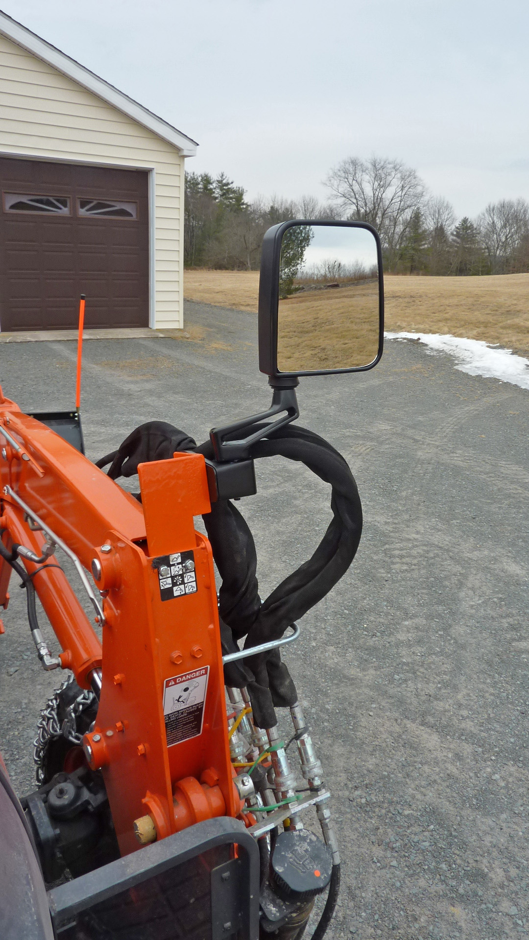

Before I put a jumper on the switch, I used to kneel on the seat facing backwards while blowing snow.
After trying various ideas, I now use these Jeep Wrangler mirrors bolted to the FEL frame:
They don't vibrate like others I've tried. It takes some practice but I don't turn around much anymore.

My tractor seat rotates 45 degrees which is ok for long runs, but too much hassle for frequent changing. I installed front and rear cameras recently, and they work very well, although I'm not used to using the rear camera yet.
I do like the large mirrors in this thread - nice work.
FYI, there is an ebay and/or Amazon seller that is making up some nice looking large mirrors that are magnetic mount. I would have definitely liked those (or the bolted on ones) on my previous open station tractor.
