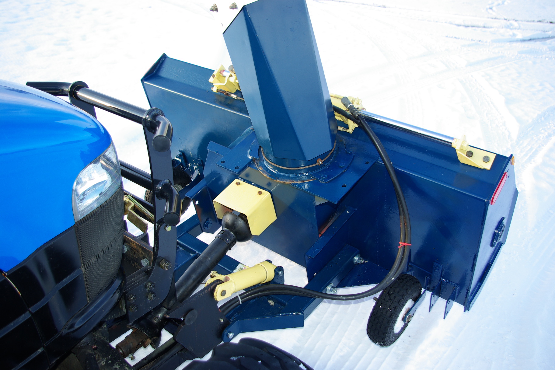

I am new to a snow blower and in fact I don't have it yet due to the snow and ice back east.. Ironic that this Is holding up my blower.. Anyway my question is do you set up the top link to tilt the machine back a little so it wont scrape up grave.. Folks over here in western Montana say it wont work but I say it will if it is set up right.. Right now the two of us who plow the road use back blades and we try not to move the gravel off the road now so leaving an inch is ok.. The road has a surface of 3/4 minus so it is fairly small stuff. The blower I am getting is a 3pt rear mount so year I will be going backwards.. Also I was told that I might want to experiment with a backup camera to use so my neck is not permanently kinked.. :laughing:
   / Snow blowing set up for gravel road #2
Assuming your blower has adjustable shoes, set them as high as they will go. Then set your top link so the shoes are tilted up about 1/2 inch. This setup will reduce the amount of gravel scraped up. Also before the snow season starts, grade your road as flat as possible eliminating humps and dips. One other thing, if you have any gravel larger enough to damage the blower (> 2 inches) remove it with a rack before the season.

   / Snow blowing set up for gravel road #8
I bought this blower as an incomplete front mount and converted it to a 3 pt mount to use on my previous tractor. I put the wheels on it for my gravel driveway and they work very well for straight line work. I made them adjustable but it was much simpler to adjust the top link to vary the clearance. Would start out with about an inch and as the snow and ice built up, could make it about level. It is a 5 ft blower and these tires were rated 300 # apiece. Now, a different tractor (TC33D) and with a lot of cobbling, made the front mount work and the photo is the finished toy. I think the center of gravity changed because the wheels worked a little better with the 3 pt. setup- the hitch supported some of the weight. With the last month and a half of TRUE winter we have had here, I took the wheels off (via axle bolt) and put the original skids back on to cut almost level. I will leave the skids in place and start again next winter with the wheels. Give you some ideas to work with!!! IMGP7312.JPG

Another option to consider with a larger blower, is to put wings outside of the blower to gather a larger swath of snow. With the wings installed, that makes room behind the wings to attach a wheel on each side for the blower to ride on the gravel. The wheel would be centered over the cutting edge and again would work well in a straight line. I have seen this type of setup but I have no photos. A suggestion for the fastest neighbors, hand them a rake and ask them to rake the gravel out of the grass back into the drive, slowed my neighbors down.
