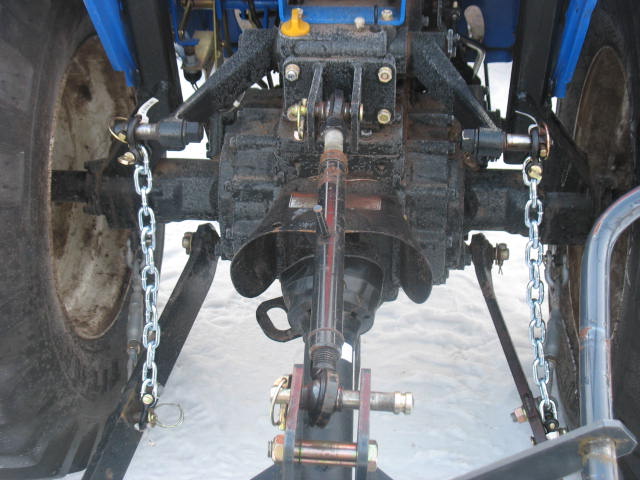

here are the chains I mentioned. I can't claim it as my idea - I learned about it here.
