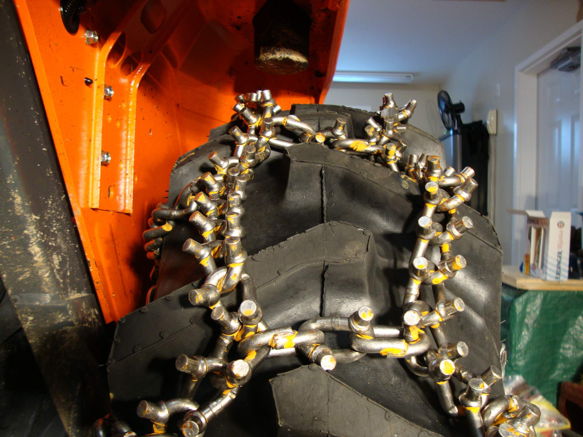

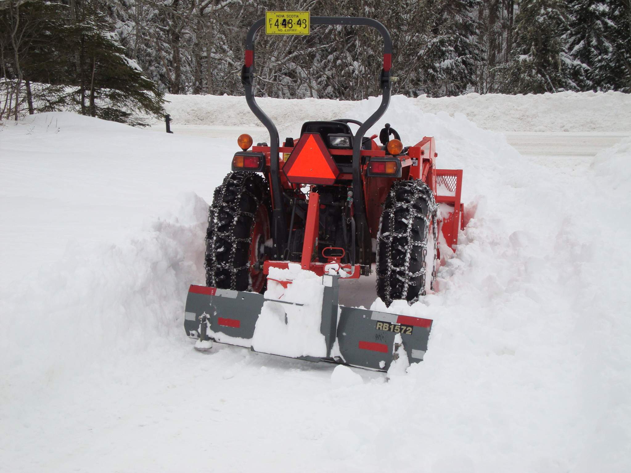

Your tractor is about the same size as mine, unless you have one **** of a hill you won't need front chains. I can make do without if I really had to, but can't use the machine to it's full potential. I'd recommend getting them for the back first, then if you still have trouble look into chaining the front if you can. Also there are chains, then there are better chains.. I got these from my Kubota dealer, made by Tellefsdal. Smooth running good quality chain with great traction. They're hard on paved surfaces though if you spin them.
Sean
