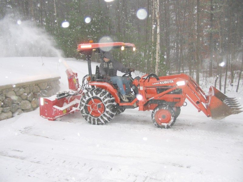

Where are you located?
What type of tires do you have?
2-link ladder chains are a good choice for snow and mud.
Tire Chains .com are a good place to buy. There are many satisfied customer here. Just be sure to order the heavy duty expanders.
Here are 2-link ladder chains on a B2710 with R4's. They work well in the snow and mud.

The four link ladder chains ride rather roughly especially on smaller tires.
I added diagonals to my four ladder chains so that they could be used on hard surfaces.
Pete and others have answered all your questions on chains.
Choose according to your situation.
