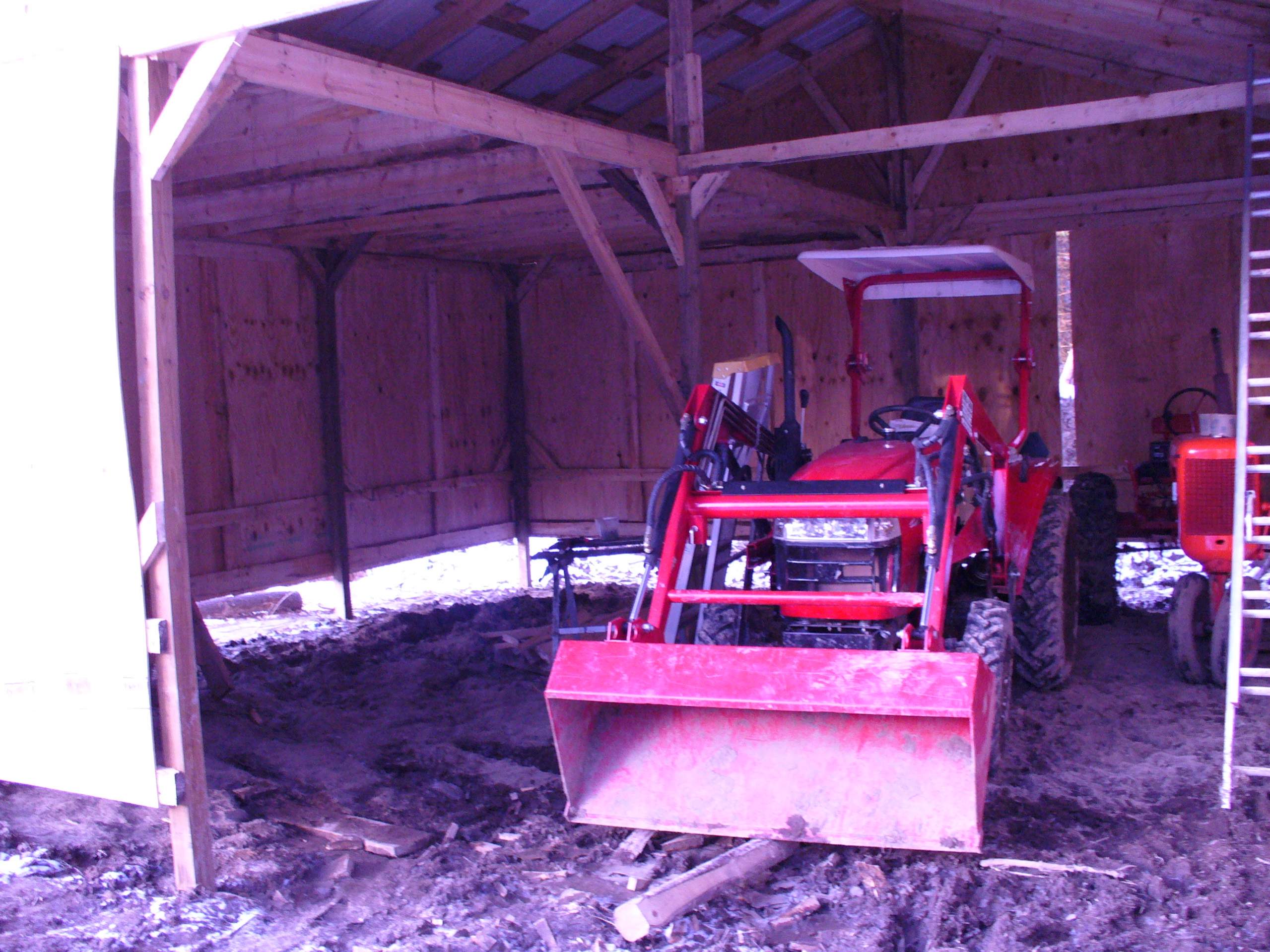

Are you going to put the post in the ground or just build above? I have built both ways, here is a picture of the start of one if my garages. I don't have pictures of the other. On the one NOT shown I just leveled the ground built the walls and raised them then supported it and finished. I built both of mine for under $2,000.00 each{I have my own mill}

i was thinking above ground,we grow rocks so digging is going to be easy.i have the ins. coming thur. also i need to get ahold of the building inspector to see what code
