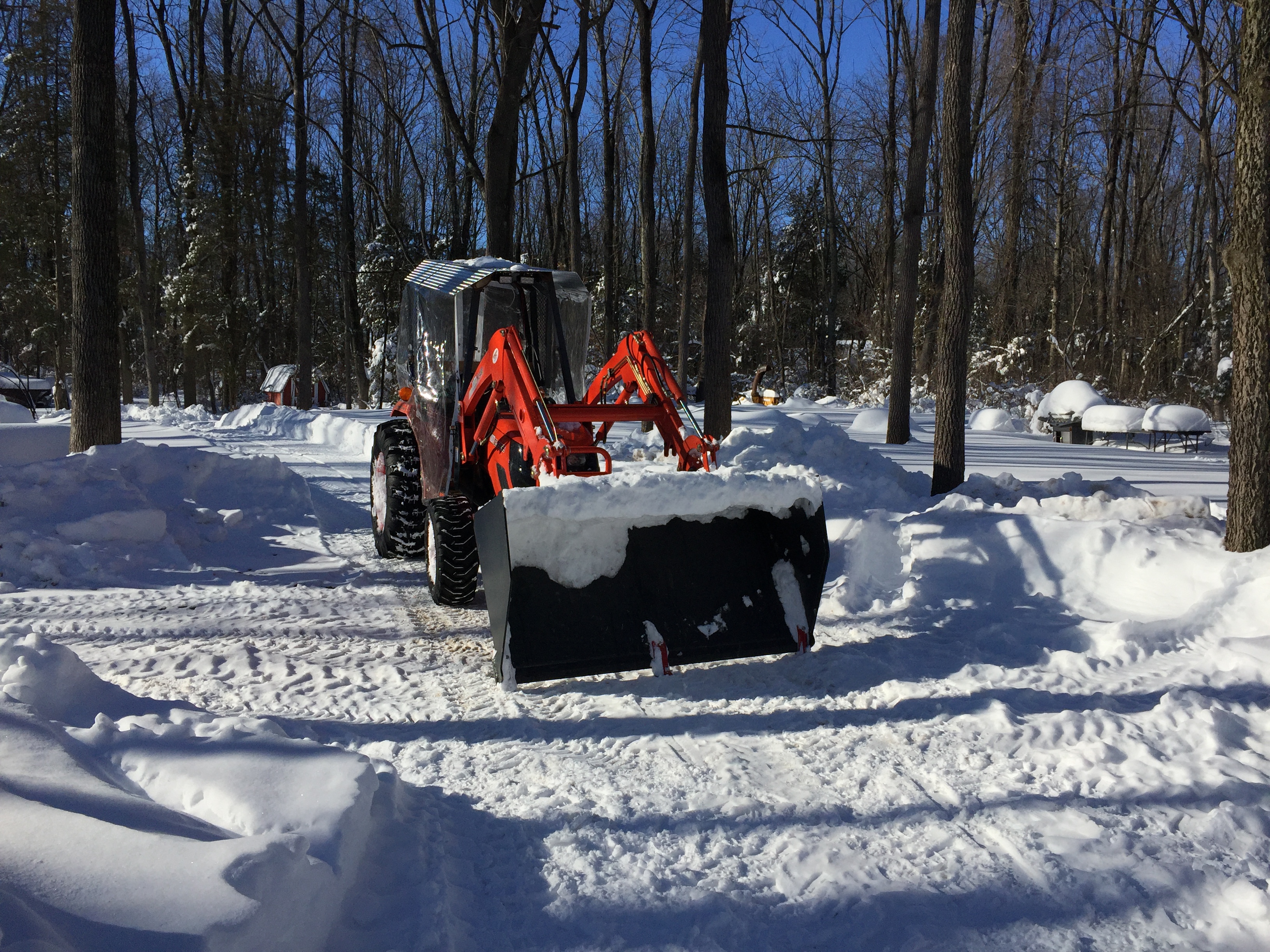

Whether you realize it or not, you are wearing the bottom of the bucket, making it thinner over time. Having a sacrificial replaceable edge allows you to wear it out and then replace it rather than eventually having to replace your entire bucket. Since tractors move slowly, the wear will be much less than say on a plow on a pickup which plows at a much faster speed. There is also wear on the driveway itself. Using a wood or plastic PVC wear bar, as suggested by others will save wear and tear on your cement or asphalt driveway.

Probably an odd question, but what are the downsides to not using anything? I've just been using my loader bucket edge for the last 4 or 5 years on a paved driveway with no ill effects. I haven't really noticed any wear on the bucket edge or damage to the pavement...
My driveway has a decent grade from side to side to help move the water that comes off a hill. The bucket doesn't always land flat on the driveway, so I have some decent gouges in the pavement where one corner of the bucket caught the high side. Since then I've used some type of edge protection.

how do you keep it on? just friction?
Yes, just friction. I use a short scrap of 2 x 4 and a 3 lb. hammer to install it. I usually have a couple extra pieces cut as spares but I haven't needed to use one during the season. I should say I use a 3 pt snow blower to remove the snow and then float the bucket for the trip back up the driveway to clean up the edges. This works for me in my situation but your results may be different.

Another pipe on FEL question.. when cutting it on a table saw - what type of blade is best? do you have to use a slower speed (i just got a shopsmith which is variable speed) so it doent melt/get too hot and stick to the blade?

Any carbide tipped wood blade will cut pvc or abs easily. I don't think you'll see any melting. I mounted the pipe to a 2x4 to run along the fence as a little insurance against rotating the pipe while I was feeding it.

Nothing special just a carbide tipped rip blade.

If the PVC breaks and goes through the snow blower, you will probably find out it was a bad idea. (Plastic gets brittle in frigid weather).
I have a steel pipe, with tabs welded on it to bolt it on, mounted on my plow. I would go that route.
It works very well, on my 325' of gravel drive, once I have packed down some snow.

I use something called edge tamers. They are like little skis that you clamp on the edge of your bucket. I do a lot of snow removal on both gravel and asphalt and these work well on both. I used to use PVC but like others, kept breaking the pipes. If I need to scrape ice off the driveway, they come off in seconds with a ratchet. But I've learned to only scrape where I know the asphalt is completely flat and smooth - catch a crack in the asphalt and it rips up really easily.
I'd rate the edge tamers a "recommend" especially if your also doing any gravel areas.
