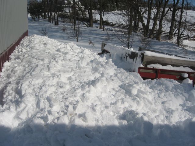

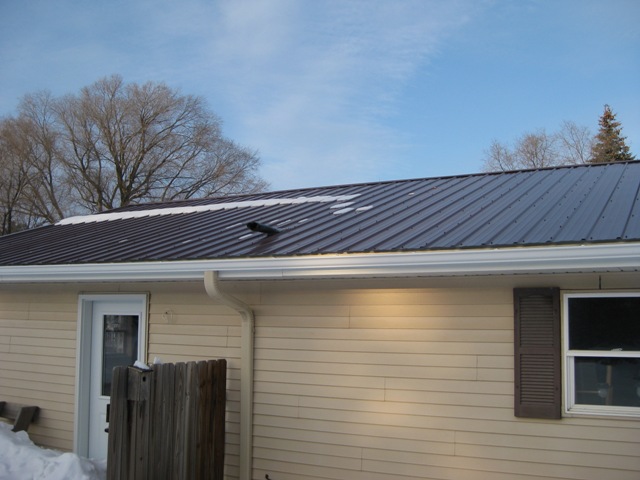

Here is what sliding snow can do. I had 2-3 feet of snow on this roof. That was up until Christmas when we got 37 degrees and rain. The whole mass let go all at once and the flue pipe for the furnace was no match. It is/was double wall, 4" pipe. It bent it over right at roof level and flattened it. Took the storm collar and cap right off. So much for heat in my garage this winter.
