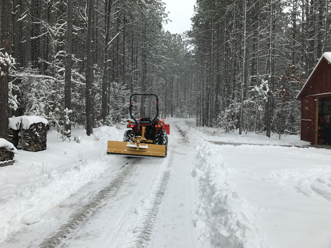

This is the first winter with my new tractor and I thought with the bucket and 3 point snow blower, moving snow around my yard was going to be a lot easier than with my quad. I thought wrong. I actually got out the quad and blade out to finish it off. Needless to say I am extremely disappointed. This was a 6 snow fall and it needed removing. The first few snows this year I just packed to get a good frozen base over the gravel driveway. So It was frustrating when the bucket would penetrate through the frozen layer and dig up the gravel underneath, even while in the float position. I tried adjusting the angle of the cutting edge but it either dug in or left to much snow. The rear mounted snow blower was a completely different ballgame. Let me just start of say that driving backwards with a bad back really sucks and is not fun at all. Not to mention even the slightest bit of wind completely covered me in snow. I had the skid pads adjusted fairly low and then adjusted my top link to give me the desired space between the blower cutting edge and the hard pack. There was a really fine line between to much space and not enough. I was either shooting rocks or leaving to much snow behind. I think that the blower would work better with deeper snow and paved driveway. We seldom get a bigger dump that 6 at a time. My quad blade does a much better job than my tractor. At least right now. I am thinking of making some skids for my bucket that are angled up at the front and back to help float it better if the cutting edge is not at the perfect angle. As far as the snow blower goes, nothing will fix the driving backwards other than converting it to a front mount unit but that痴 more work than what it痴 worth. Personally I think the ultimate set up would be a dozer type blade that can be angled via the third function, for clearing the snow and the bucket for removing the plow row when it gets to big. What experiences have you guys had to deal with this type of issues

If you seldom get more than 6" at a time, a back blade would be a cheap snow tool to try out. That's what I use to do snow removal. Also, we don't know the total you get in a year, which makes some difference. The advantage of the blower is that it doesn't leave banks on the edges which will fill with drifted snow if you have enough snow around, and get wind. I'd suggest buying a used back blade. It doesn't need to be a nice heavy duty one, even a light duty one will move snow without any problems. You can use them either driving forward or backward. For amounts under 6" I pretty much always use mine angled off to the side, and driven forward. It's nice not having to look over your shoulder constantly like when you're driving backwards. A used one should be in the $300-500 range, and you can always sell it if you don't like it.

I really think it's somewhat of a myth that the front loader bucket in float is a good snow removal tool. Maybe better than nothing at all, but in my experience it's a poor way to clear snow. You will get slightly improved results if you put a pipe over the cutting edge, but the main trick is adjusting the bucket angle with curl so that the heel of the bucket slides on the snow and the front edge (pipe or not) scrapes 1-2" above the surface.
If you have a really big heavy bucket, it may simply have too much weight to be floating and you will have a hard time. My front bucket is heavy enough to back-drag crusher run gravel in float and get it spread smooth, so it's no wonder it's not real cooperative in snow.
For me, once I changed to a rear blade (also with pipe over the cutting edge), it was about a zillion times better than using the front bucket. Up to about 10", I can make a pass down each side of my driveway and I'm done. I normally don'y disturb the gravel at all.

For my rear blade it just sits below the cutting edge and doesn't need a slit. You can use a plasma cutter to slit the pipe if you want to slip it over the cutting edge. Welding shop can do it if you don't have a plasma cutter. In earlier versions I used PVC pipe and slit that on a table saw, but it wore out too fast.

Mark with chalkline, and cut with handheld jigsaw with metal cutting blade. Make sure the stroke is short enough to not hit the bottom. Pry apart with a couple of screwdrivers if need be to get it slipped on the blade.
