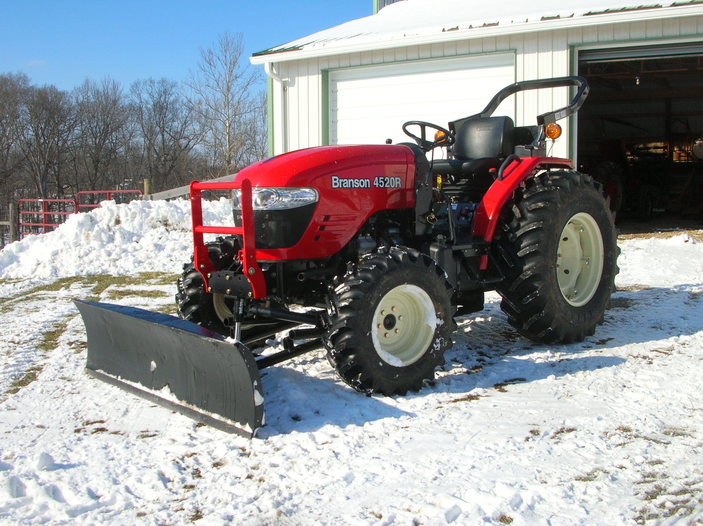

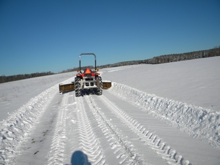

And here is another home made and handy front blade that fits on the loader. it is on a 35 HP Century (Branson). The best blades are front mount as you can see what you are doing with out all of the turning. I can open the road easily in one trip then make two more passes to widen it slightly. But since we do not get hard freezes here in Va i have to be careful not to dig too hard. The path opened is 11 ft wide. Front v plow.jpg Return back view.jpg

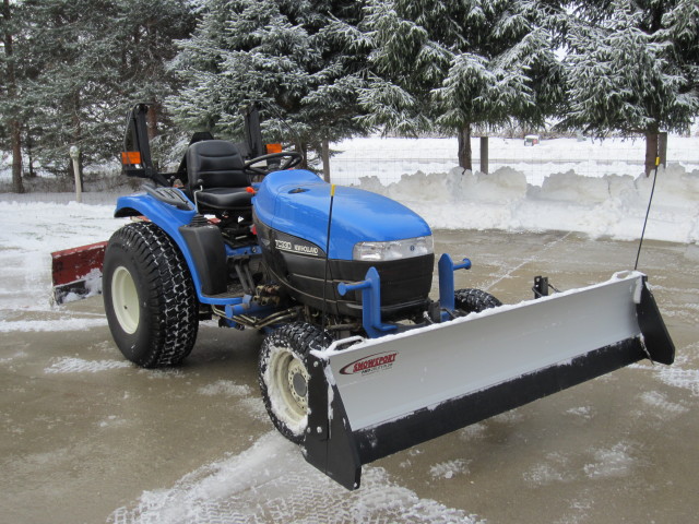

squ 003_1.JPGThis rubber edged Snowsport plow will fit anything with a 2" receiver. I installed a receiver on the front of the RTV and tractor so I have a choice of vehicles. It is fast, durable, and doesn't dig in gravel or grass.

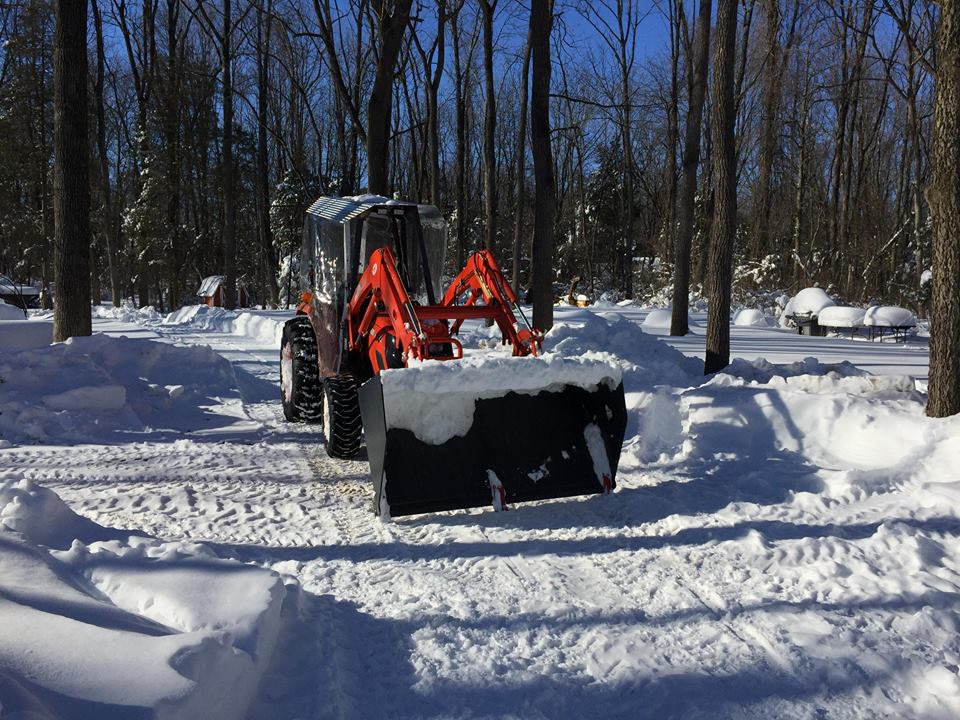

I have a gravel driveway in southeast PA so it's constantly thawing in the winter. Agree with others that in all but the biggest snows, a hydraulic angle front blade is best. However, in the big ones I'll take a snow bucket over anything else. To keep it simple, I use a 6ft wide 42" deep bucket with four edge tamers with FEL in float. This works in any snow worth moving and only digs in if I get off the driveway into the mud. When it gets really soft in the spring I put a little PVC pip between each edge tamer. This doesn't wear much because it only has pressure on it if the edge tamers start to sink. This way I can always be looking forwards and push snow as fast as I want with no fear of the bucket digging in. I can also plow the back yard so that my kids can play soccer and it doesn't tear up the grass at all ! :) (picture only shows 3 edge tamers, got a forth for more floatation)

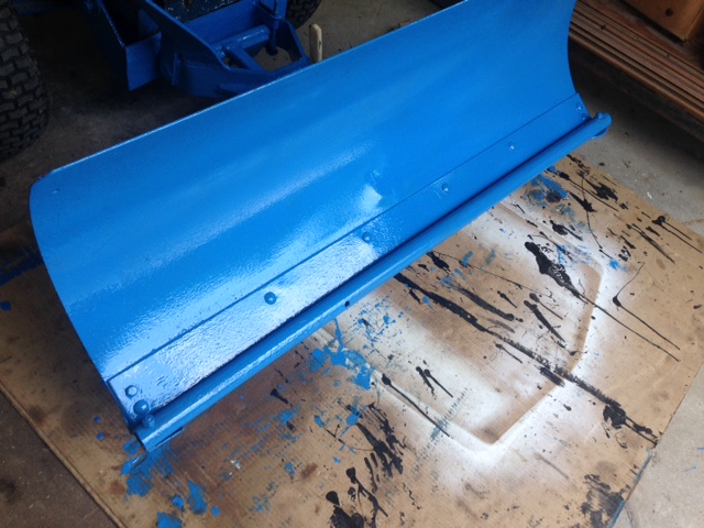

On my 44" blade, it has a couple of float tabs on the outside edges, still dug into the gravel if not frozen yet. I just drilled a couple of holes in them and up through a piece of pipe. Bolted with a couple of carriage bolts. Only had one snowfall so far, but seemed to work well.
