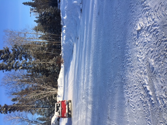

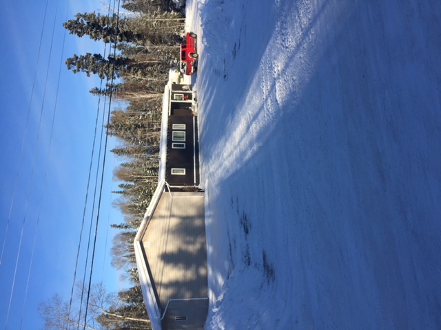

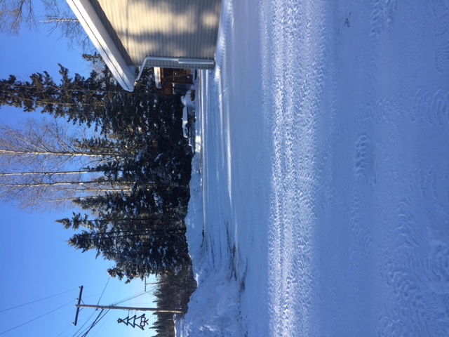

Just thought I would do a follow up on my DIY cutting edge tamer that I built for my tractor. It was the reason for this whole thread. It has been working amazing and I couldn't be happier with it. We have had about 2 plus feet of snow this year and I have been plowing quite regularly. I know that isn't much for some of the areas, some get that in one storm, but it's good for around here. I have tried to give my 3 PH blower an honest try but absolutley hate it. I can move more snow faster with the loader and I'm not covered with snow when I'm done. I just have short distances where I have to move the snow so the FEL works great. I literaly havent scooped one shovel full of snow this year. I love it. Heres some pictures of the great job the loader does with the DIY edge tamer.
EDIT:
Why do my pictures load sideways. When I expand them they are the right way but as thumbnails they are sideways. Would it have something to do with them being taken with my iphone?
