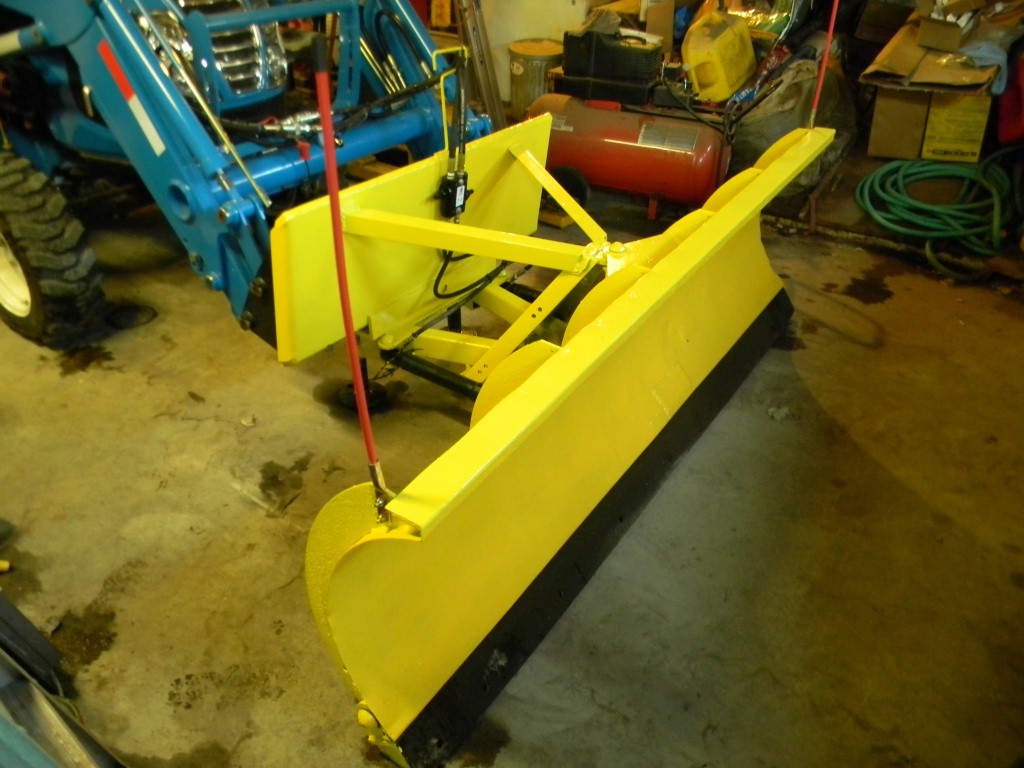

My first design was similar to the OP's drawing as a blade fixed to the QA plate with only the cutting edge that would trip.
It was easier to back drag with the fixed blade since I could use down pressure when pulling up to a garage door. Just the floating blade doesn't weigh enough to get through the hard packed snow for a better back drag. I have to figure a way to add something that will allow me to get down pressure on the blade using the curl function but still maintain the chain for a floating blade.
Here's my first design.
