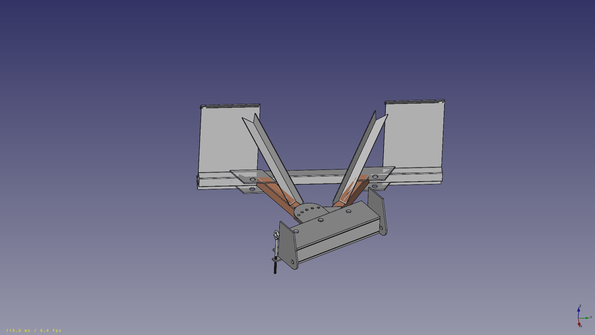

View attachment 535230 If you make it like this you don't need lift chains
Not fond of the design because lack of float other than via the loader arms. And the loader arms add ALOT of weight when trying to actually float....and most times don't work well as the tractor tried to drive up over the plow. Ever try to float your loader bucket going forward....same scenario.
So unless you are plowing a flat lot.....or like adjusting the loader constantly.....design it with a chain lift like a truck

LD1 I really appreciate your input! I had not idea what was the chain lift. I watched some videos, I think I can easy make it. Thanks!!!!
About a used one, I cannot find anything less than $600. I do not know if it worth it since I still have to make the ssqa plate, and some push plates to attach it. It will save me labor, and I will have a better product but....
For the mold board I have not access to a roller or a brake. I was thinking of making it 3 angle (the cutting edge, a flat surface, and a top lip). I mean its not ideal, but the tractor has enough friction to push that anyway.
Right now I am plowing with the bucket in float position. Anything better than that will make me happy. :)

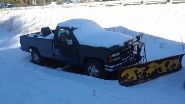

Email this guy on CL
Skid steer mount power angle fisher plow - $550 (Kensington NH00x0x_afItOJyac5d_600x450.jpg
   / Snow plow cylinder diagram? Cushion Valve? #37
Not ideal time to buy a plow, but still hard to fathom none locally under $600.
Gotta look for plow only. No pump or wiring.
Around here, about any week of the year you can find 4 or ,5 in the $200 range

Yeahh!!! $200 00Q0Q_3ty0i9TgUi7_600x450.jpg for the plow. So now I have to make some mounts and the ssqa plate. How about the cylinders, can I flush them to clear any contamination? I dont want to risk any damage to the tractor.
