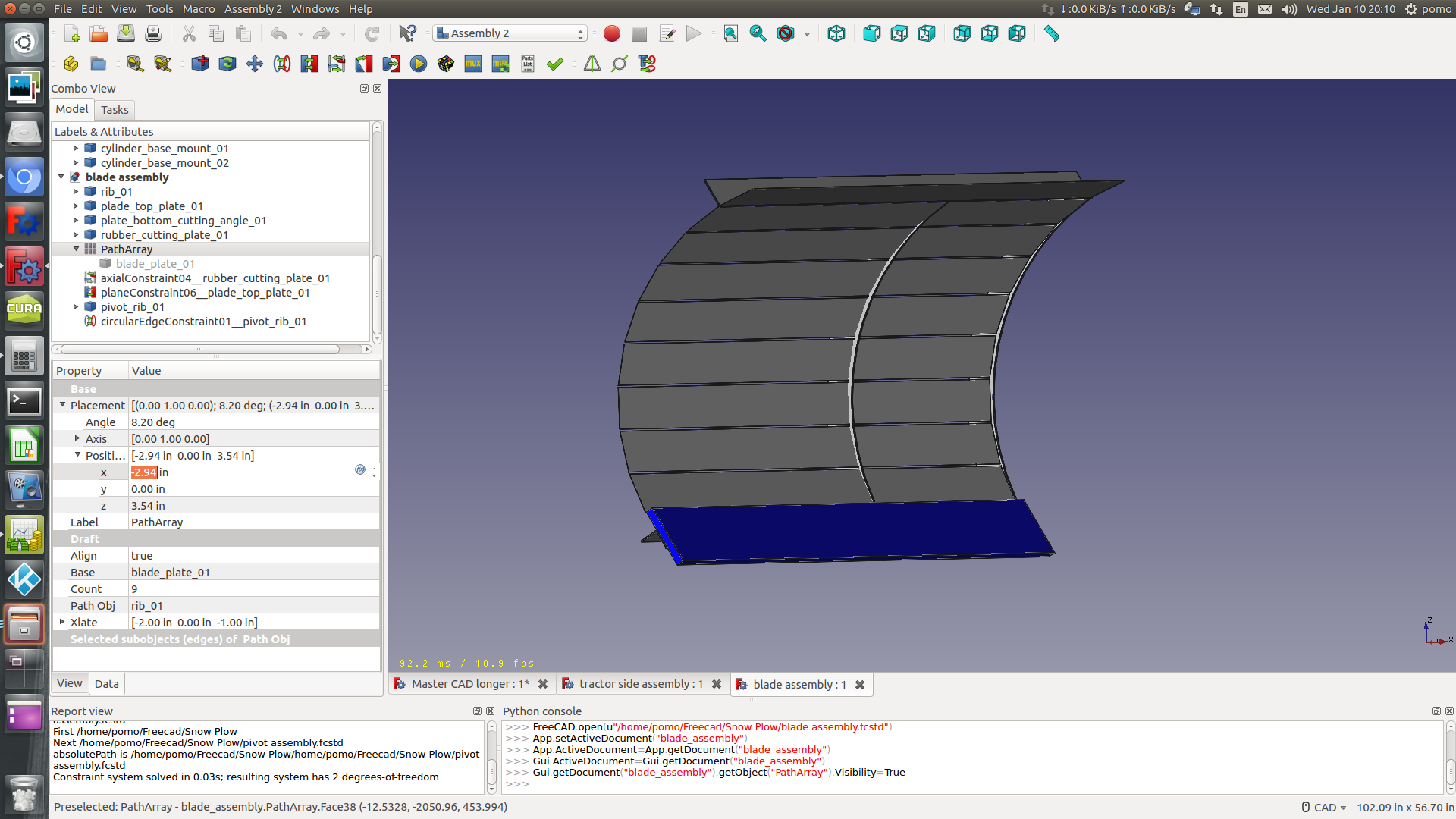

Thats crazy over build, not??? I am thinking that I could even use plywood!!! I am not talking for the cutting blade at the bottom, but the blade that "transfers" or "pushes" the snow to the front and side
   / Snow plow cylinder diagram? Cushion Valve? #22
The mold- board?
#23
The grey part
   / Snow plow cylinder diagram? Cushion Valve? #24
yes. Its not a big expence. I am almost done with the design. I am working the fine details of cylinders mounts. Btw, is 10gauge good enough for the push plate? like 1/8" thickness?
Not so much the expense, but building the moldboard, tripp assy, and "A" frame......
and for the push plate, you mean the big plate on the ssqa? I'd do at least 1/4". Most of the plate is meaningless (in between the loaders ssqa mech. as long as you transfer any (pushing) load not bearing in that area to those points. On a plow a good heavy channel would do, but then you'll need a "high" point to lift from (chain) and that substantial rotational force will need to be dealt with. Better go 3/8":laughing:

I will make post at the BIY forum with the complete design later on, not to use the hydralics forum for that. But for the ssqa I will use 1/4" yes with lots of bracing. The rotational force comes to play now that I am extending the plow further away for the 12" cylinder. I will check it out though, thanks!!

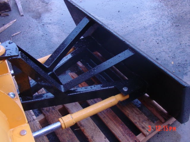

dsc08457_2.jpg If you make it like this you don't need lift chains
