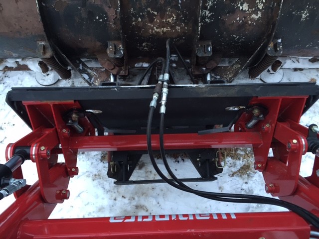

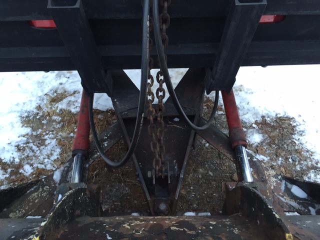

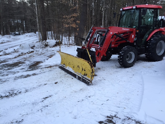

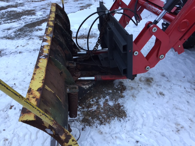

I managed to cut down on the overall length by several inches by cutting the A frame down, the only drawback is now I'll never be able to us it on my truck again..... but that is okay the truck is not far form going to the scrap yard.
As I said earlier I still have some fine tuning to do and then I'll clean it up and paint it.
   / Snow plow fabrication #63
Your tractor snowplow setup is a lot better then a plow truck all day long, nice.
