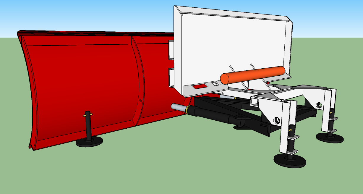

My next question is concerning the placement and angle of the SA cylinders, and that is. Is there any reason why I should not have my cylinders angled out were they connect to the mounting plate? on the current design and most all that I have seen where SA cylinders are used shows the cylinders a straight as in this illustration,
What I am considering is shortening the plow arms by about 1 foot, but to do that I would need to move the rear anchor point of the cylinders outward to compensate for the travel distance needed. I know I could just buy shorter cylinders but if a simple change in placement with save me a few bucks... why not.
Or you can do something like this.

I picked up the hydraulic hoses I needed to run my plow angle cylinders from the rear remotes. I wasn't expecting the $260 price for 2 20FT hoses, but its a far cry cheaper than a 3rd function kit.
I thought I had everything I needed until I saw Wild Bill's and 4Shorts design, I kinda like the idea of kicking the A-frame back under the mounting plate.

Rusty Iron, that design you have for the chain replacement is almost exactly what I had envisioned I would use.

Wild Bill do you have any pictures of the finished project? What did you use in place of the chain? Did you have to add any rear shoes to prevent the plow from tipping backward and dragging?
   / Snow plow fabrication #50
The last pics in my thread are where I am at.
I am going to still use a chain. If I curl the QA plate forward the plate will contact the A-frame on the plow. At that point I can put the loader in float and have some down pressure.
Rustyiron's design is a lot more robust than mine in the downpressure department. I could see where you could pretty much lift the front end of the tractor off the ground with his design. I don't think I really need to go there but I can see where some people might.
I am going to try running without shoes in the back at first and see how that goes. I dropped the pins in the back by 4 inches so the plow should have quite a bit of swing up and down. If I do need to add shoes back there I plan on doing something like this.
