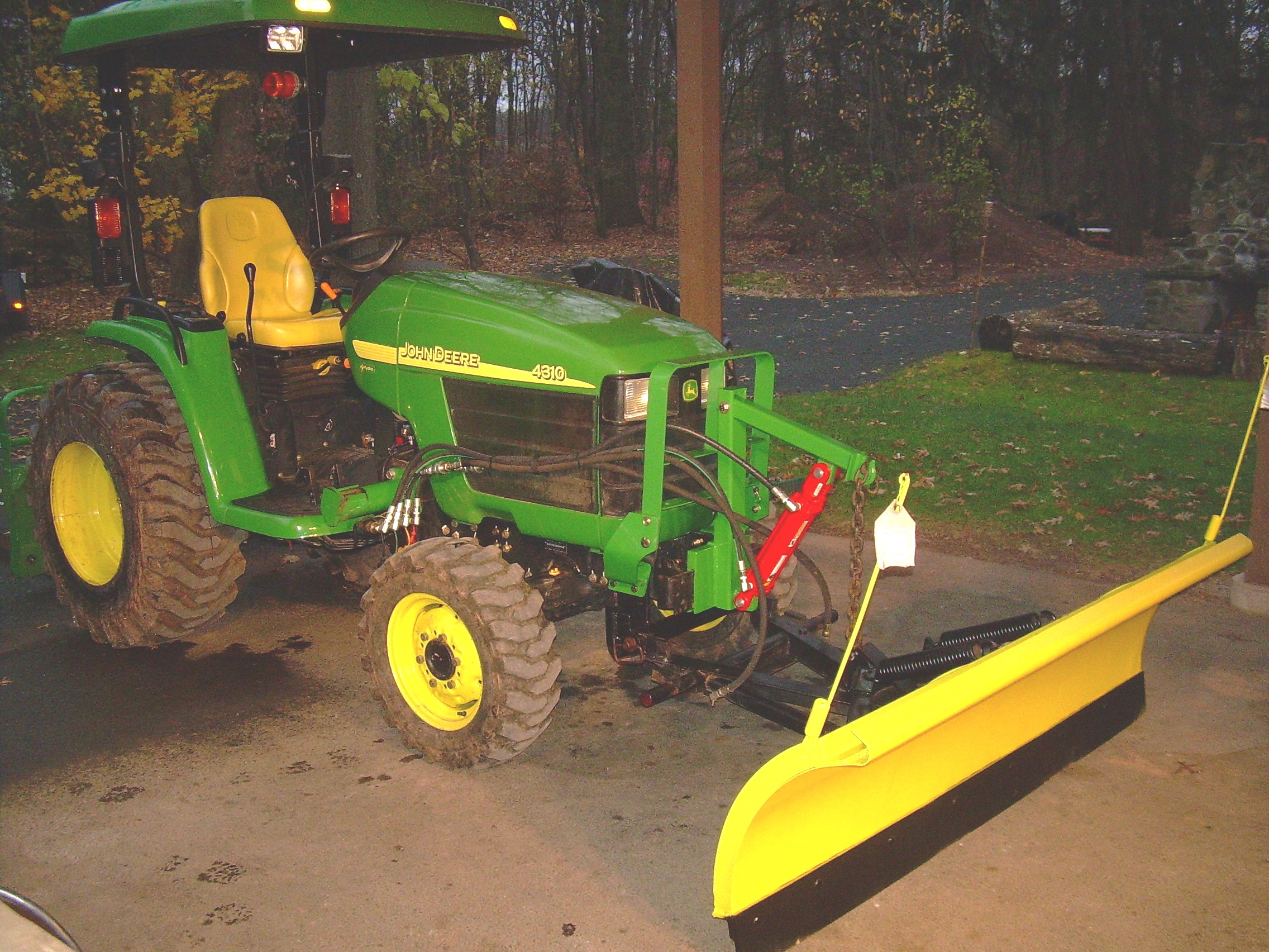

I started another thread about my snow plow project in the custom forum, that thread emphasized the loader being used to lift the plow.
This thread is about the frame mount and the front lift aspect.

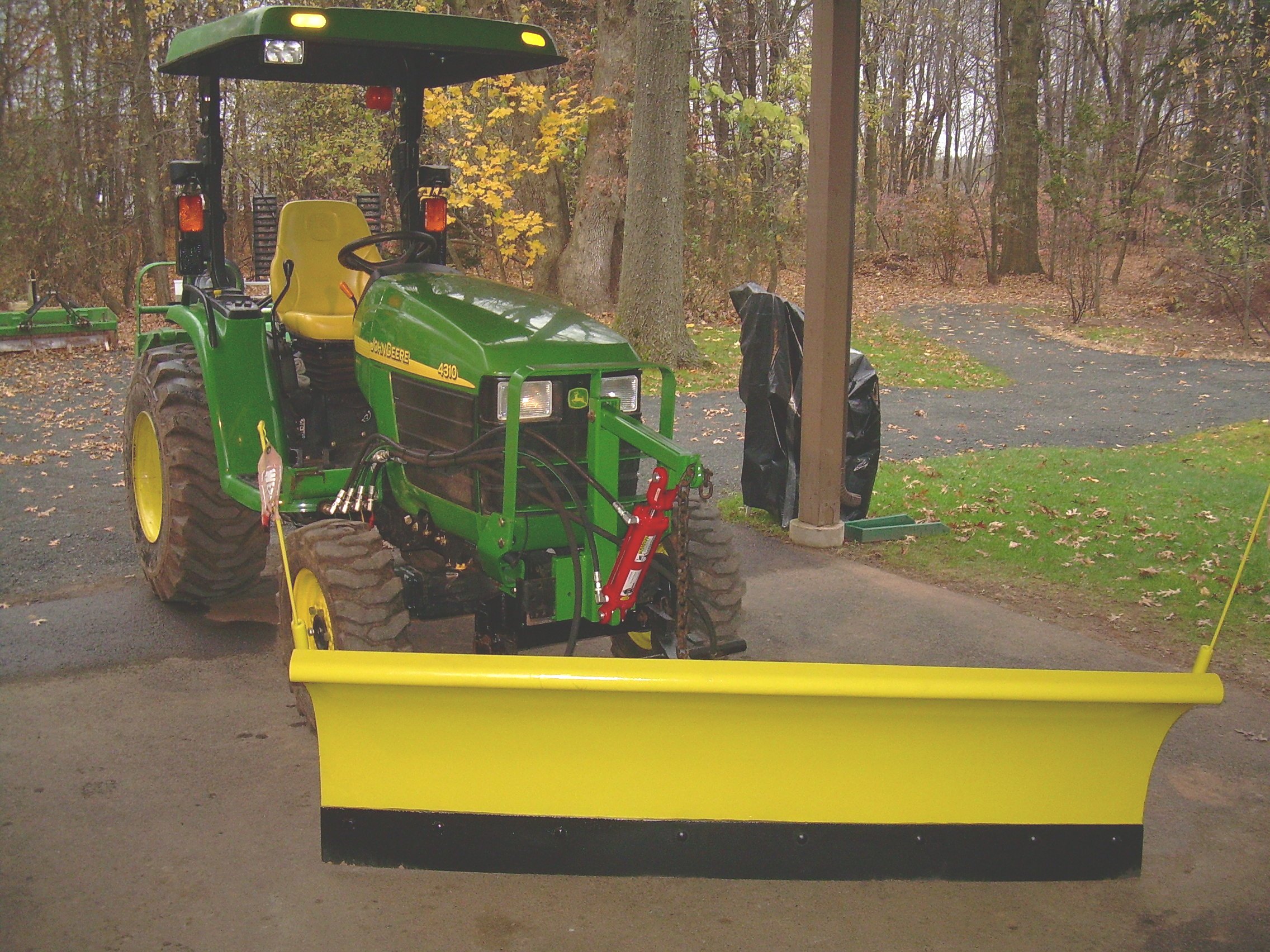

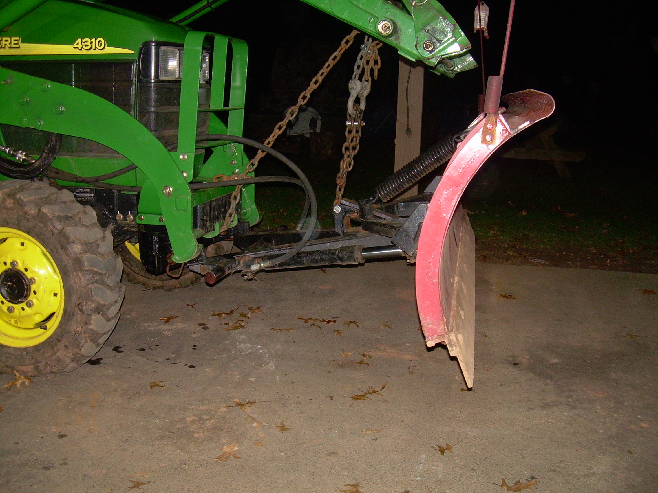

Once I got the frame mount and tried the plow on with the loader lift, I realized the plow fit the tractor nicely and would be great to have an independent lift frame mounted on the front.
Both parts of this project were fairly easy, just took a bit of head scratching to keep it simple but effective.

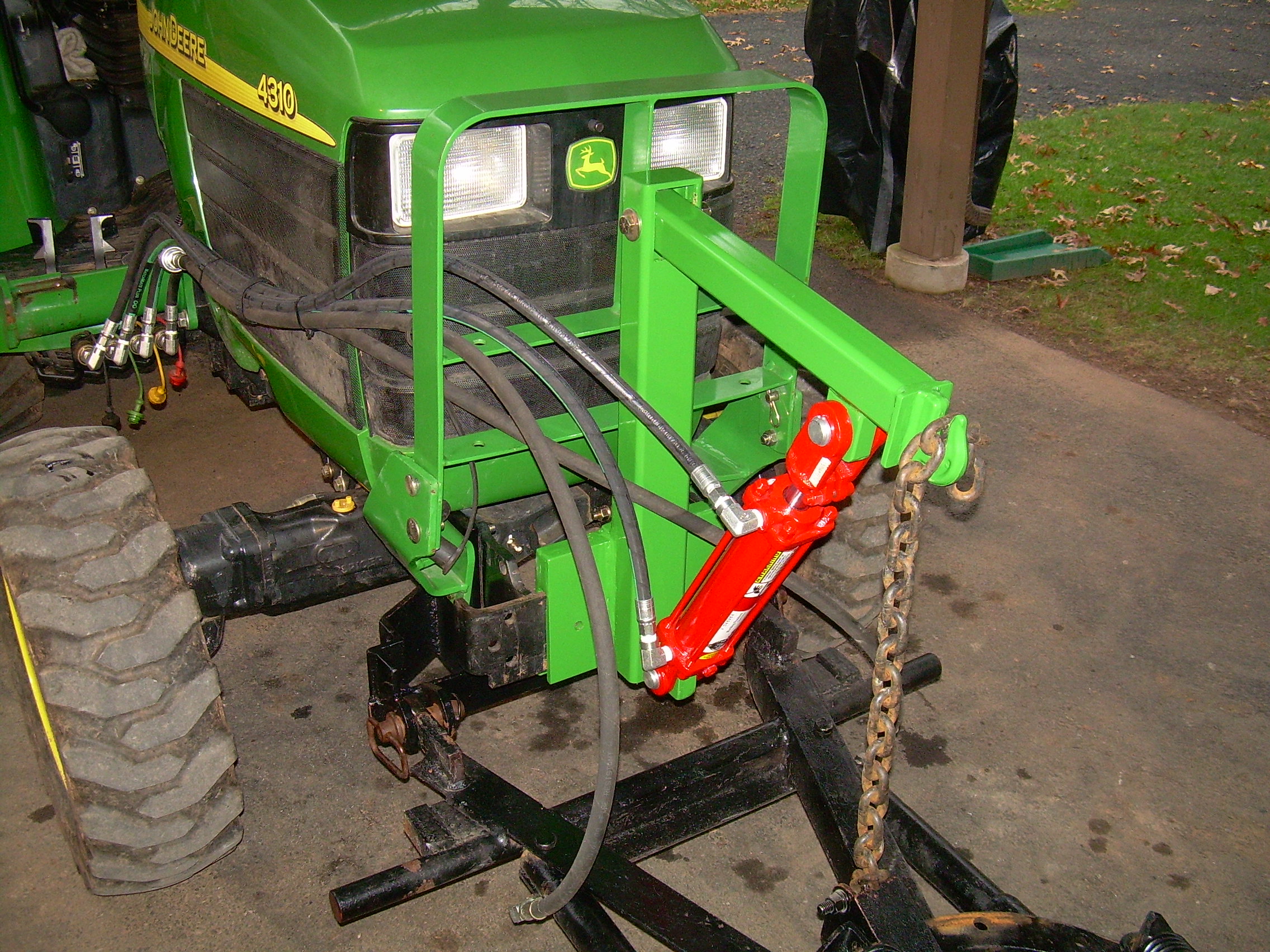

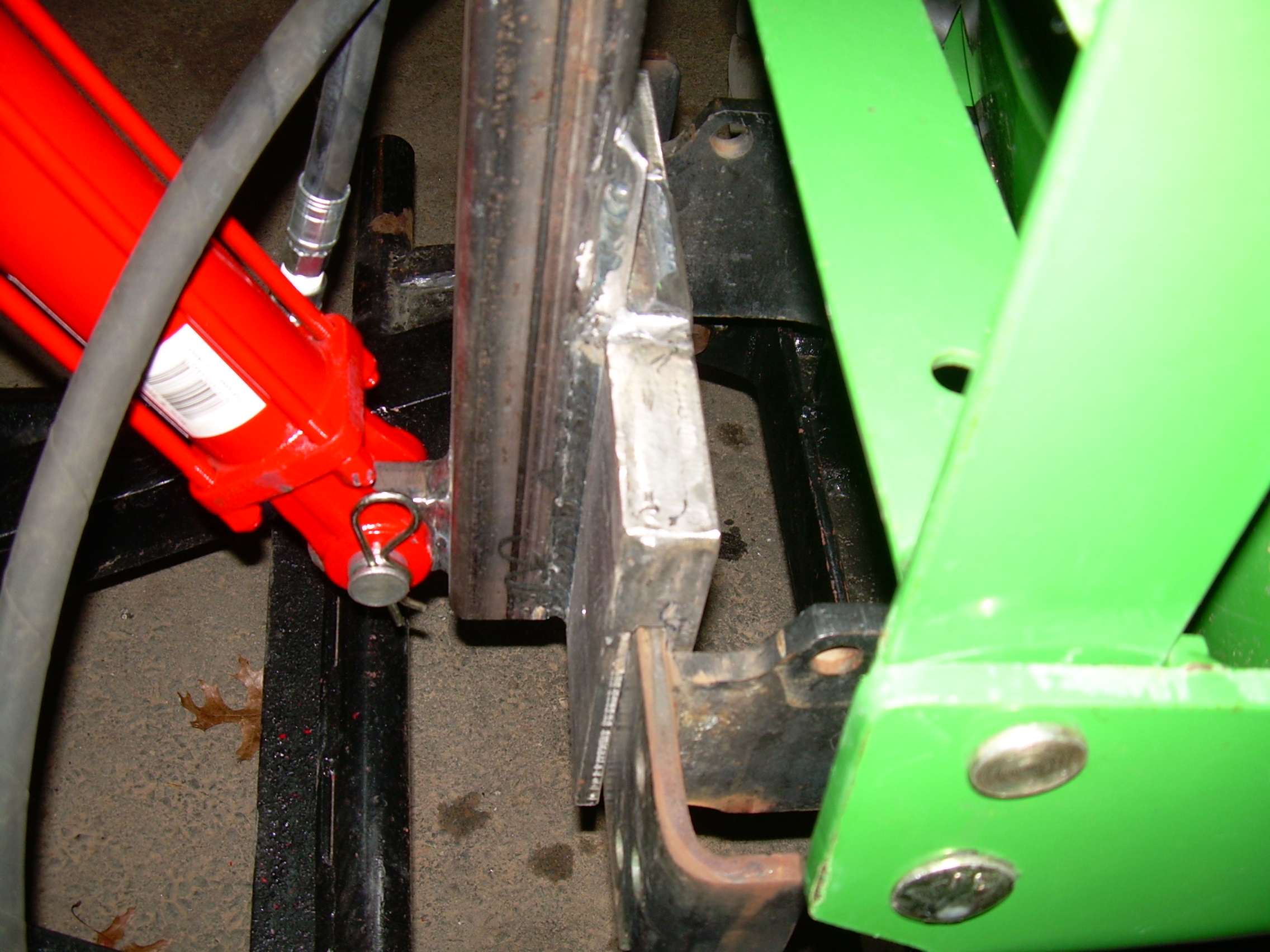

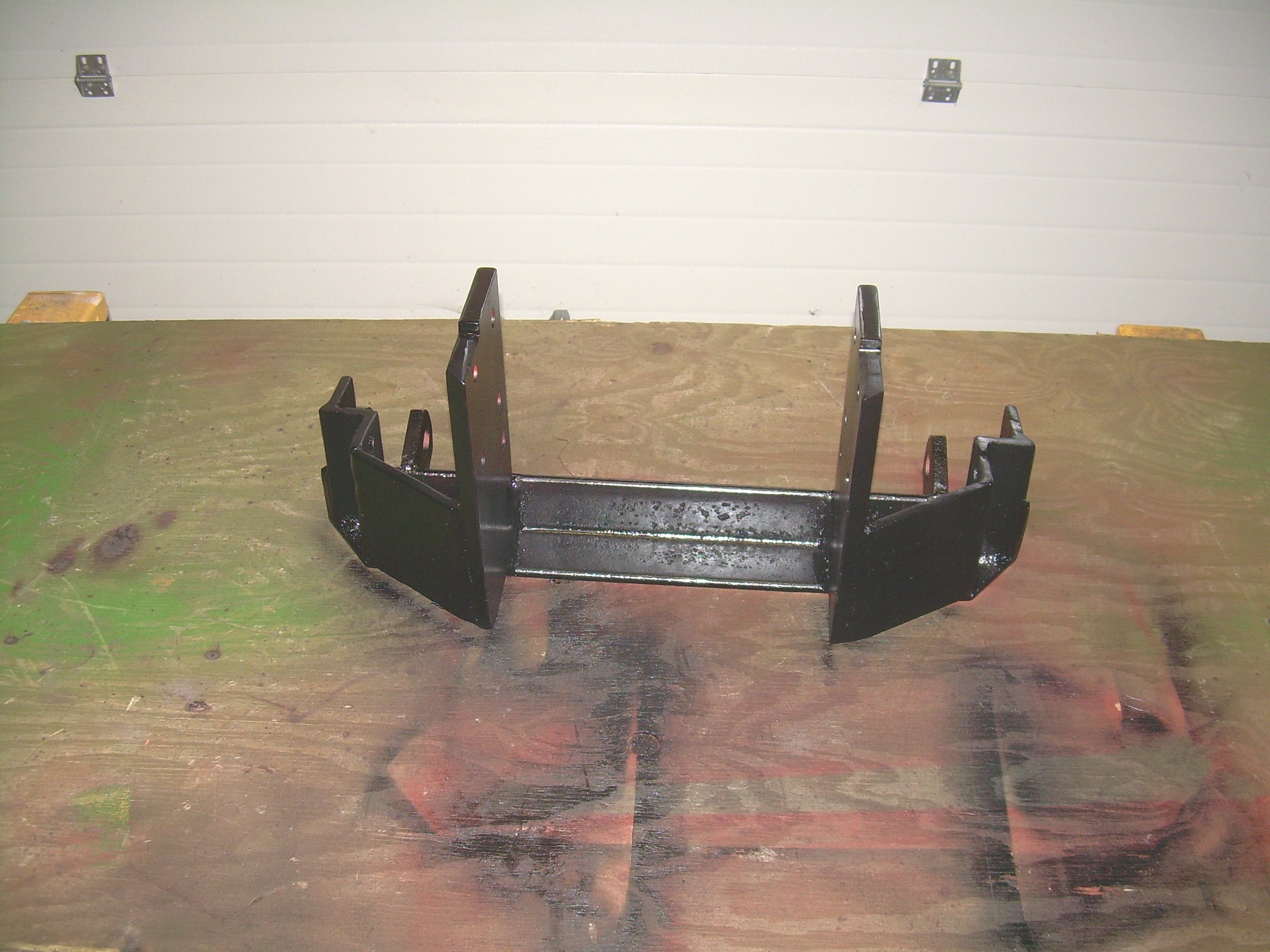

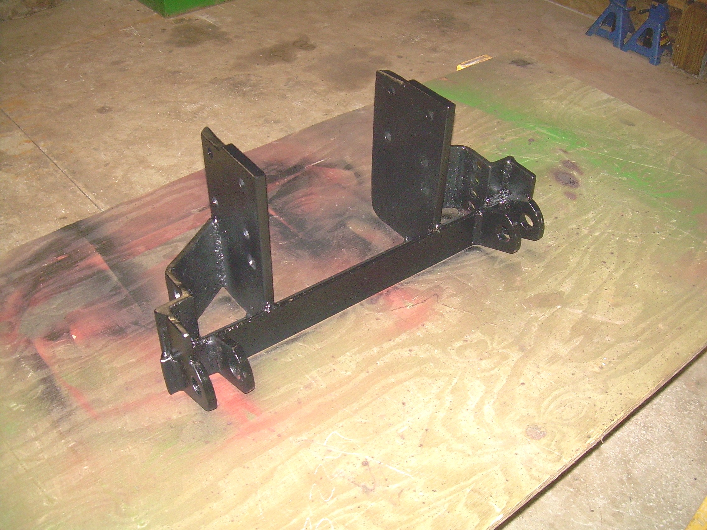

The sub frame is a compact stubby set up that is made up of the original truck part that the plow pinned to. Just welded it to 2 short 1/2" plates bolted to existing frame holes behind the grill guard brackets, there were spacers there already so that was to easy. The plates are fastened with 4 x1/2" G8 bolts in a 4" square pattern.
Reinforced the outer edges with 3/8 plate. I know it looks to simple, with no rearward braces like most sub-frames would have but I think it should OK, I may put a reinforcement pc across the back between the 2 down plates. The sub-frame can stay on as it doesn't interfere with anything including loader attachment.
I'm not new to snow plowing, I had plowed commercially for 20+ years. So I know the forces involved and how things can break, that's where I got most of my welding experience over the years. But this is a 32HP machine traveling at 5-10 MPH down a driveway not a 300 HP truck going 20-30 mph across a parking lot.

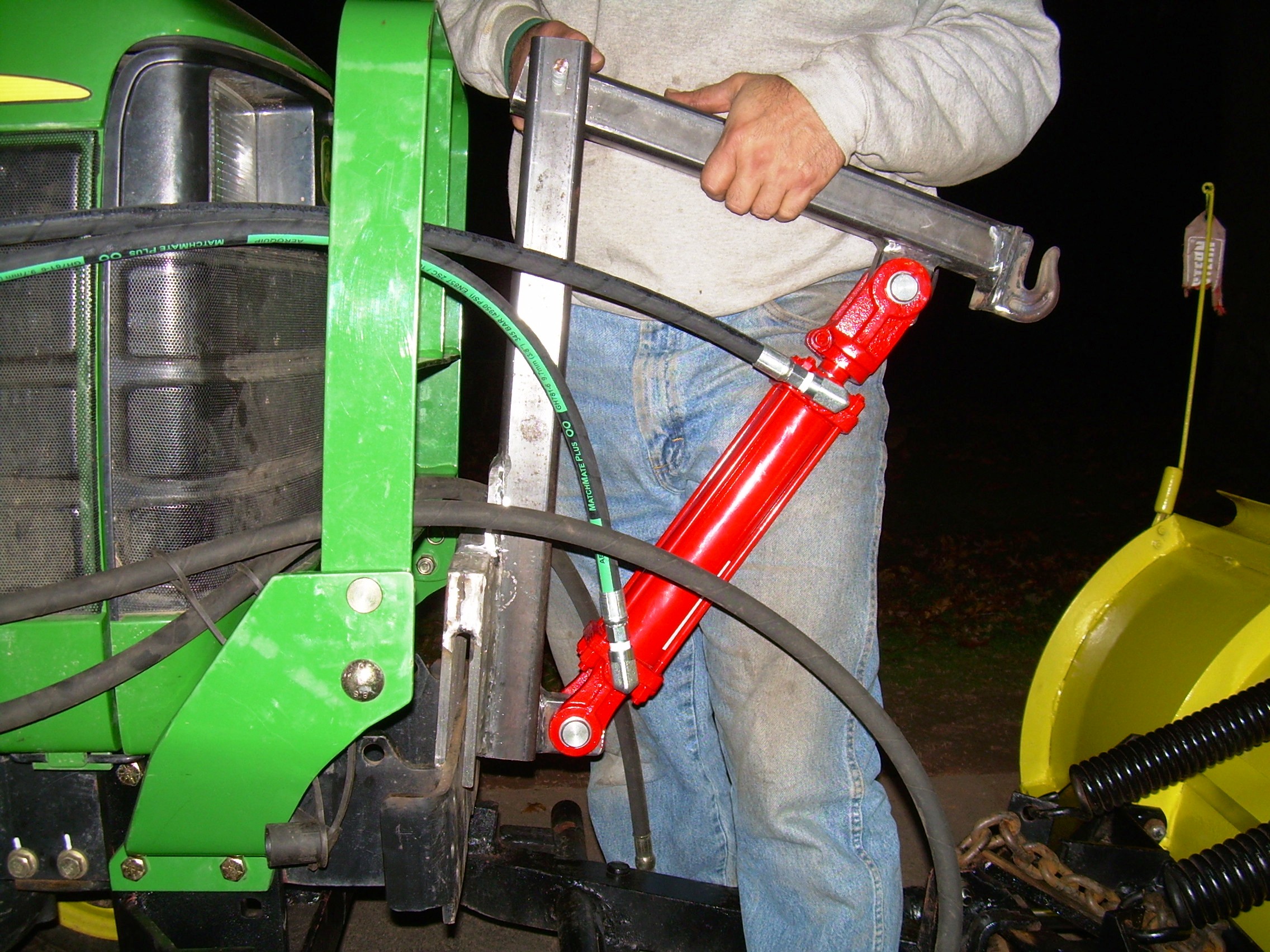

The lift assembly is also so simple I'm questioning it's ability to get the job done myself but appears to very sturdy with almost zero deflection of the components when plow is lifted. plus no tools needed!!! I put 2 holes in the mounting plates thru the weight bracket in case fasteners were needed but this thing doesn't move, even driving fast over rough terrain. of course using the loader valve for all functions.
Parts list; upright frame is a 2"x3"x1/4" tube, the lift arm is a 2x2 thick wall also, a couple of pcs of 3/8 plate, a TSC lift cylinder and a 1/2 bolt.

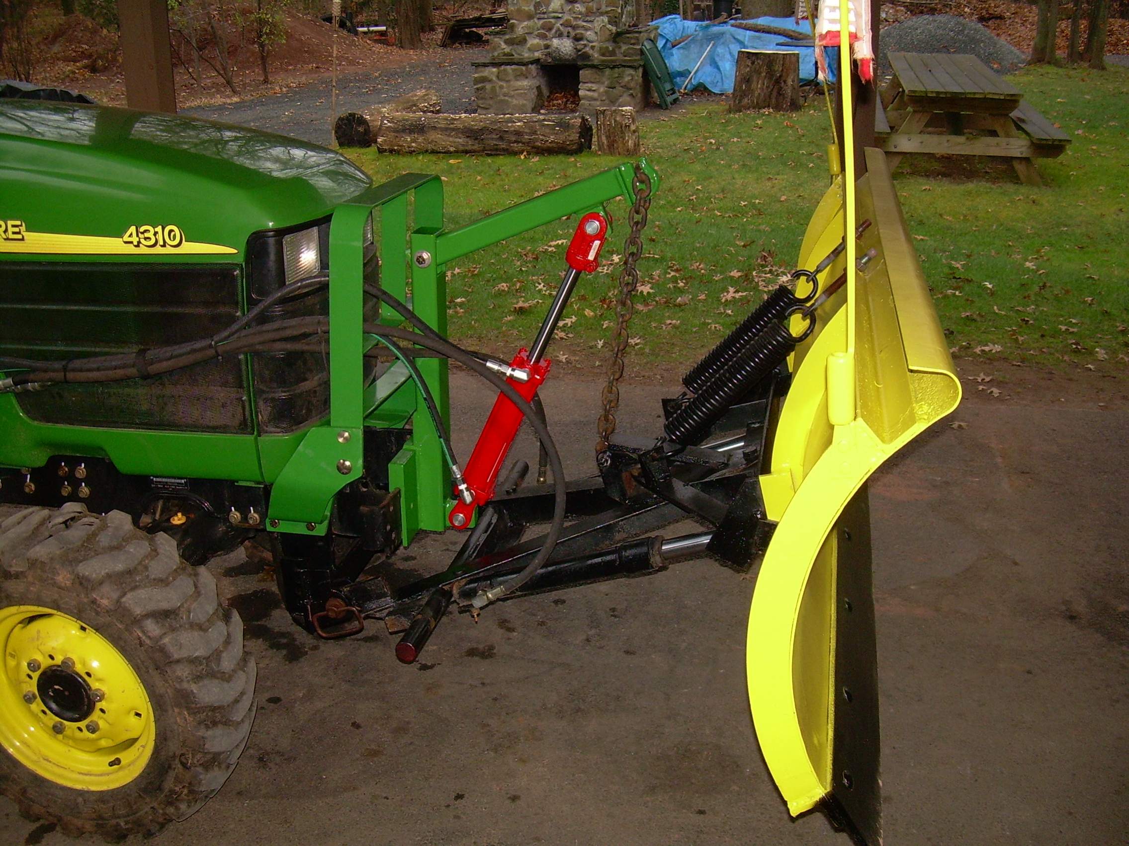

Some more pics,
Can go from the front loader to an independent front plow hook-up in the time it takes to swap 4 hydraulic lines, install 2 push pins and hang a chain on a grab hook. Hands will get a little dirty from the hyd fluid but no tools required!!!
Cost around $400. more than half of that just for Hydraulic lines and paint. had the plow already.
Don't be shy to point out any weakness's you see in this set-up, it can only help me to get it right before the snow flies.
Thanks, JB.

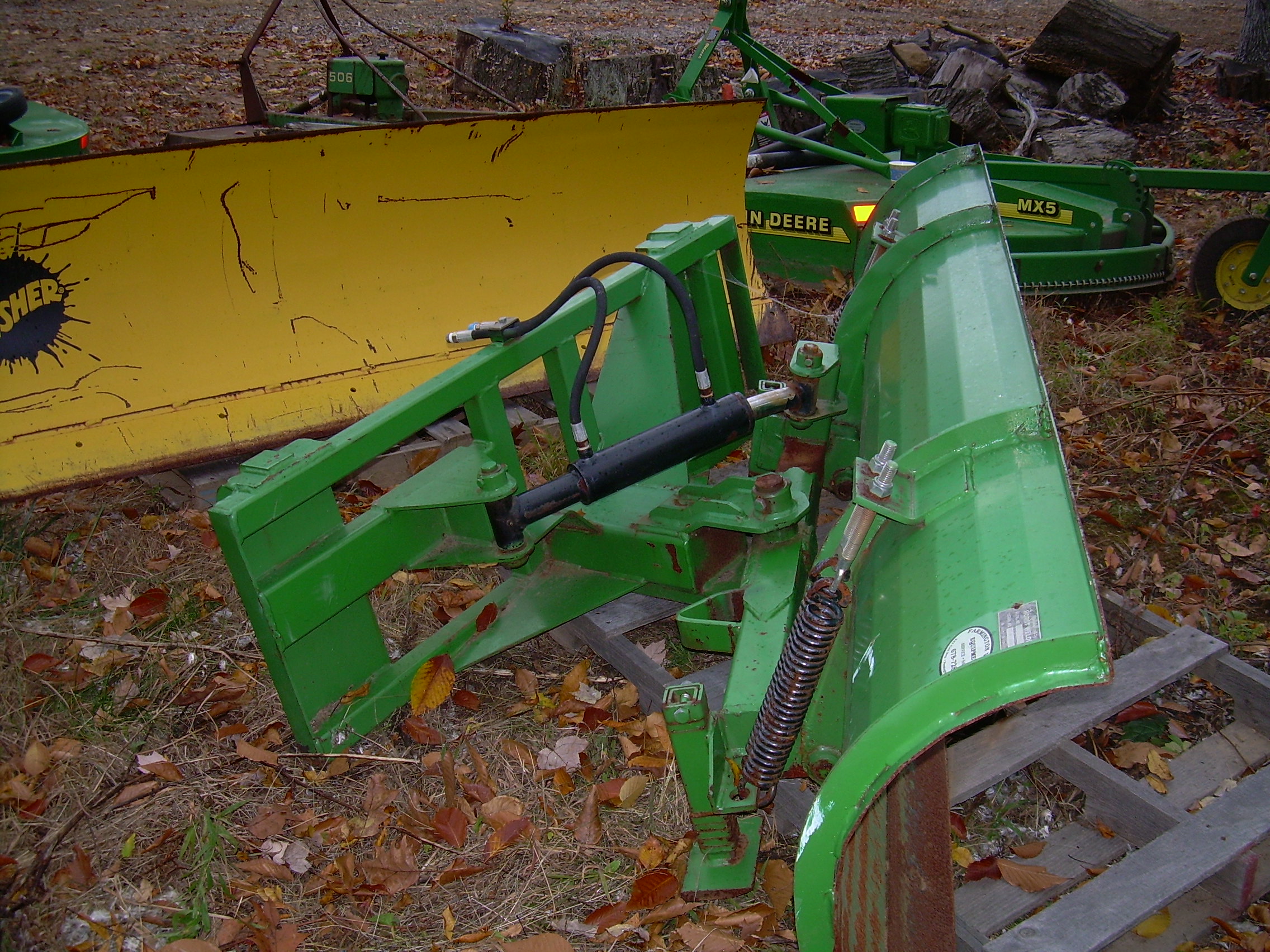

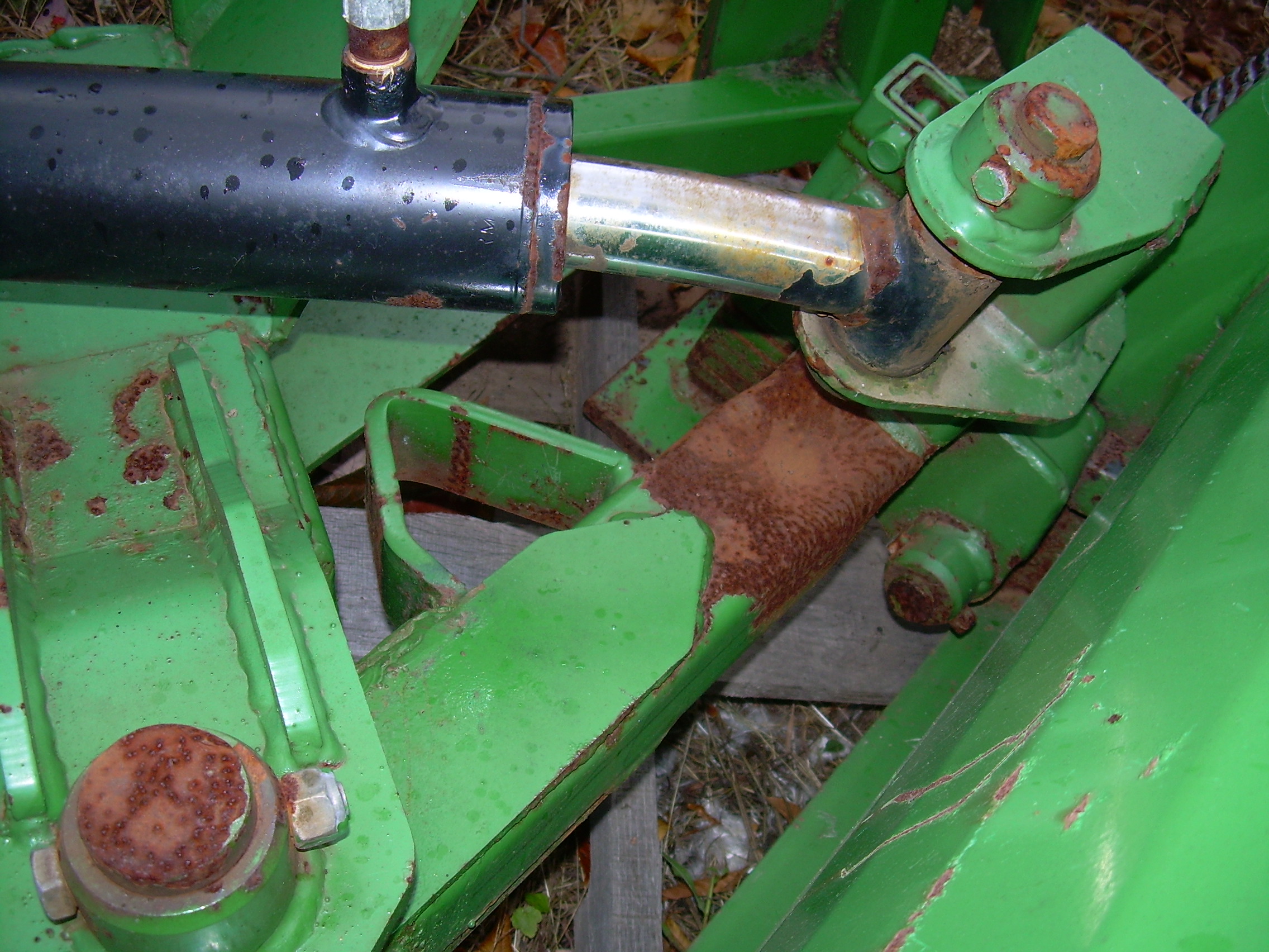

I've shown this pic before of a loader mounted plow that could of benefited from some relief!
JB.

I did not know they were called stacking stops. Learned the need for these the hard way!
I can't tell by your picture is there damage there? At first I thought your mast was bent but I see you made it curved.
I'm working on my stops right now it's gonna kill 3 birds with 1 stone, I'll post some pics when finished.
JB.
   / Snow plow, Frame mount, Front lift #8
JB.
No, damage was done 20 years ago when this plow and frame was on my JD650. I didn't know what I didn't know when I made the frame and blade 20 years ago, all was good until I ran the blade up high on a snow pile.
