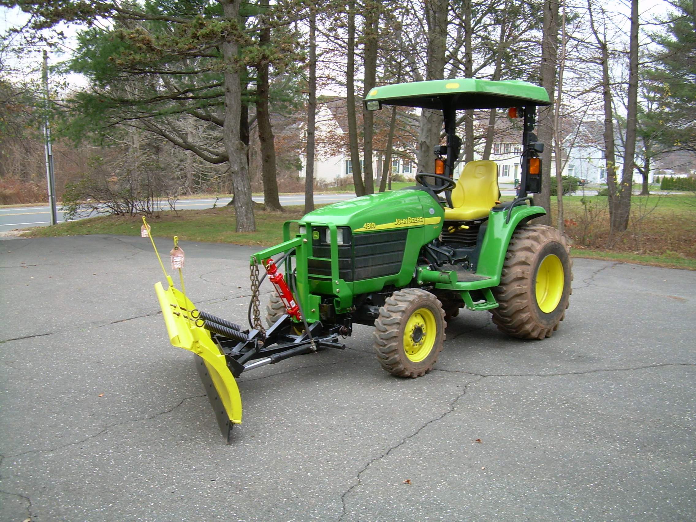

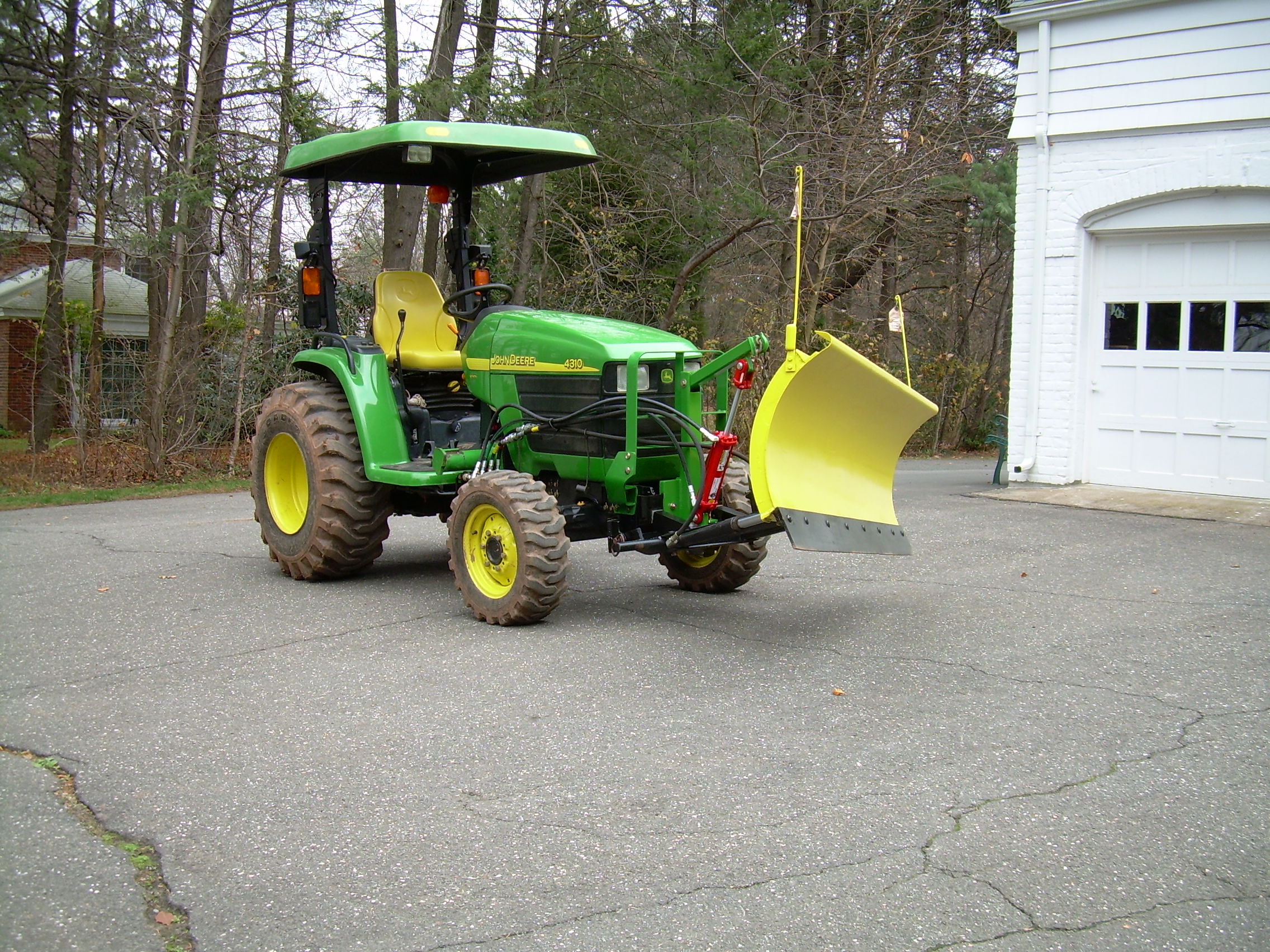

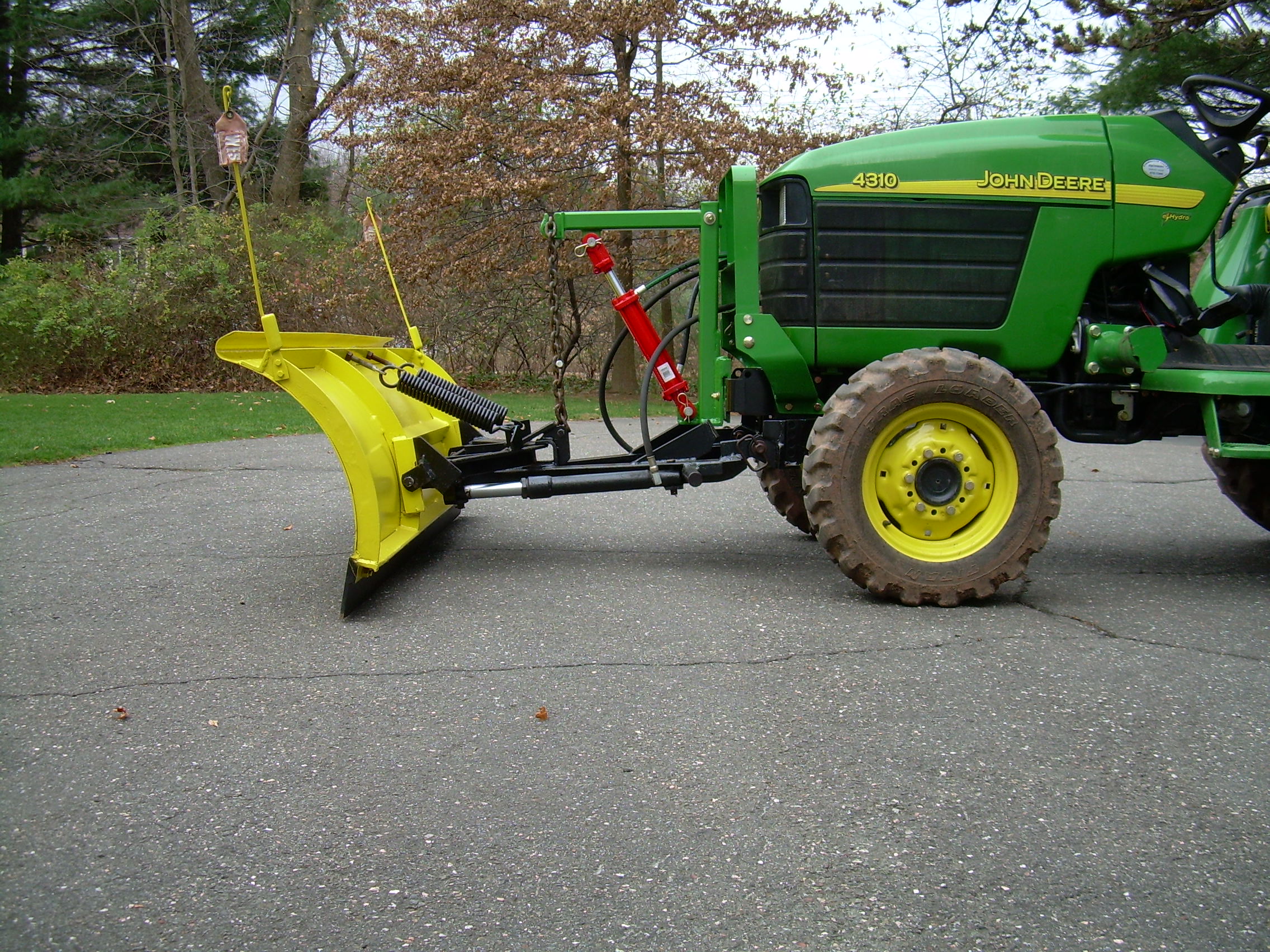

Just to update my own thread,
Going on second winter with this frame mounted plow.
Last year I was still working the bugs out, plus we had a mild winter so unable to really put it to the test. This year is the acid test we got 6 feet of snow in like a month!
I've had to push this thing to the max and it has out performed my expectations. No regrets and nothing has even gotten loose. Running out of space to plow snow to in parts of my small contractors yard. I will put the loader on after maybe one more storm just to move the piles up or out but the plow will go right back on.
Some pics included, I have some video but have to figure a way to share here.
JB.

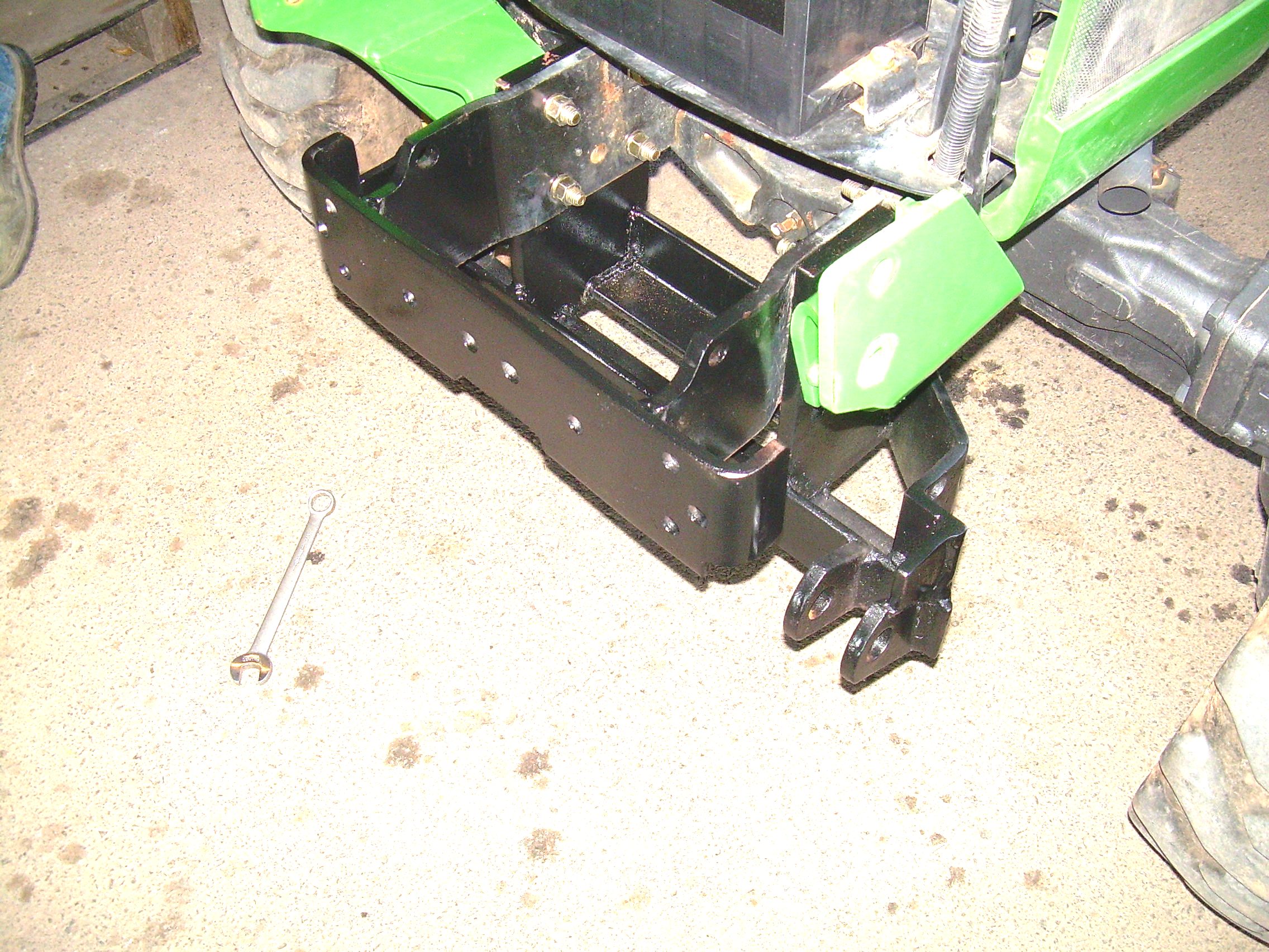

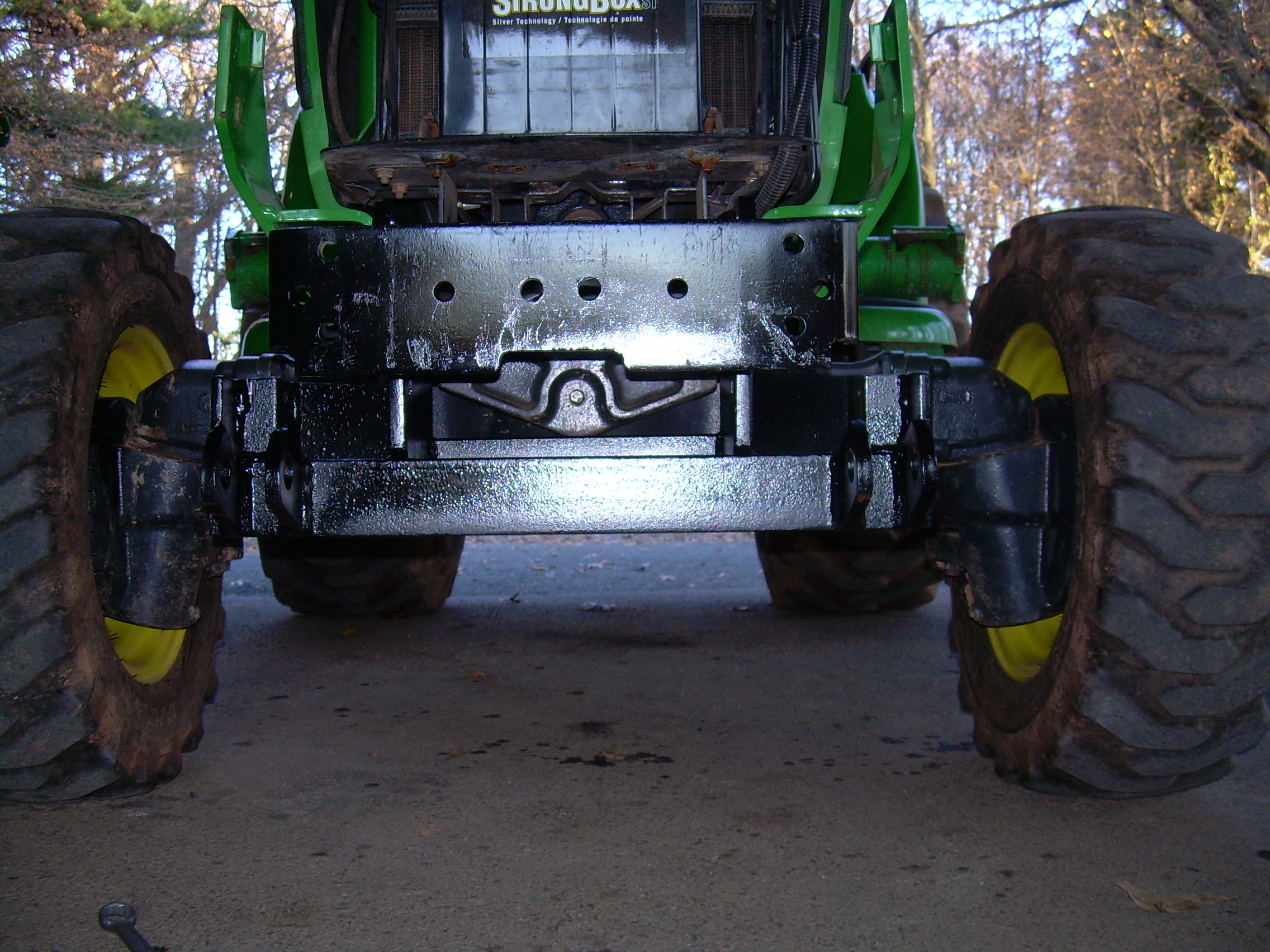

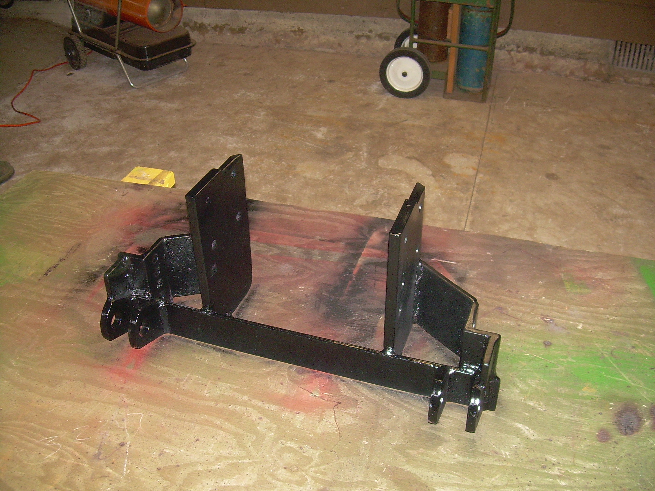

Thanks, it was stupidly simple, the way I did the lower mount frame, don't know why JD doesn't offer something like it. then anyone could mount a truck plow to frame.
The only frame mount plow they have for this model requires removal of loader mounts.
Using the loader stick for 4-way plow function is beautiful and natural.

The answer is yes, just once, but that was only when I pushed to far just fooling around for a photo op. The snow was soft half way up the pile and front wheels droped in. tried digging it out but ended up pulling it out easily with my truck.
The whole plow A-frame was hung up, my undercarriage frame stays on all year even with loader and does not hang down lower than axle so no problem yet with that.
JB.

   / Snow plow, Frame mount, Front lift #55
JB4310
Glad to see the working pics. I can confirm how much fun it is to have such a frame mount system.
I've yet to find a need to put the loader/bucket back on to move snow that the front blade can't move.
That pile you climbed up on could be moved bit by bit and shoved further back into the trees with the blade straight - - easily. :)
Now, add a wing plow for the ultimate in moving snow back further. :D If you are looking for something more to do. :)

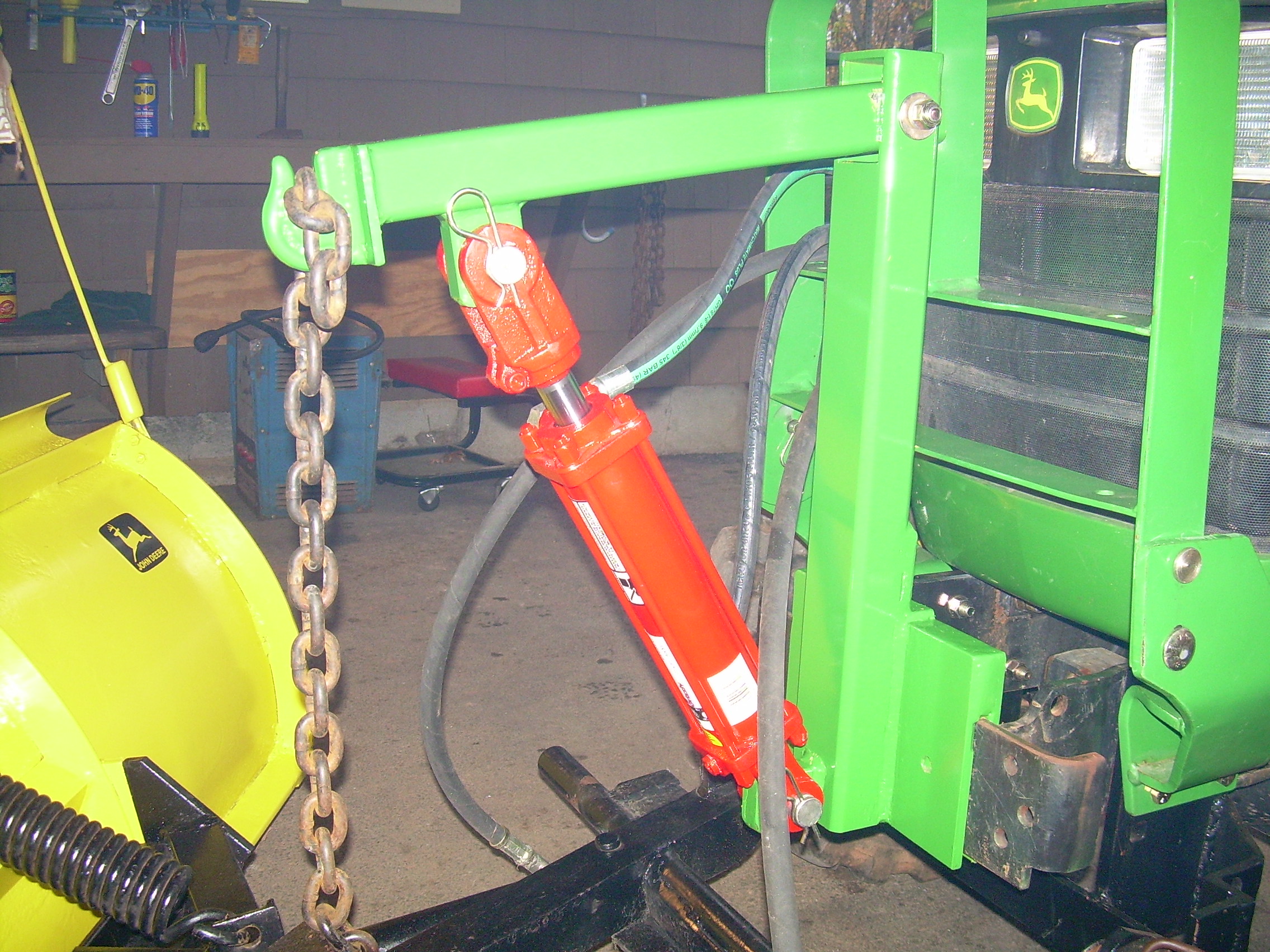

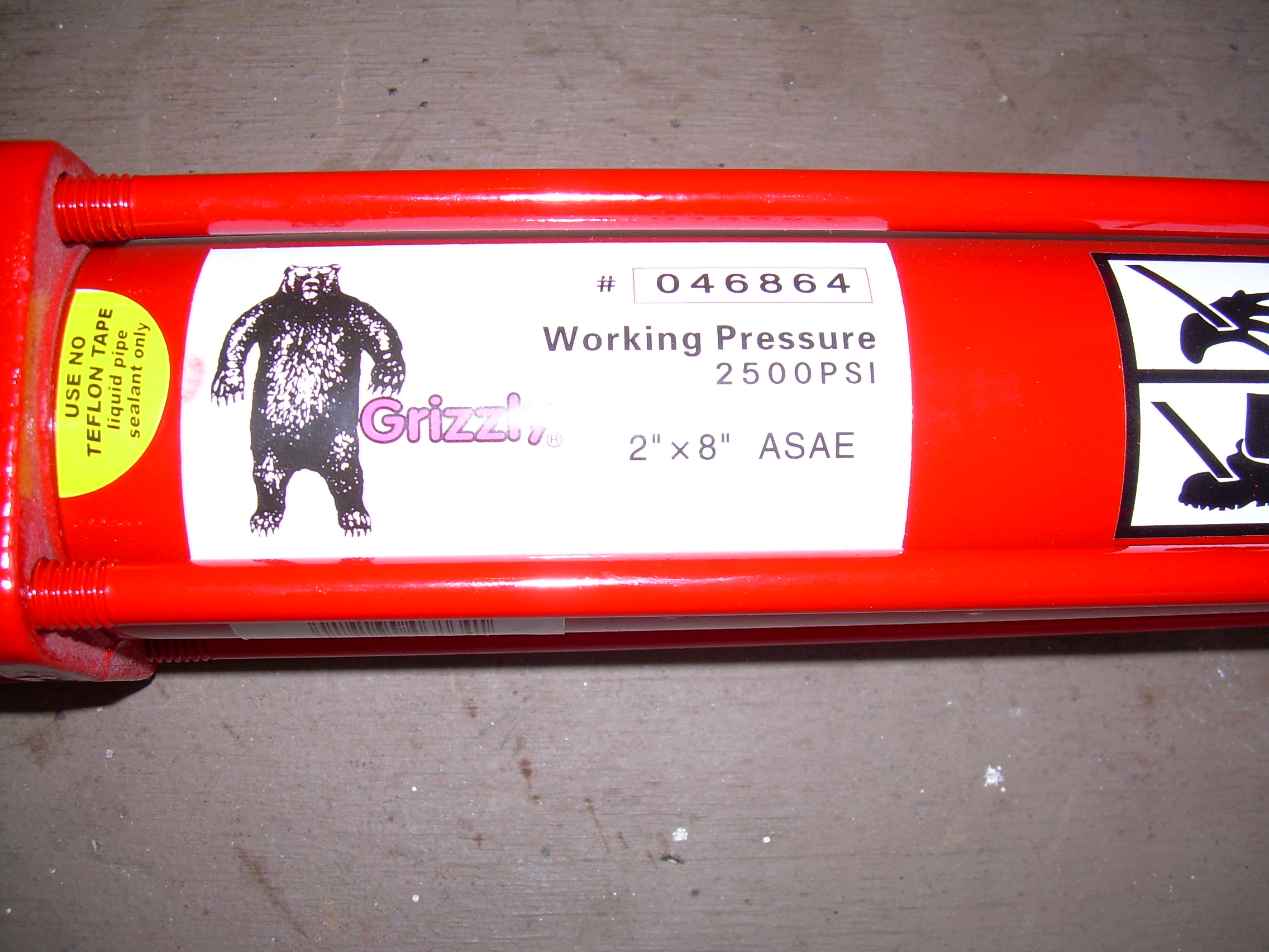

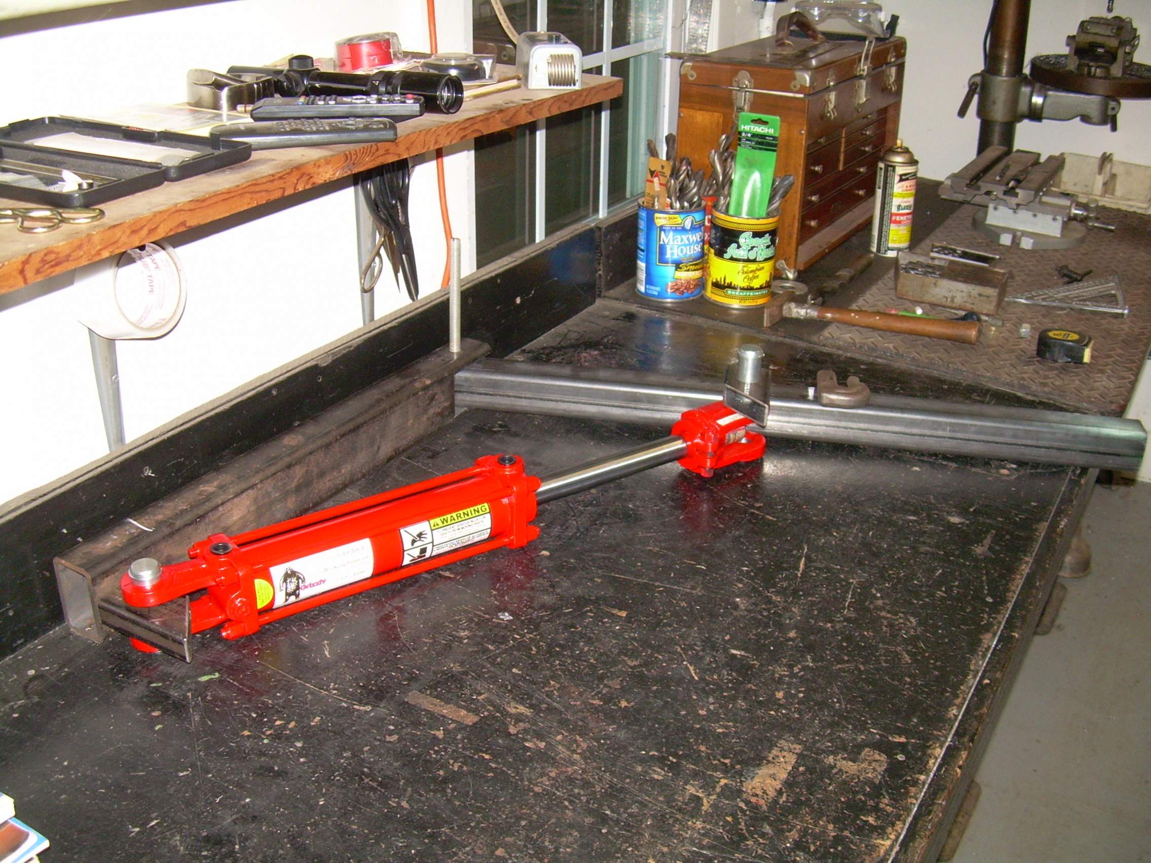

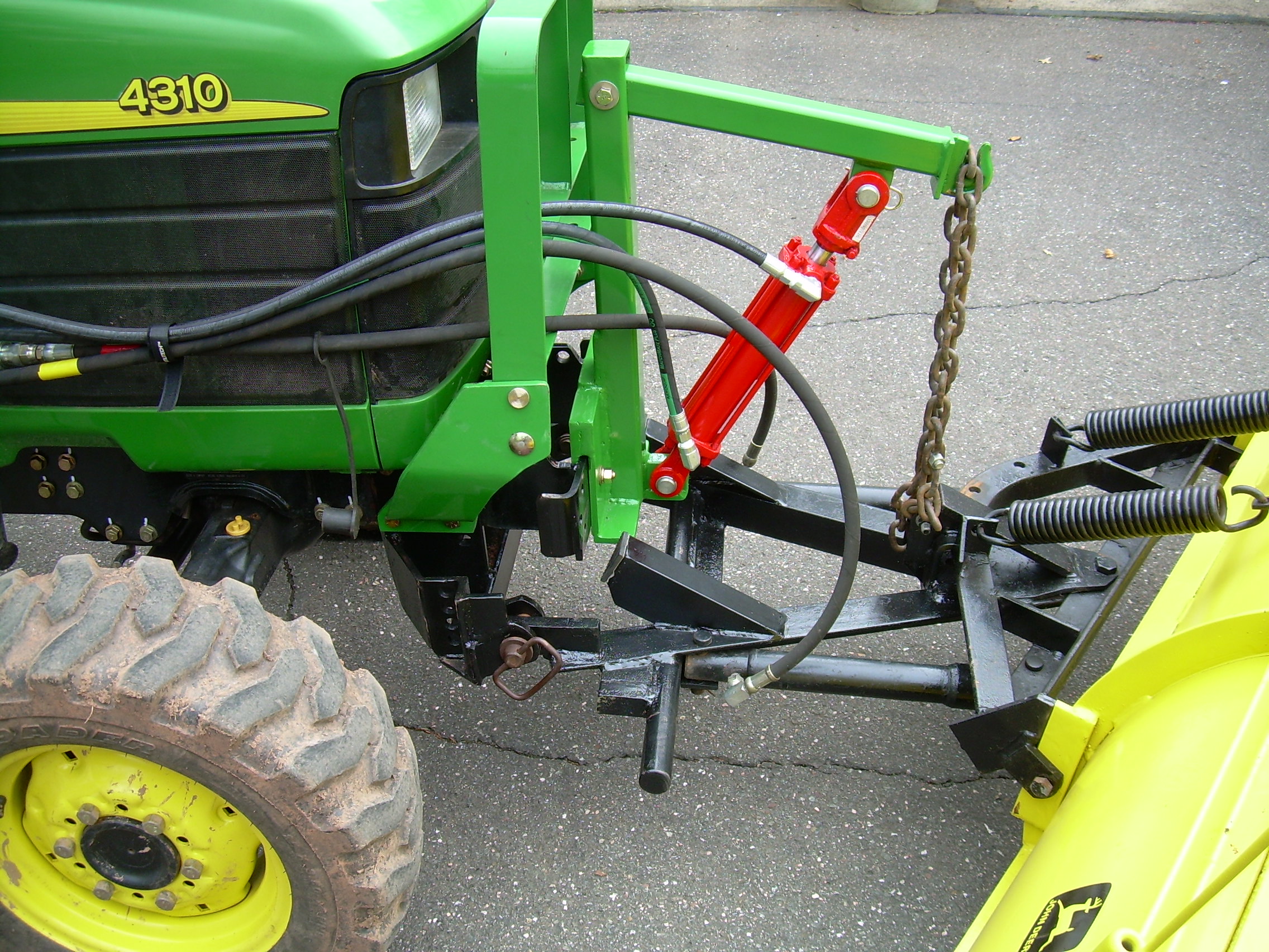

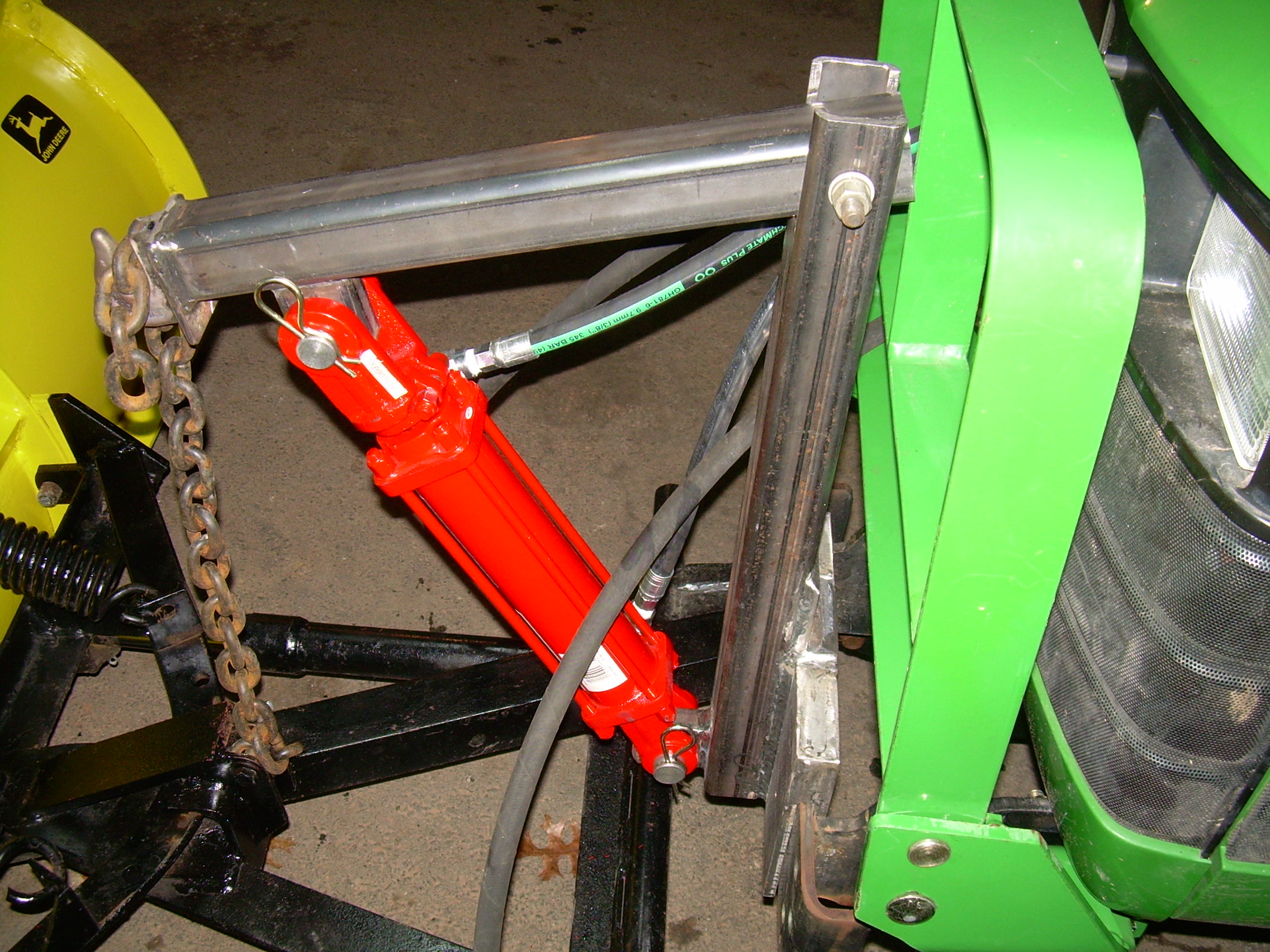

Very nice snow plow build. I am trying to get build one myself and was wondering if you could answer a few questions on your lift mount build? 1 What is the lenght of your lift mast.2 what is the lenght of your lift bar.3 What is the lenght and dia of your lift cyl? if you could give the demensions of these three things would appreciate very much Timbo58
#60
No problem,
I will have to measure that for you, the cylinder came from Tractor supply, I remember that.
If you don't hear back from me in a day or so bump the thread again to remind me.
You could use my numbers as a starting point, but I just got the cylinder and started laying it out on a bench to see how long the parts needed to be.
JB
