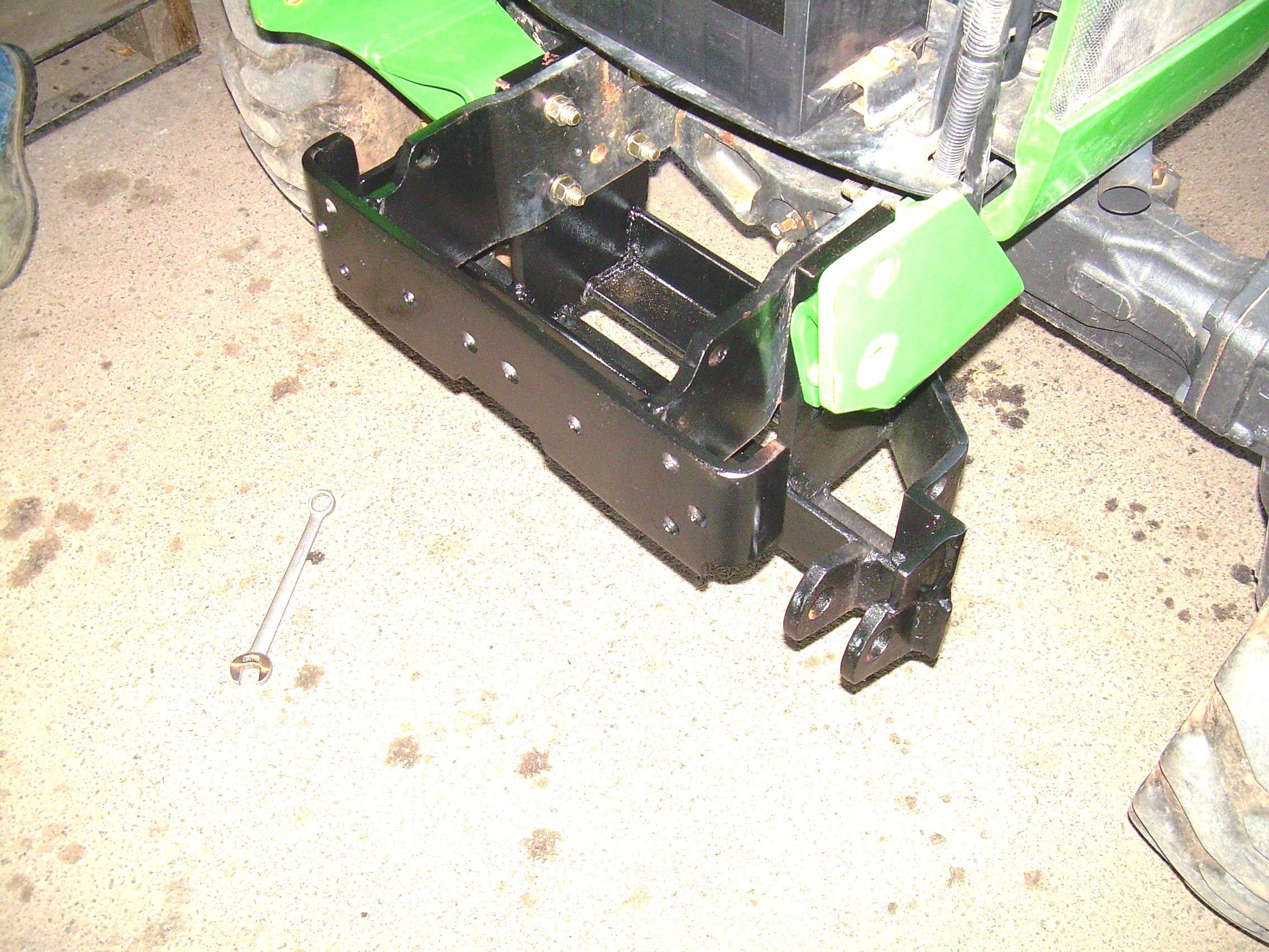

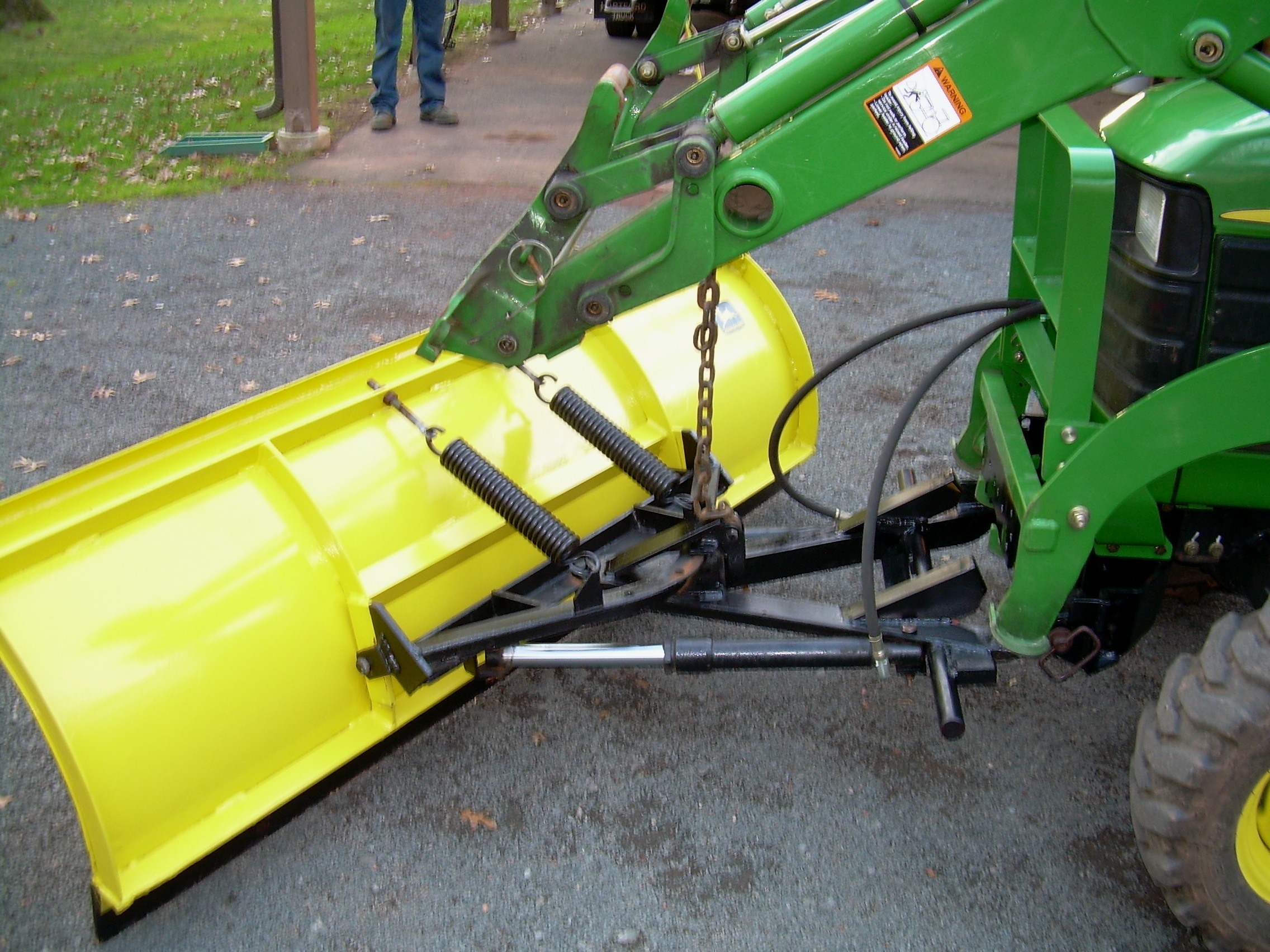

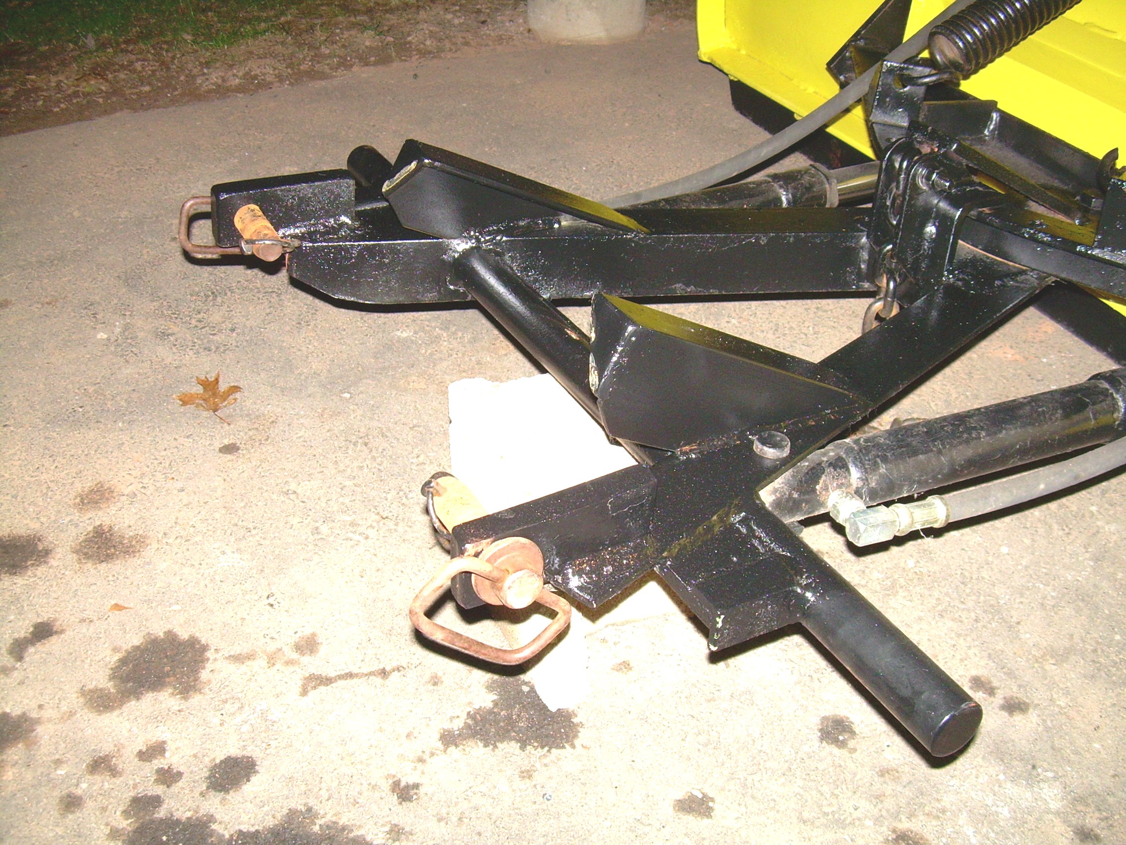

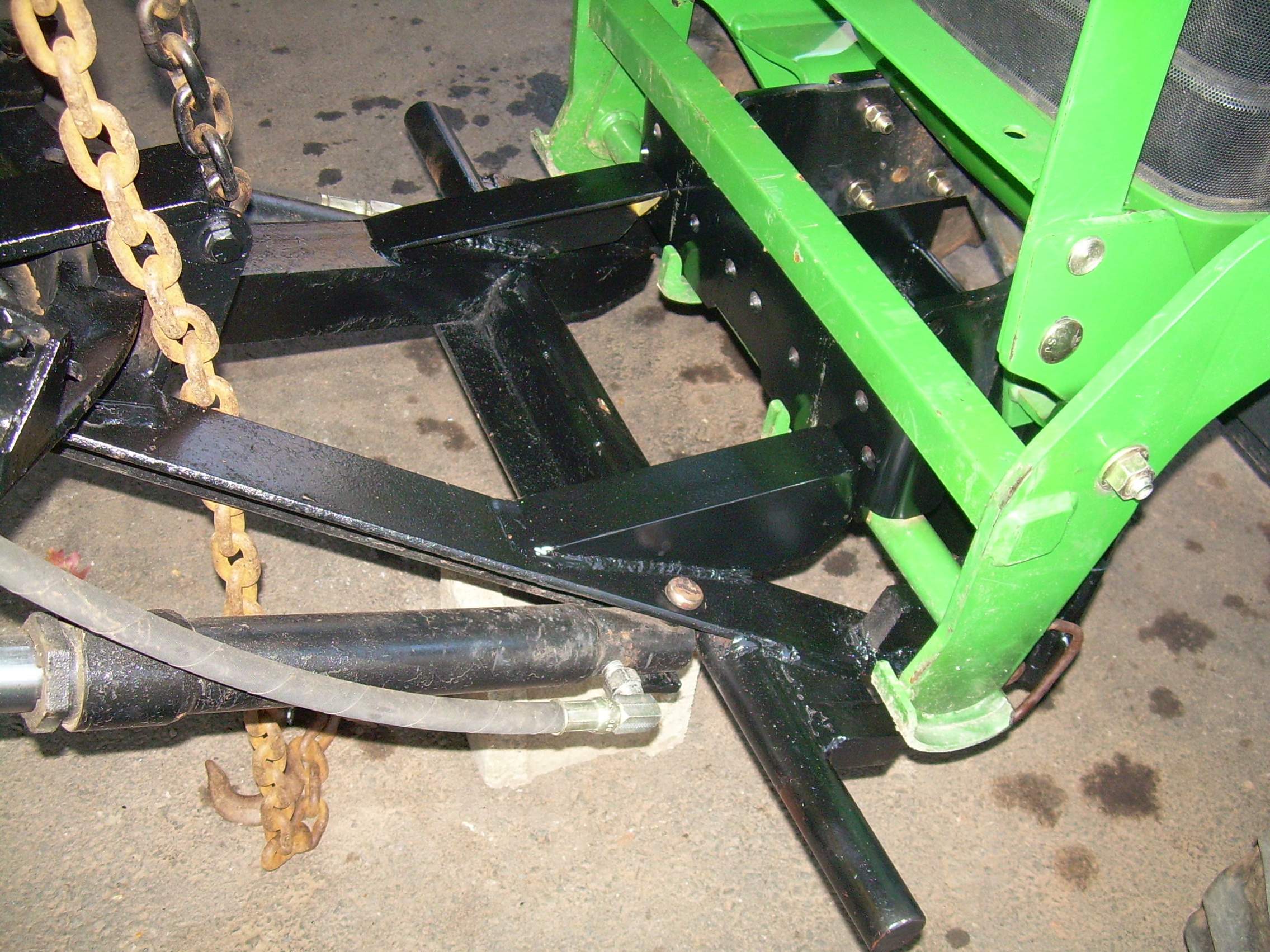

Some more pics,
Can go from the front loader to an independent front plow hook-up in the time it takes to swap 4 hydraulic lines, install 2 push pins and hang a chain on a grab hook. Hands will get a little dirty from the hyd fluid but no tools required!!!
Cost around $400. more than half of that just for Hydraulic lines and paint. had the plow already.
Don't be shy to point out any weakness's you see in this set-up, it can only help me to get it right before the snow flies.
Thanks, JB.
Very nice. If you are going to be plowing unpaved areas I would add some slip shoes to it to hold the cutting edge above the surface being plowed. I saw them at our local tractor supply for around $10 each. I am going to add them to my rear mounted blade.
   / Snow plow, Frame mount, Front lift #12
Nice job! The only thing I see is that with the rear mount being high it tips the blade foreward making the blade tripp easier. You might be able to tighten the springs to get away from this problem.
Bill

Thanks everyone for the suggestions,
I did install some stops built out of 2x3x1/4" angle iron, now the plow edge will not rise more than ~21 inches. That would only occur with the plow riding up a snow bank or if using the loader to lift not when using the front mount lift. Thanks Duffster.
I'm not going to put a crossover valve for now.
As far as the shoes go, I never used them when plowing for customers, of course that was 90% paved areas. I've got at least 3 pairs of those skid shoes laying around my shed, My yard now is half unpaved so I do some raking in the spring, I just go carefully before it freezes, I have packed process down so it doesn't really dig in to bad anyway.
As far as the plow angle goes, I am a little concerned about that myself, I wanted to keep the frame mount high on the tractor so it could stay there and not interfere with ground clearance, right now the plows hook up pins are 14 inches off the ground, not sure what is average for truck mount but probably a little less.
I'm trying to make this idiot proof and bomb proof within reason. I already had to reinforce the bottom edge of the plate hanger as I was stress testing the stops using the lift cylinder and found some weakness in the plates when just hanging there with no bolts. this stress would not occur under normal use, only happened cause I short choked the chain with the plow up on a block. I may have to/want to use the 2 thru bolts for the hanger though, not a big deal.
JB.

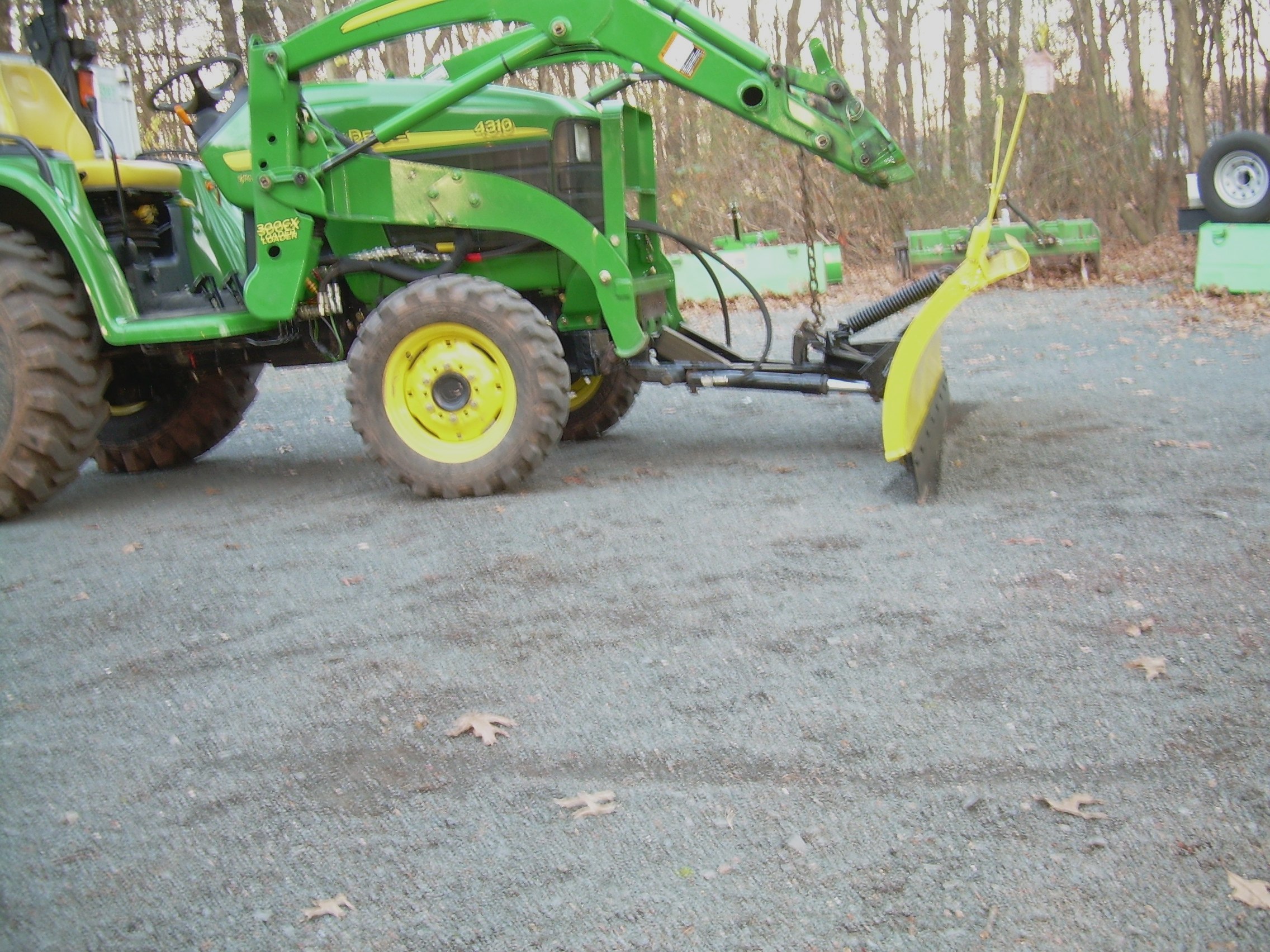

Having driven plow trucks and doing a similar install on my CUT (loader arm lift setup) I could add that you have essentially made for a down push which as the blade loads up will lighten the steering
Great for scrapeing icy buildups, but not so good pushing a snow loaded blade.
If not to late, lower the pivot points to keep the push arms parallel to the ground.
You could simply weld 2 short arms to the frame or alternately weld them to the plow a-frame arms.
But it is essential to have the A-frame parallel to the ground!
Also doing so will then place the blade at the correct angle of attack.

On my setup, the A-frame is level with the ground. Did that by raising the ears on the A-frame where the connecting pins are located. That way, the hitch on the tractor doesn't have to be lowered.

Well that's an aspect I gave little thought to, it's now obvious to me, the angle of the A-frame and the critical role it plays in how the load is applied back to the plow vehicle.
Mine is not level and is angled down forward as mentioned. Not a radical angle but definitely not level. HOPE it's not gonna lighten the front end to much. I'll post some side view pics so all can see the angle. If necessary I would raise the ears on the A-frame like beenthere did, then I'll have to redo the new stops, oh well.
It would be to much work to lower the mounting frame, plus it would weaken this simple 2 point mount which gets it's strength from it's short stout stature.
Today I installed a cross brace between the 2 down plates of the frame mount, a 2.5" x 2.5" x 3/8".
Trying out the loader lift option, no further need for the limiter chain with the stops.
Thanks again, JB.
