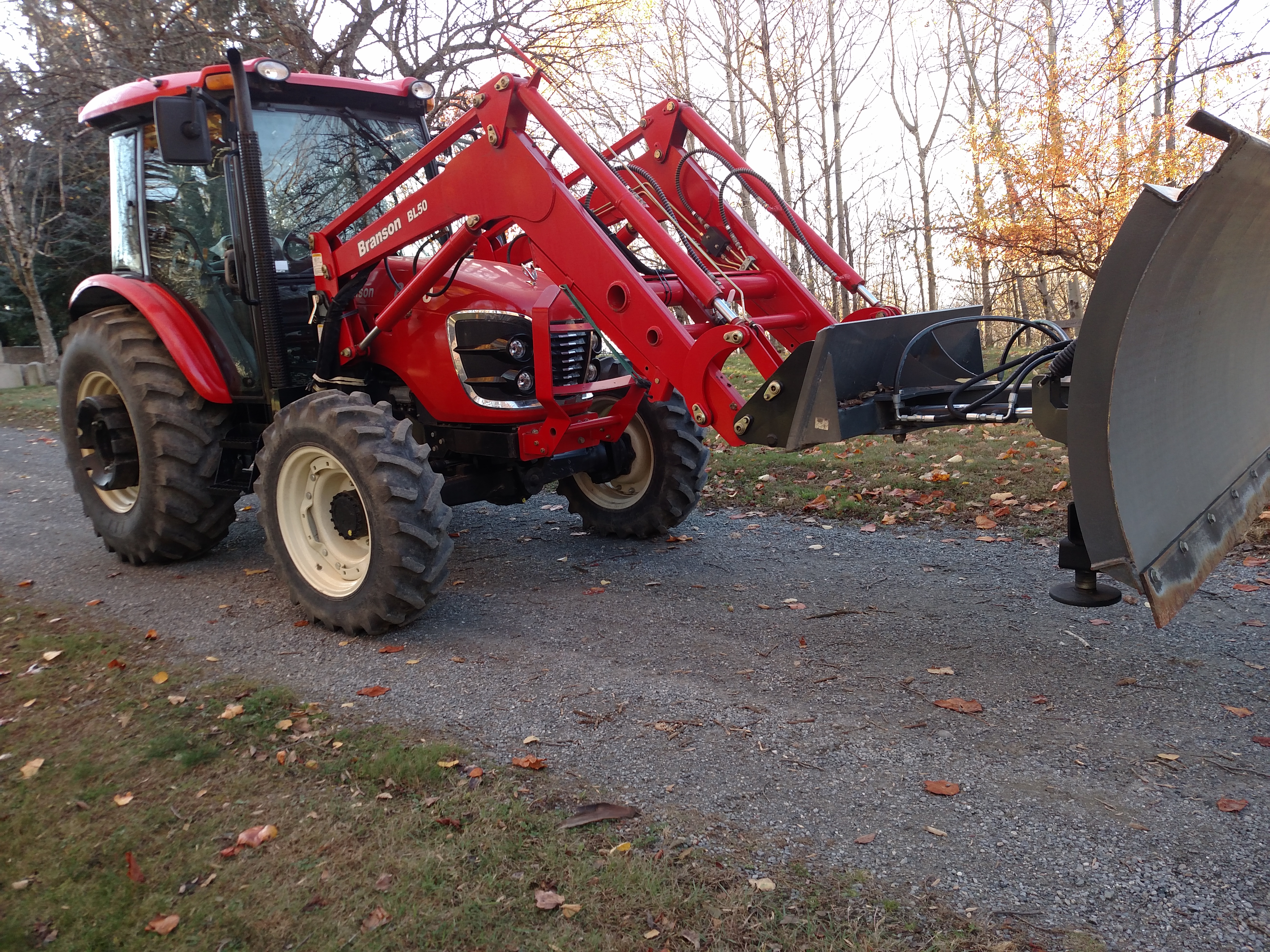

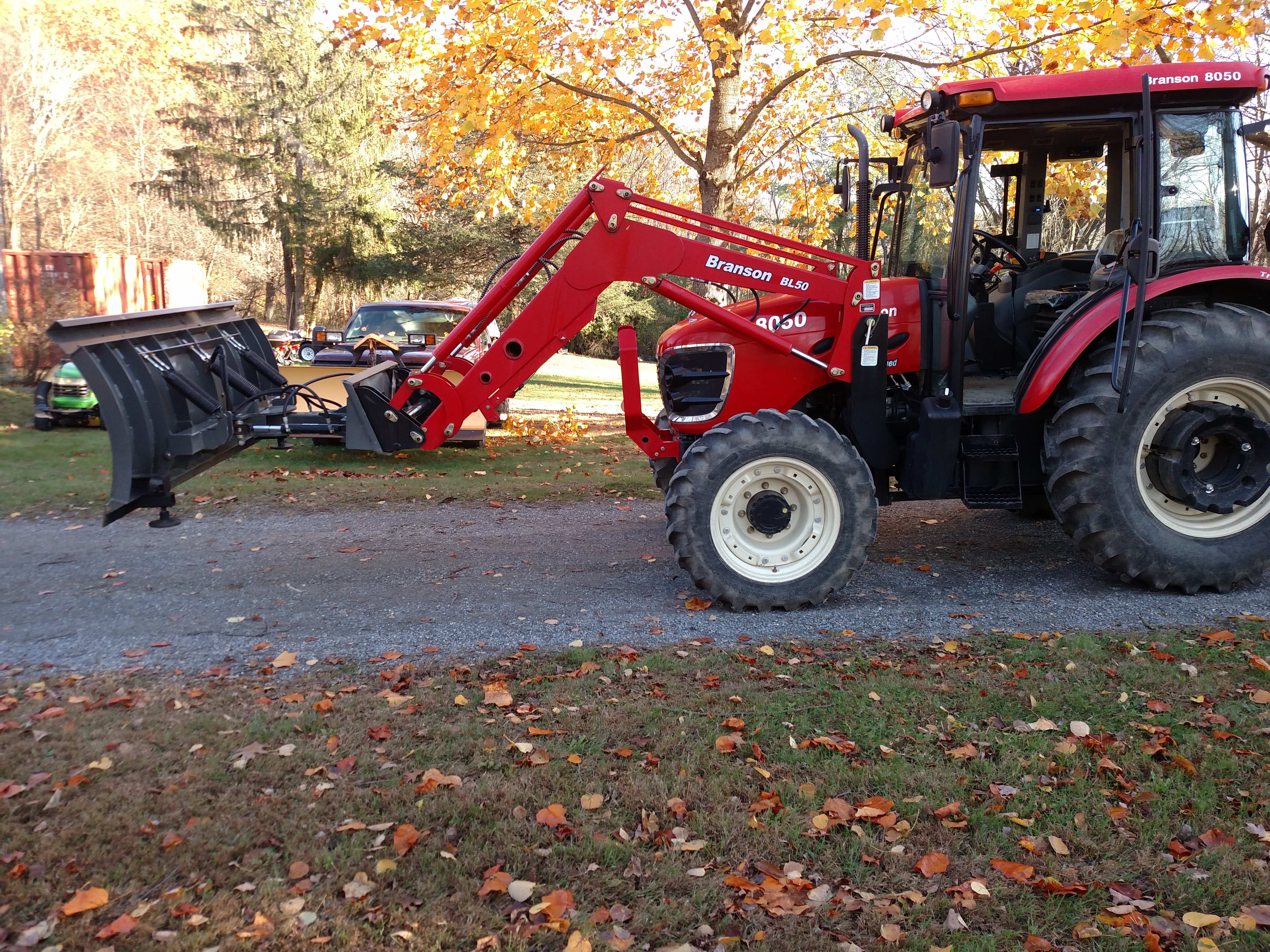

There are a couple of threads on here about making an under slung mount for a front plow on a loader frame it shortens up the package nicely and takes a lot of the bounce out of the plow setup.
I have a SSQA plow and it sticks out a long ways in front of the tractor,
I believe I would have been happier with an under slung truck plow setup.
about a 9ft V would be nice.
View attachment 657457View attachment 657458
Yes, what I have sort of. Does the job but one nasty set of storms a few years ago got me to thinking there has to be a better way.
I played around with lighting on a total of 5 different tractors over the years and the only setup that has worked on more than one tractor has been worklights mounted high on the cab. Factory headlights haven't worked well any time I had something mounted out in front of the tractor.
Got a set of Ghetto Blaster LED's on the Ford, just under the overhead cover, gonna do that again. A smaller set for the rear as well.

As any of us that use a loader in darken conditions can tell you, lights in the tractor grille are much less than functional with raising the loader arms.
Many of us (self included) have tried mounting lights on the loader in some manner with disappointing results. These work well (LEDS) while the bucket is low working, but if wishing to dump a bucket load in a trailer, well you get well lit tree branches.
Just a bit of word pictures to encourage you to put your lights higher (ROPS or cab mounted) and use multi sets or spots and floods to give good work area coverage.
Fender mounted seem to do ok toward the rear as you lift height is much less to see around, but if possible higher mounting works well there also.
