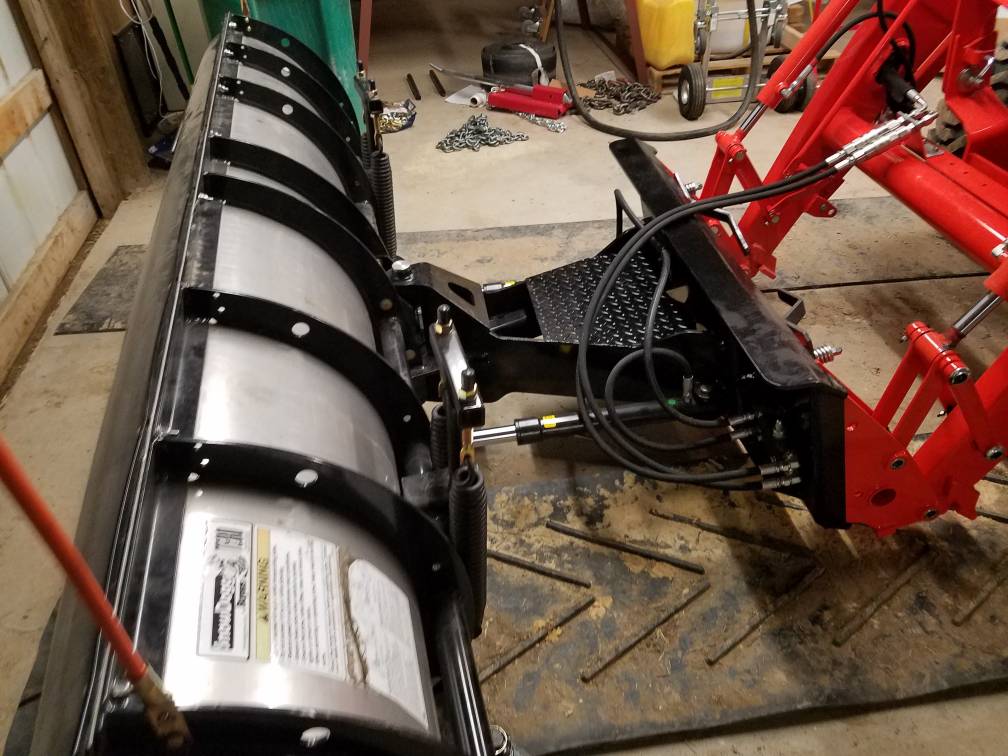

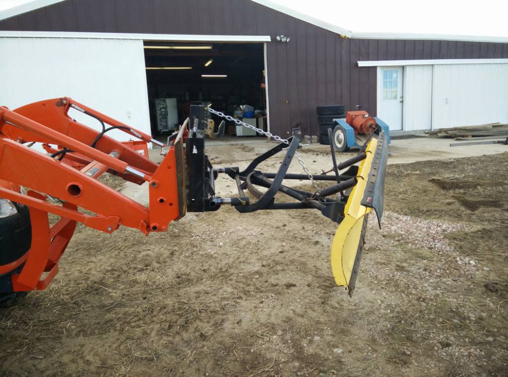

My new plow is solid mount & sticks out a ways forward. It works ok, but I do wish it was more compact (underslung) & had float. I got it new at a good enough price figuring I could redo the interface to the SSQA plate to add float. It's worked well enough I havent bothered, yet.
The small yellow plow I made for my old machine had excessive float (flipped it back over the top occasionally when it was lifted all the way up). It hung out to way to far & caused lack of steering issues.

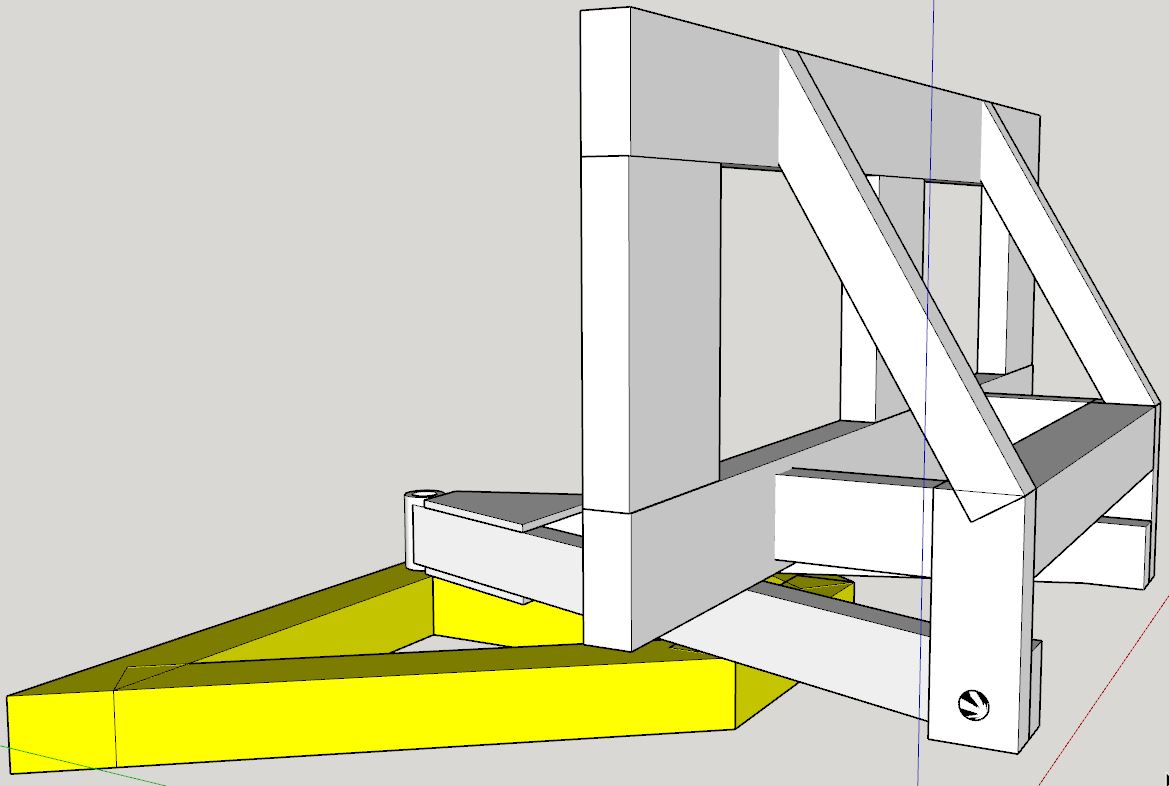

Question... If I undersling the mount with a pivot - How much vertical room should there be between the a-frame and the bottom of the SSQA plate as it passes underneath? Zero room would mean zero upward pivot and it might as well be hard mounted.

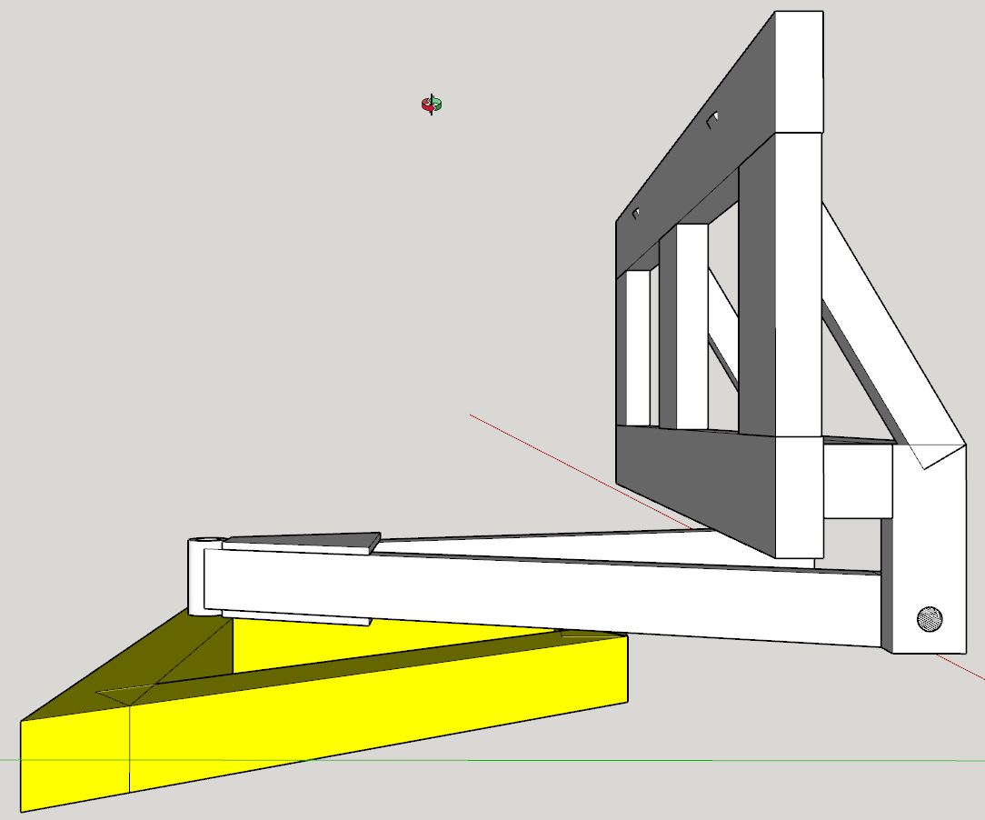

Ok - morning coffee and some time spent with sketchup... Pretty crude drawing - but based on feedback - here's what I came up with.
Mount is now underslung on the QA-Plate with 2" of clearance between the a-frame and the bottom of the QA-Plate. Cylinders and chains are not shown.
Sean.
   / Snow plow hydraulics for tractor - questions #15
I have seen that done, but they moved the pivot for the arms up to be even with the front of the quick attach so that it can float up or down without hitting like your design will. They left the upper a frame sticking back begin the quick attach plate to have a place to mount the angle cylinders.
Aaron Z

Ah - I like that suggestion. See - I should have had the coffee BEFORE drawing out the design.
If I move the pivot forward on the a-frame as you suggest - directly under the quick attach plate - it eliminates a lot of that material and work on the back end of the plate. It becomes literally just the a-frame with a couple ears to pivot on. Waaay easier. For some reason - I just assumed the pivot needed to be at the end of the a-frame...

On a truck it does as you can't have the end of the a frame hitting the radiator. On a loader mounted plow, you can get away with it.
I might also add a couple of skids to the bottom of the quick attach frame so that it will skid smoothly when it bottoms out.

A couple of these (1 in. Thick x 1 in. Hole Male Tang Cylinder End | Princess Auto) welded under the quick attach plate - and a couple more on the a-frame, along with two 1" draw pins and I've got an instant pivot point without all the xtra work. Yes - I like this a lot more... That design is more suited to my level of skill as a welder too.

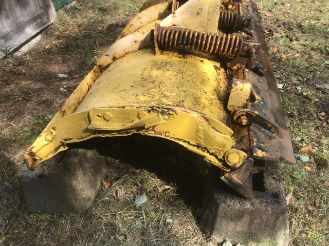

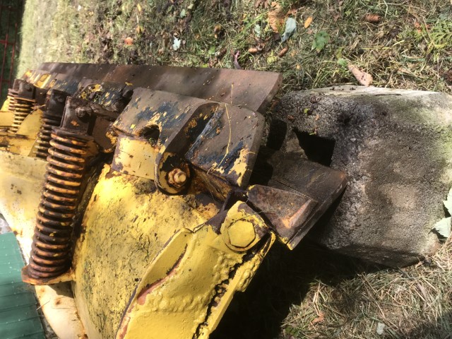

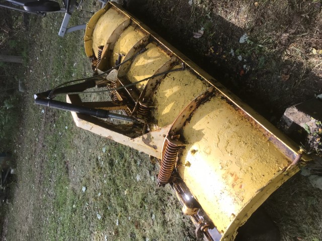

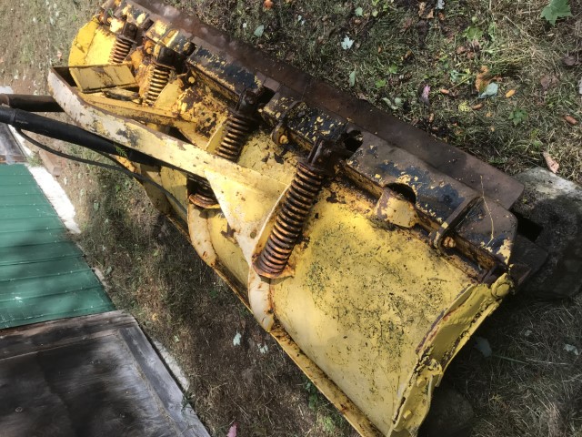

Here's what I'm dealing with for a plow... A little rough - but certainly usable. The worst is the one end where it's bashed in pretty good with a bad repair on top of it.
Not sure I'll keep the hinged piece on the back - anyone have any strong opinions on that? It's seems to be an add-on that was cut out around the springs with a torch. It's in fairly rough shape (some cracks) and not sure it provides much value? It also appears like it would get in the way of the running skid feet...
Sean.
   / Snow plow hydraulics for tractor - questions #20
That looks like a backdrag blade that has been added, they are handy at times but that one looks like you can't use shoes on the plow with it on.
It would or should fold back when plowing forward and drop down for pulling backwards.
