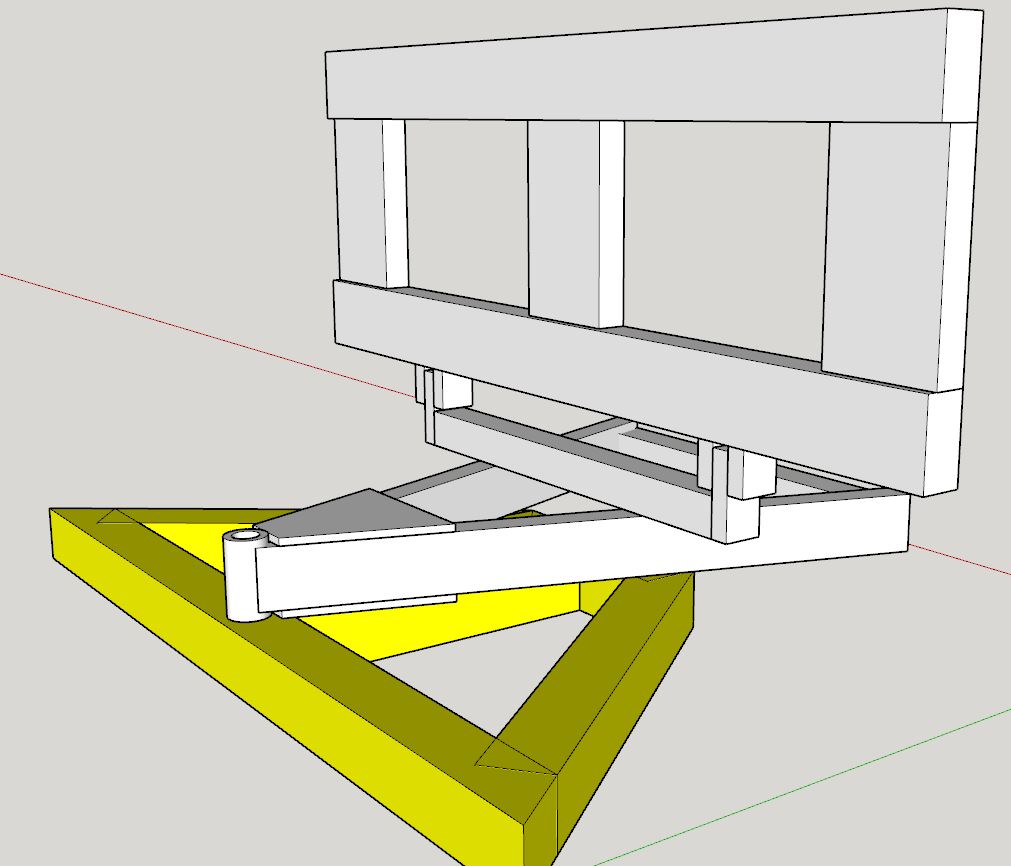

Here is my latest workup moving the pivot point forward on the a-frame as suggested. I'd like to start buying material and start welding this weekend - so I have another question for folks. All of the tubing you see in the drawing - I was intending to use 1/4" wall. Is that massive overkill? Would 3/16" suffice?
Sean.
