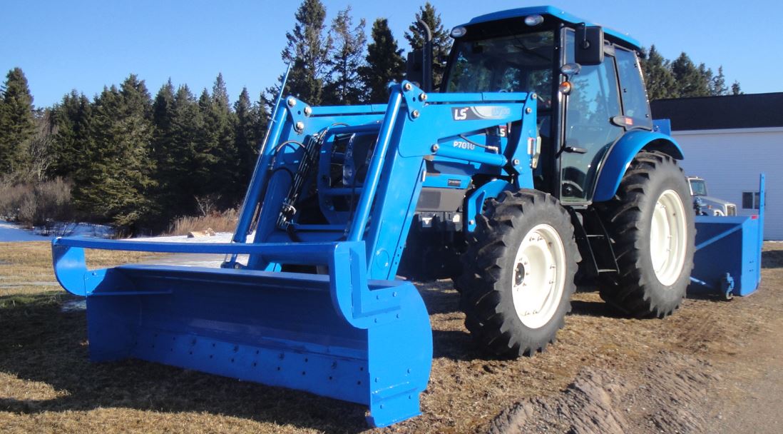

I have both a 7 ft plow and a 6 ft pusher, I also have a rear mounted blower all used with a TYM 453 cab tractor. This winter I have been using the pusher exclusively. The pusher is great for short runs around buildings and around my house, the best part about it is it does not tear up my lawn or driveway like the plow sometime does especially when the ground is not frozen. For long runs it is not as good as a power angle plow but being only 6 ft wide it does not bog down unless the snow is really deep, the trade off is I may have to make a few more passes but I will take it. When the snow is really deep I attack with it the 61/2 foot blower.
Bottom line for the pusher is if you have short runs and are plowing back snow over your lawn it works great.

I use an 8ft pusher and 86" snow blower. The blower works good but is slow and hard on fuel. The pusher is much faster and does a good job cleaning up. The blower is a must if you don't want high banks nearing the end of winter. I just added a back drag on the top of the pusher, should help cleaning up closer to any buildings and knocking down the high banks at driveway entrances.
