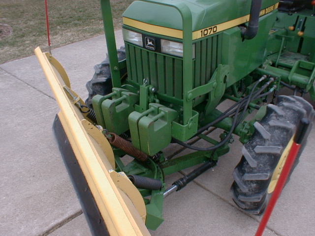

Check your math. My 8' Western plow is about 68" wide when angled at ~45 degrees. 30 degree angle gives you an 83" swath. Chains on rear drive wheels only because you may not have good steering control or clearance when turning at full lock. If you don't have good sidebite with the high angled plow use left / right rear brakes to get directional control. I use weight for traction, not chains. Don't want to tear up the concrete.
The trouble with loader plows is the long plow base which makes it difficult to keep the tractor going straight. 90402086.jpg
