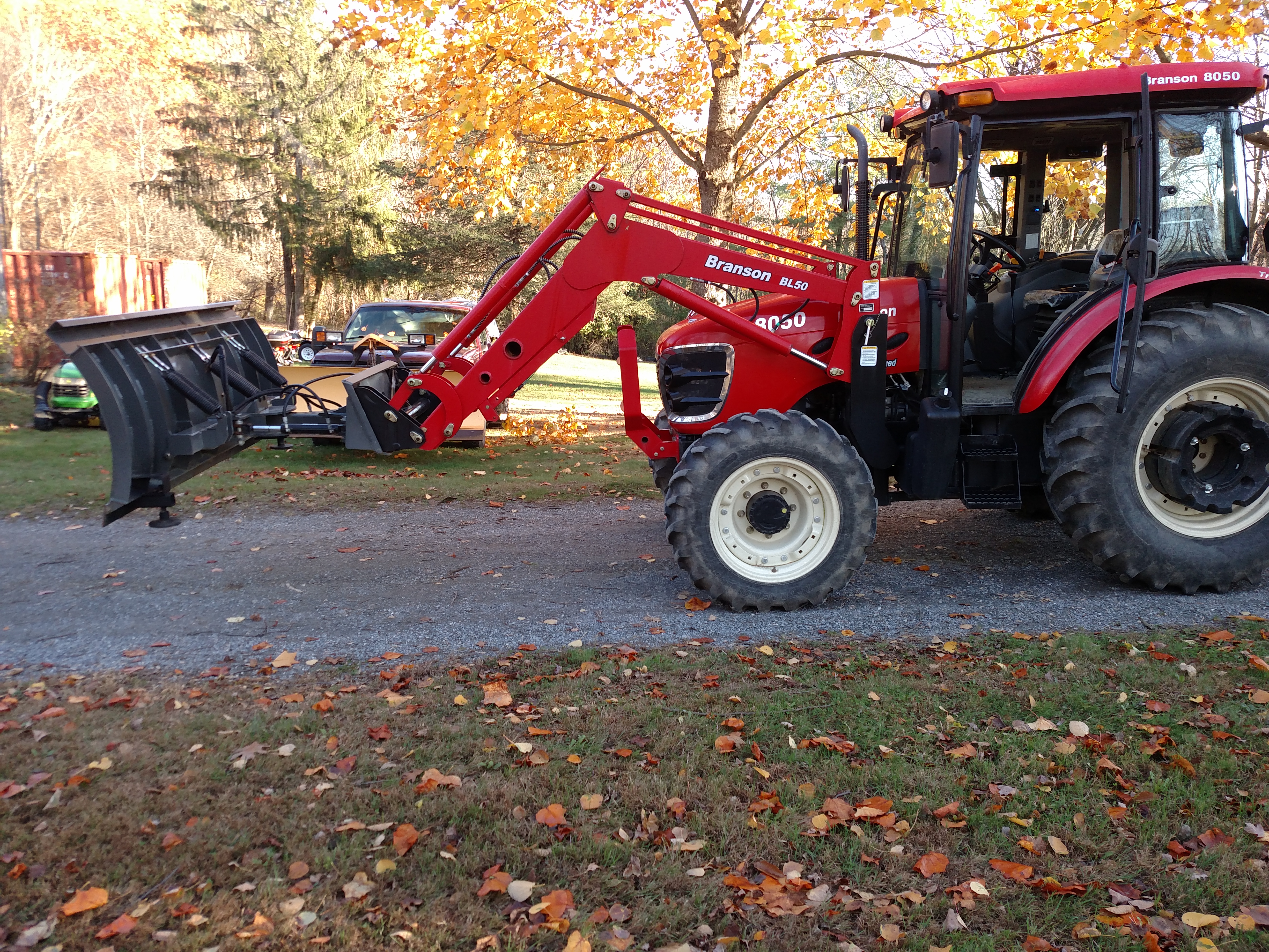

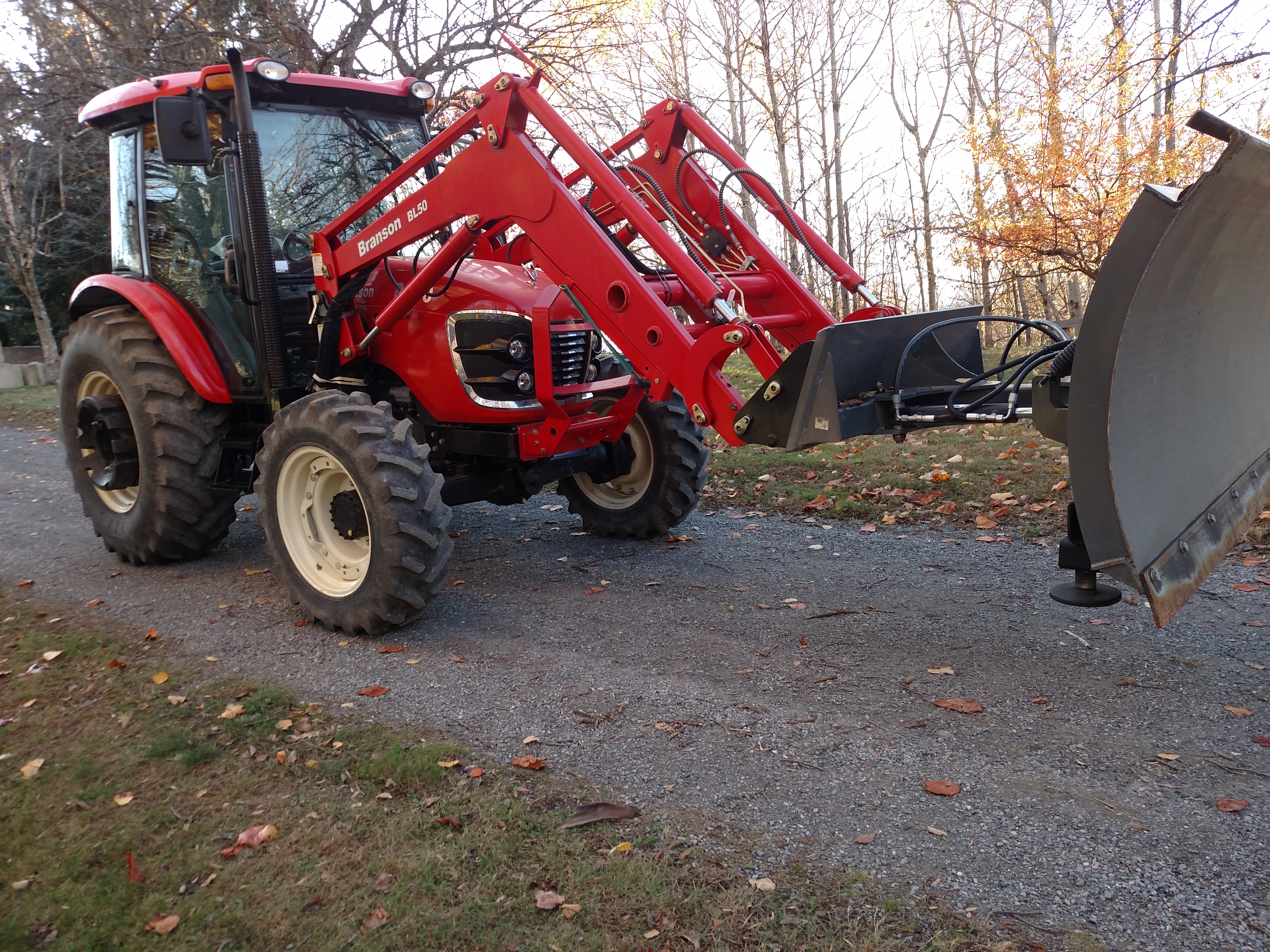

I have a quick attach on my FEL, so the plow will be out there instead of the bucket, rather than in front of the bucket. With filled rear tires, the studded "euro-style" chains, and the snowblower hanging off the back, the back end is probably not a concern. However, the leverage on the front caused by an angled plow is a still a concern, which is why I'm inquiring about chains for the front. As RickB mentioned, brake steering is difficult on the TC33D, since the hydro pedal and the brakes are both on the same side. (A dumb design, though it is possible to get both feet over there, if it's really needed. I wouldn't want to run in that position for any length of time.)

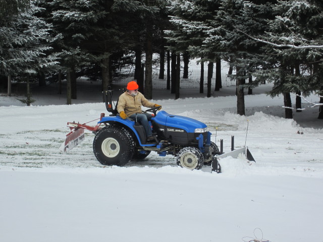

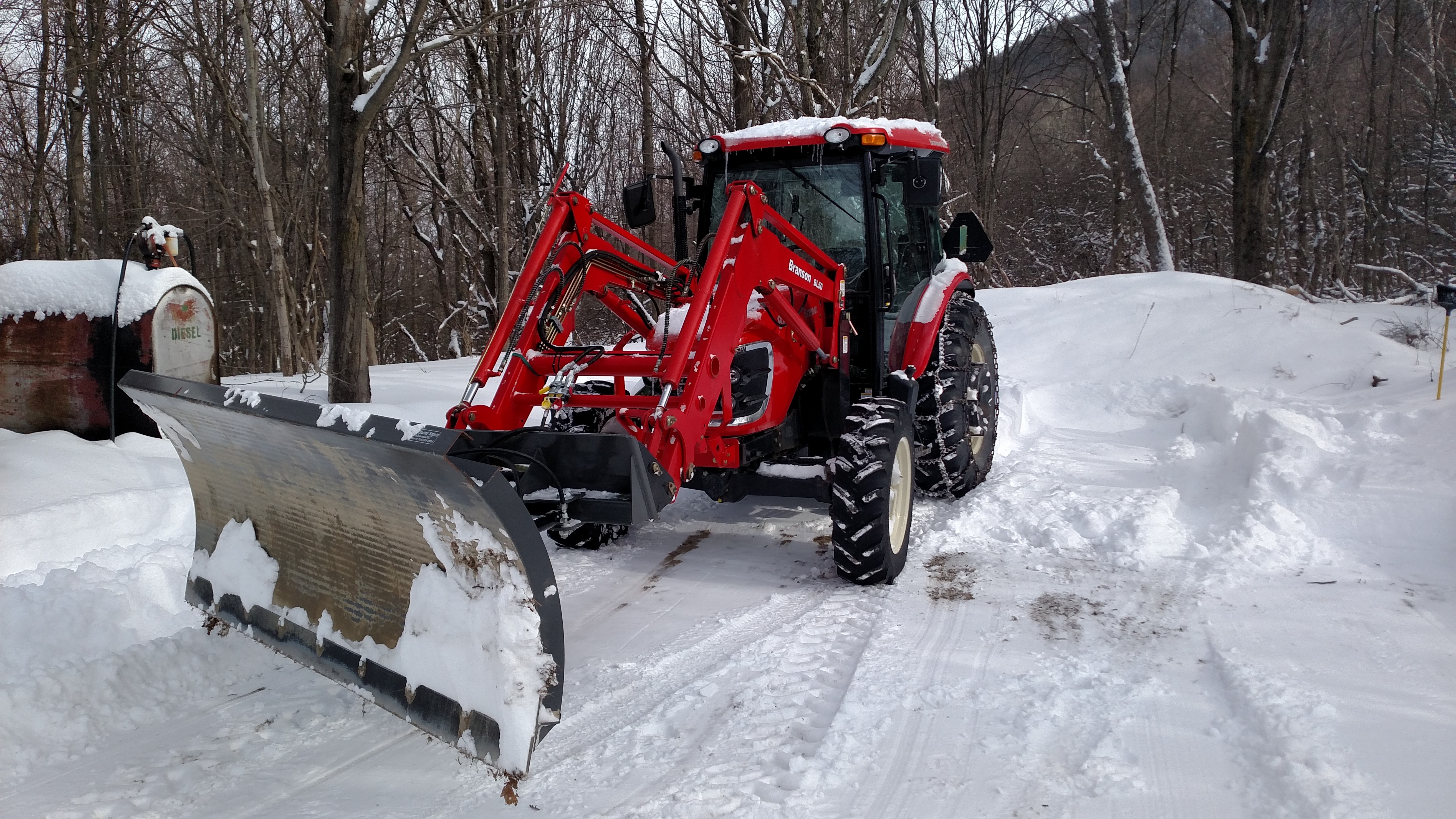

John,
My tractor is a bit larger then yours and I only have an 8 foot blade mounted on it,
many times I have wished it was a 10 footer.
That said I have not noticed much side deflection using the blade to push snow,
I do have to wait for the ground to get froze up hard before using the front blade,
I don't normally run front chains, I have them and can but usually don't need them I can and do brake steer,
that should be loading the arms more then chains do. I also plow slowly just to be easier on my equipment.
Much of the time even with the blade angled I'm using an inverted J pushing style to shove the snow over the banks
on my drive and between the trees.

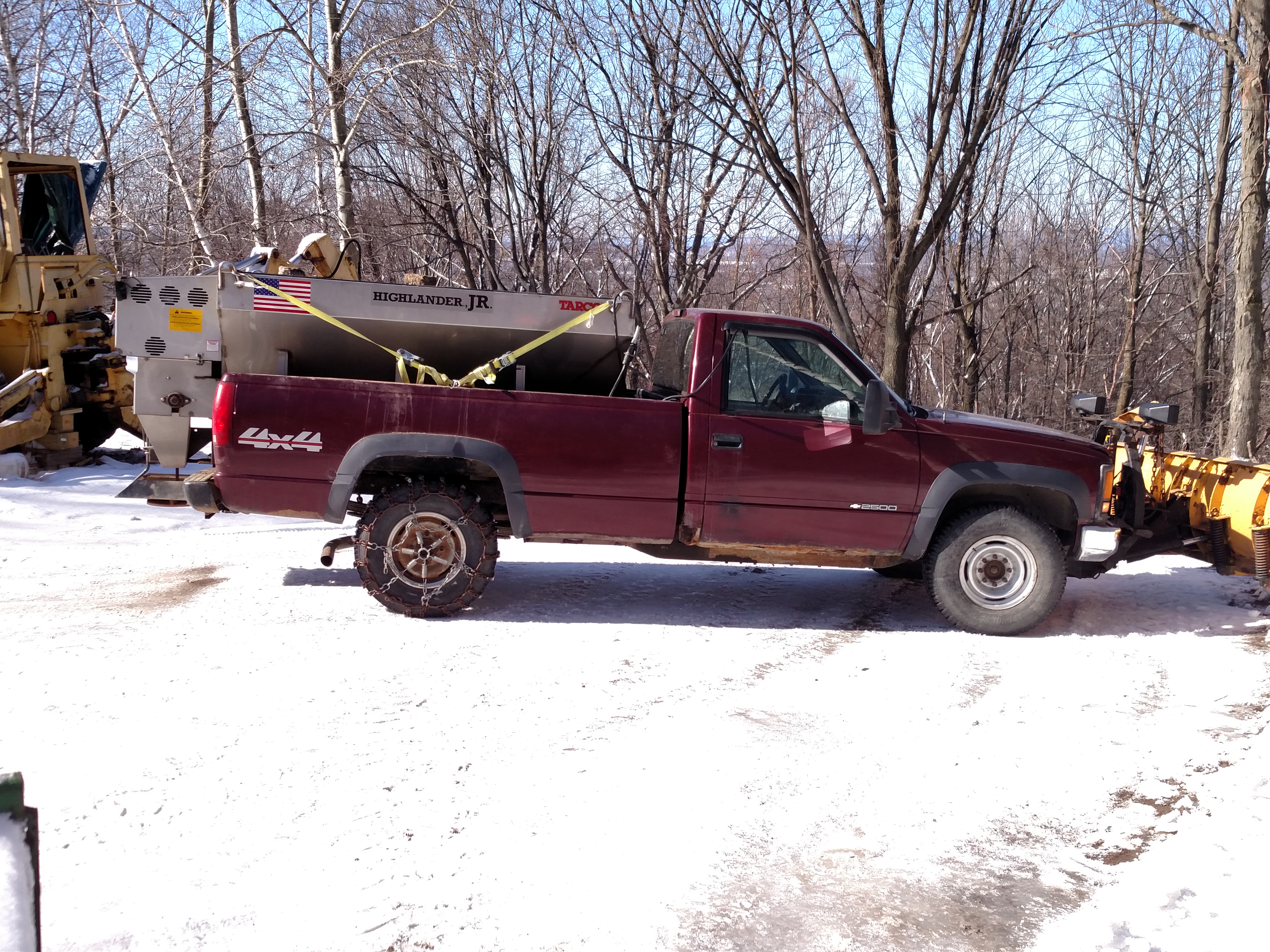

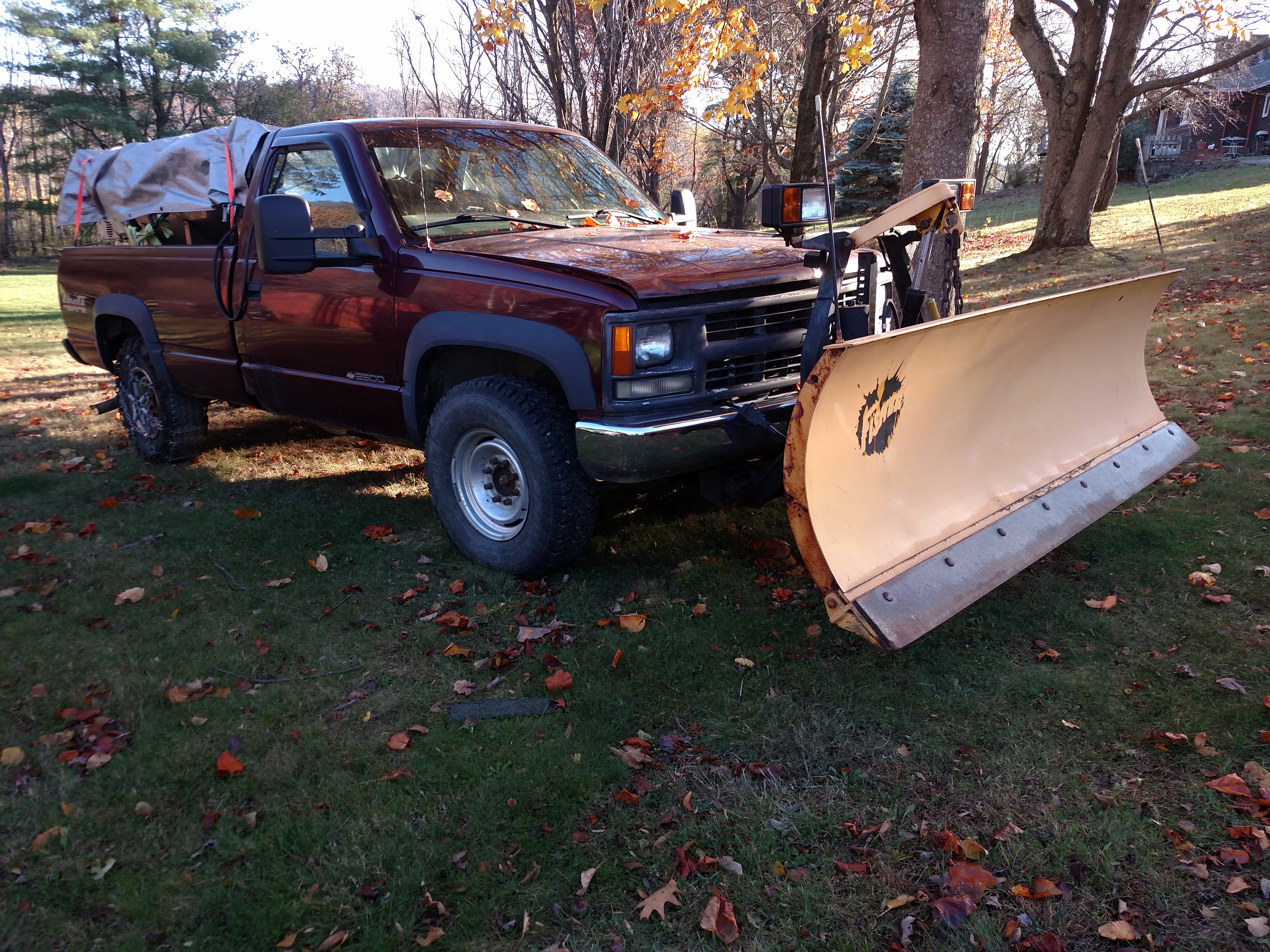

I do a 1/4 mile driveway and prefer the tractor over the truck.
The FEL mounted blade lets me push well off the driveway and over the banks the truck always drops a front tire over the edge of the driveway when pushing the snow back where the tractors blade is much futher ahead of the front wheels which are easier to see as they near the edge of the drop offs.

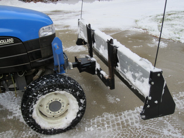

A front 2" receiver mounted plow gets it real tight to the front too. There are even a few plows that have the lift/angle hydraulics that fit a front receiver.
