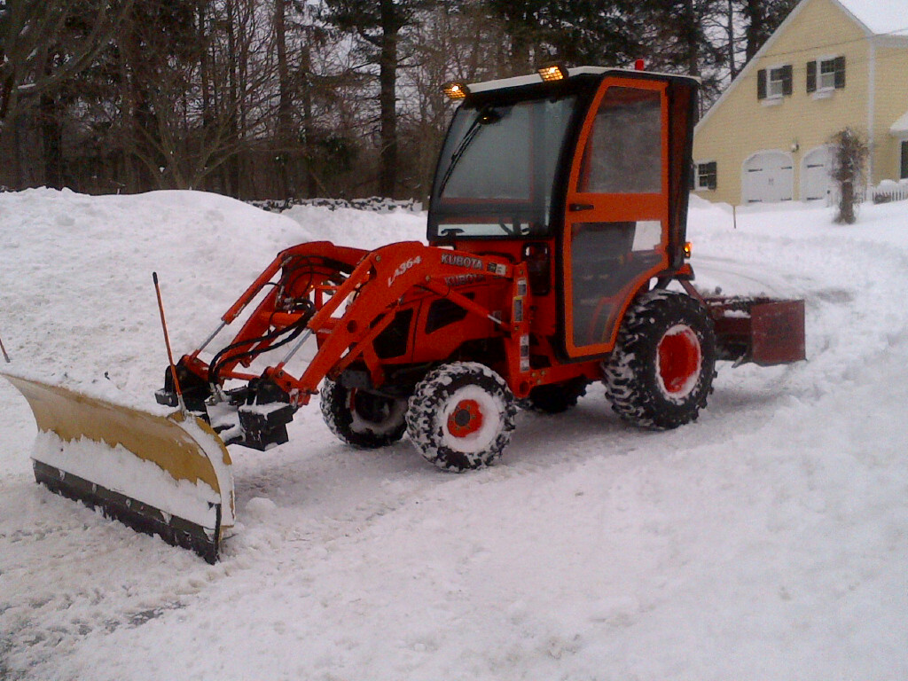

Ok - so I see Rays confusion - this was my rear blade set up (which I have now migrated to a front blade with the same rubber mat) - on my rear set up the rubber and the edge of the red steel frame of the blade extended much farther down than the cutting edge itself partly because of the angle I set the blade and the rubber took up almost a inch when folded so the edge never made contact with the ground. For my front mounted set up I took the cutting edge right off and used a thick "L" piece of steel shelving leg and sandwiched the rubber to the plow blade itself - this way there is no cutting edge to get in the way. I have to admit the rubber seemed to worked the best for my back blade set up and while it did work well for the front blade (last year was my first time using it) I am thinking of now using a 3 inch steel pipe welded to the cutting edge just to see if that too has merit.
This pic isn't the best but what you see is my rubber blade attached with the steel channel - worked well - but I think a steel pipe edge for a front blade set up will work even better
