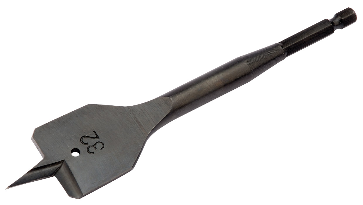

I used a 1" spade wood bit for the holes - that way i had some 'play' in it.. the bolts i removed were 2" long - so i went with 3" since i was adding 3/4" with the mat.

This is the drill bit that I used.. since this mat has no reinforcement within it it doesnt take a lot to get a clean hole
