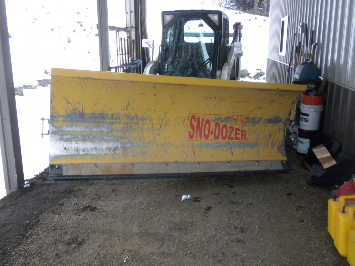

If you can push the snow with your bucket on the skid steer you should have enough traction to use a plow. Maybe others with tracked skid steers can offer a better perspective. I plow with a wheeled skid steer with chains all around because I'm on a fairly steep grade and by mid-winter it's hard packed snow and ice for a base. I'd slide right off the hill with rubber tracks. I use a plow early when the base isn't frozen and late when the snow floor softens and slush needs to be scraped off. In the dead of winter I use the blower because our snowfall here is typically 120 - 160 inches.
Plowing in "big snow" country eventually leaves large snow berms that start to crowd the road and you end up turning sideways to push them farther back. That's when a blower is in its glory. With the kind of annual snowfall you likely get a blower really doesn't make sense - a plow will do the job much quicker and plows are a lot less expensive than blowers.
Plowing (or blowing) a gravel road that isn't frozen solid or doesn't have a hard snow floor has it's own set of problems. You can fabricate some larger rectangular (long dimension front to back) plow shoes that will reduce the tendency for the shoes to sink in and cause the plow to cut into the gravel. You can also add a piece of slotted pipe over the cutting edge and that helps some.
