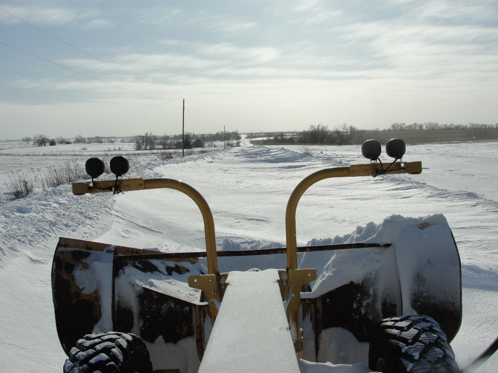

I use my 3 pt blade. I plow about a mile of gravel roads several times a year. One of the problems with plowing on gravel in our area is that the ground here does not freeze hard all winter. If you use the grading blade by itself, you are often throwing gravel to the side of the road with snow. I have been bolting a 2 x 10 PT board to my blade. My board is 2’ longer than my blade so that I have some leeway beyond my tire width. This allows me to plow to the edge of the road without running my tractor real close to the edge of the road. The board also is a blunt edge rather than a cutting edge, so does not throw gravel with the snow. The result for me is that I am able to plow almost down to the gravel without moving the gravel. I just drilled 2 holes in my blade, and attach the board with 2 bolts. When I want to use the blade for grading in the spring, I just take off the board. I believe I heard about this from someone on this forum, but I can’t remember who.
There are others who have fashioned PVC to on their cutting edge or steel pipe to bolt on. The wood board works well for me. I have a much smaller tractor than you, but don’t see why it wouldn’t work for yours.

Turning the blade around 180 degrees basically does the same as bolting a board to the cutting edge. It allows the blade to ride over the gravel without moving it.

Do you use the edge tamers to plow snow on a gravel road?
Yes, it keeps the cutting edge off the gravel so that all I am moving or plowing is snow. We get very powdery snow here at times and the bucket cuts right through it and into the gravel. With the edge tamers what is left is about a half inch of snow that will burn through fairly quickly when the sun comes out.

Great. I have been leaving the bucket above the gravel a few inches and finishing with rear blade turned 180 degrees. It would be nice to be able to float the bucket without disturbing the gravel.

I plowed some sticky wet snow once and the edge tamers did little good since the sticky snow lifted a layer of gravel despite the edge tamers.
