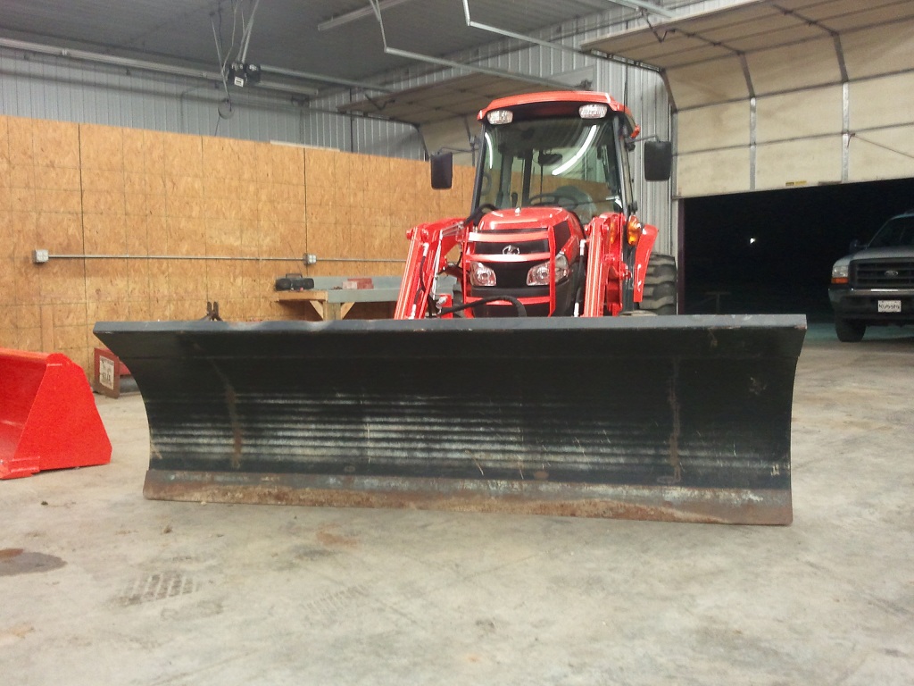

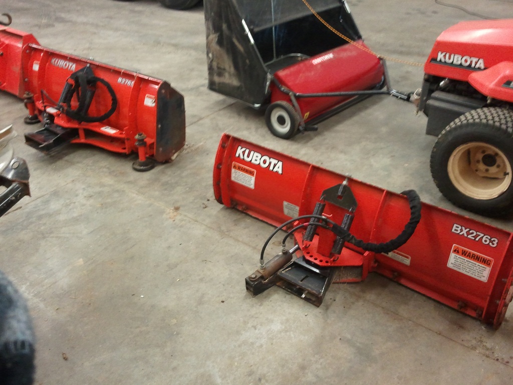

I am a new user and looking for feedback on snow plows for a 59 horsepower Kubota tractor. I have a loader with quick attach mount for various implements and wondering how the snow plow implement works? I have read/heard that the torque of plowing snow can bend the loader arms. If true, is there any way to stabilize arms to absorb the extra torque when plowing? I am considering a frame mount plow and just removing the loader during snow season, but recognizing I use the loader frequently year round and don't like the thought taking it on and off for the frame mount plow to fit. Any thoughts or feedback would be much appreciated.
I have an L5740, and I use a 9' angle plow or an 8' snow pusher. I haven't had any problems with my loader arms. Previously I had B3030 and a BX2660. Both of which I used Kubota's frame mounted plows. They both worked flawlessly, and are very well built. The sub-frame QA is nice for other implements too, like the angle broom.
Previous 2 tractors were used 99% for snow. Now my L5740 I use year round. With the SSQA on the loader,(and mine is hydraulic :cool2:) I can swap my blade or pusher quick and easy.
Pro's to frame mount: shorter over all tractor length, better visibility.
Con's to frame mount: stacking only 3-4 ft tall, have to remove fel and mount sub-frame.
Vise verse for pro's and con's for the loader.
