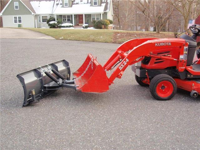

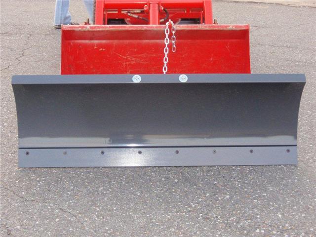

NEW!!! Fits almost any loader
On or Off in 30 seconds. YouTube - BXpanded Quick-On Front blade NEW!!! Ships right to your door.
Advantages of this system:
Fits almost any loader.
Available in 60" and 72" widths.
Several different types of replaceable wear edges are available to match your use.
Heavy duty skid shoes available.
Allows loader to remain on the tractor and available for use in about 15 seconds.
Installs in seconds with no modifications to your tractor or loader.
Installs with no tools.
Blade floats independent of the loader bucket.
The loader can apply down pressure if needed for removal of packed snow or ice.
The angle of attack of the blade can be changed by manipulation of the loader bucket.
Will ship UPS or FedEx Ground right to your door eliminating the hassle and high cost of Motor Freight.
Wheeled storage dolly (cart) will be available to make storage and installation a breeze.
contact@bxpanded.com for details

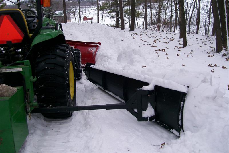

That's a nice plow, Beenthere.
If you don't mind me asking, what was the price?
Thanks. I like plowing snow.
New in '99, plow and A frame complete at $1300, as memory serves me.
Attaching bracket fab'd was $250 at local welder.
This winter added the wing plow. It has added greatly to the enjoyment of maintaining about 1/4 mile of "drive" and three turn-a-round areas. Quick to roll out, attach with two pins, and push snow back.

When I see that length of space from the loader to the blade and add that to the distance the bucket already makes to the mounting frame I start to wonder about leverage and forces. The further you get away from the loader frame the less power and more prone to damage parts become. It's more than just speed getting a part on and off. While that's nice, it's secondary.
Placeing the blade directly on the frame or loader mount increases strength marginally.
How do you justify your design?
Thanks,
Rob

Hi Rob, Good question. Thanks for asking.
The side load that can be applied to the loader frame is limited by the lateral traction of the front wheels. Granted the leverage is greater, so the force required at the blade to slide the wheels sideways is less, but the maximum side force on the loader arms is limited by tire traction and remains the same. I suspect the traction of the tire with no load on a snow covered or wet surface would be far less than that of a tire weighted with a full bucket of dirt on dry pavement. Who hasn't scooped a bucket of dirt while turning slightly?
