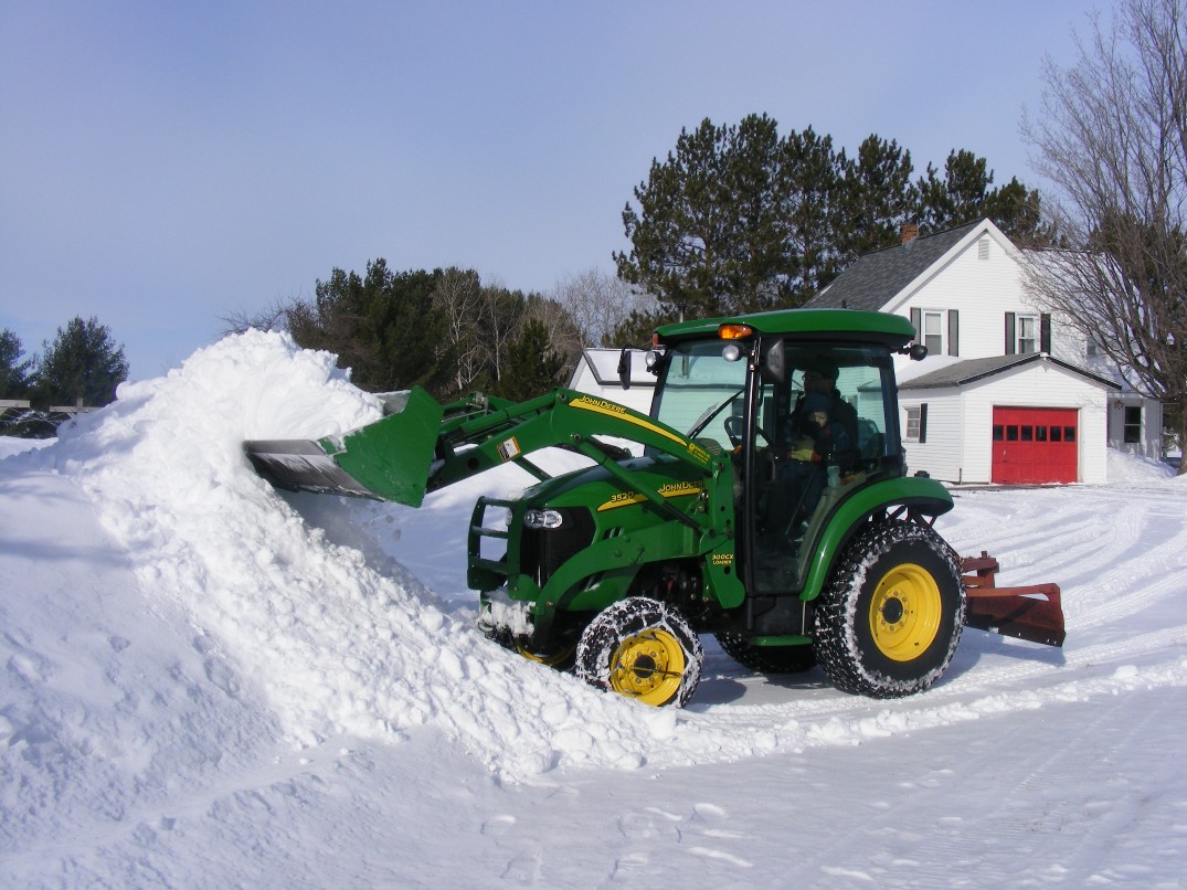

The answer to the original question is "it depends". I would love to have a snow push bucket to carry about twice the amount of snow as compared to the standard FEL bucket. If you have a long driveway, then front blower & backblade is probably the ideal solution. Our yard is flat, we keep a large area (~1 acre +) open, and we get a lot of wind. If we had a blower, would have to blow the same snow 2 or 3 times (have done it before with walk-behind blower). Now use the front-end loader (float-down mode) slightly tilted up so it doesn't tear up the lawn. Use the back blade at the same time to keep the "mat" down. Moving snow is probably the most enjoyable use of my tractor so far.....
