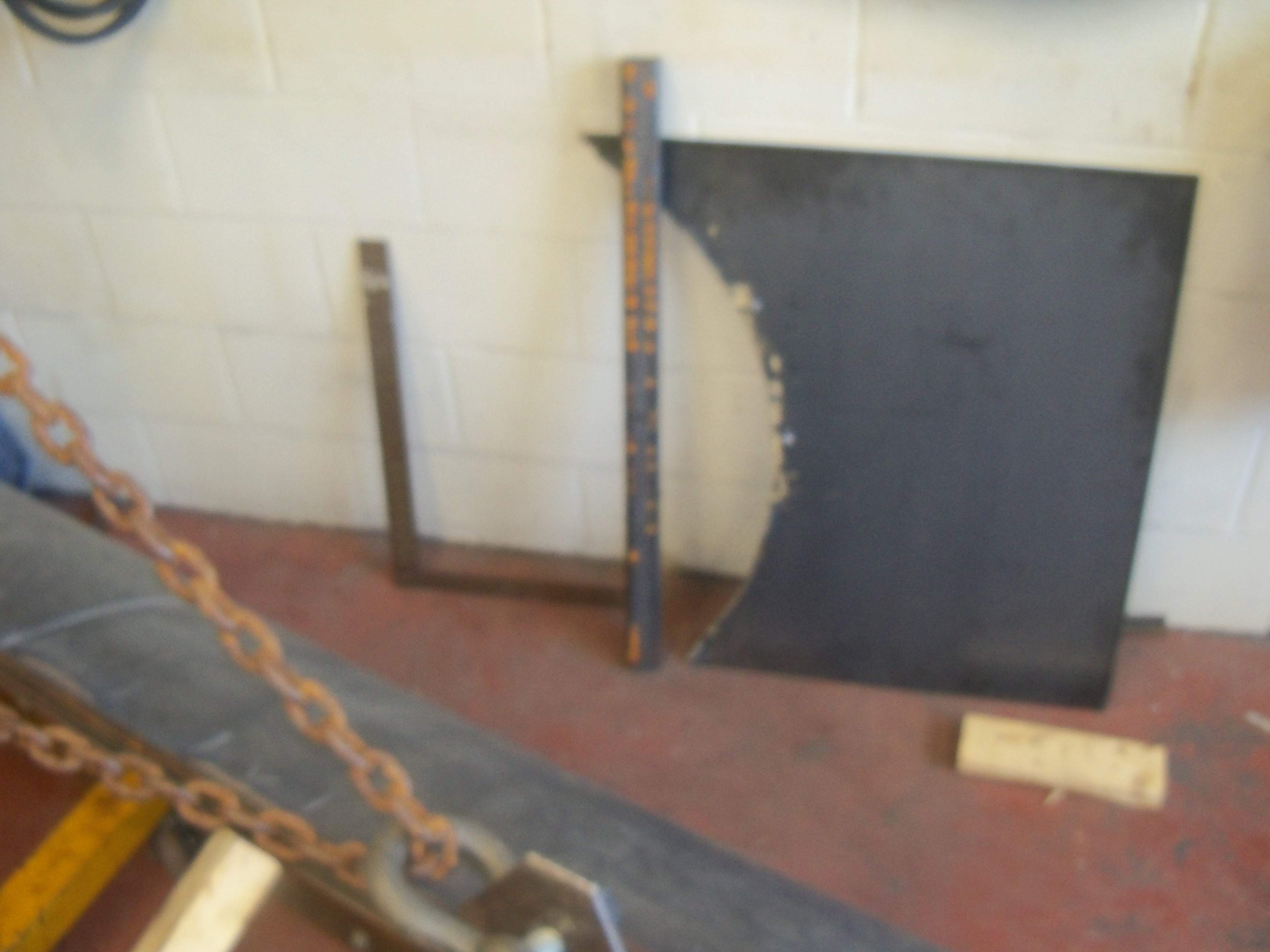

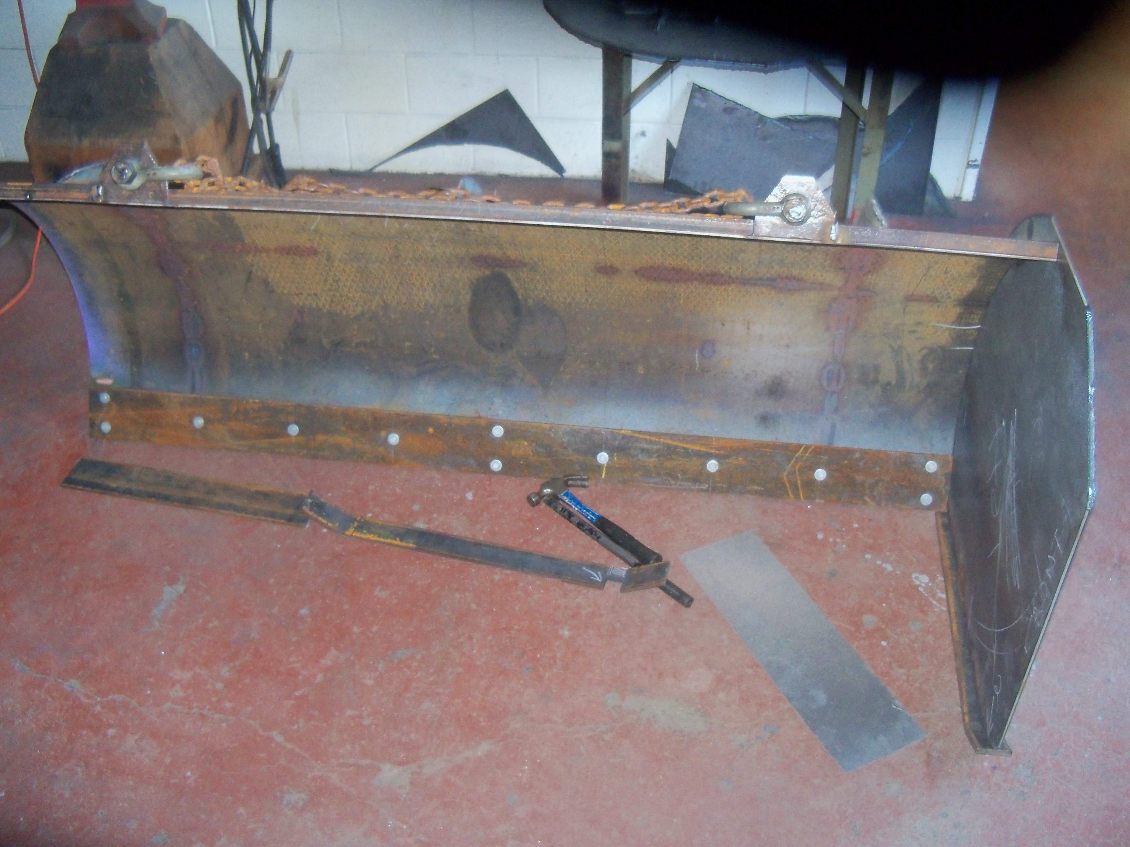

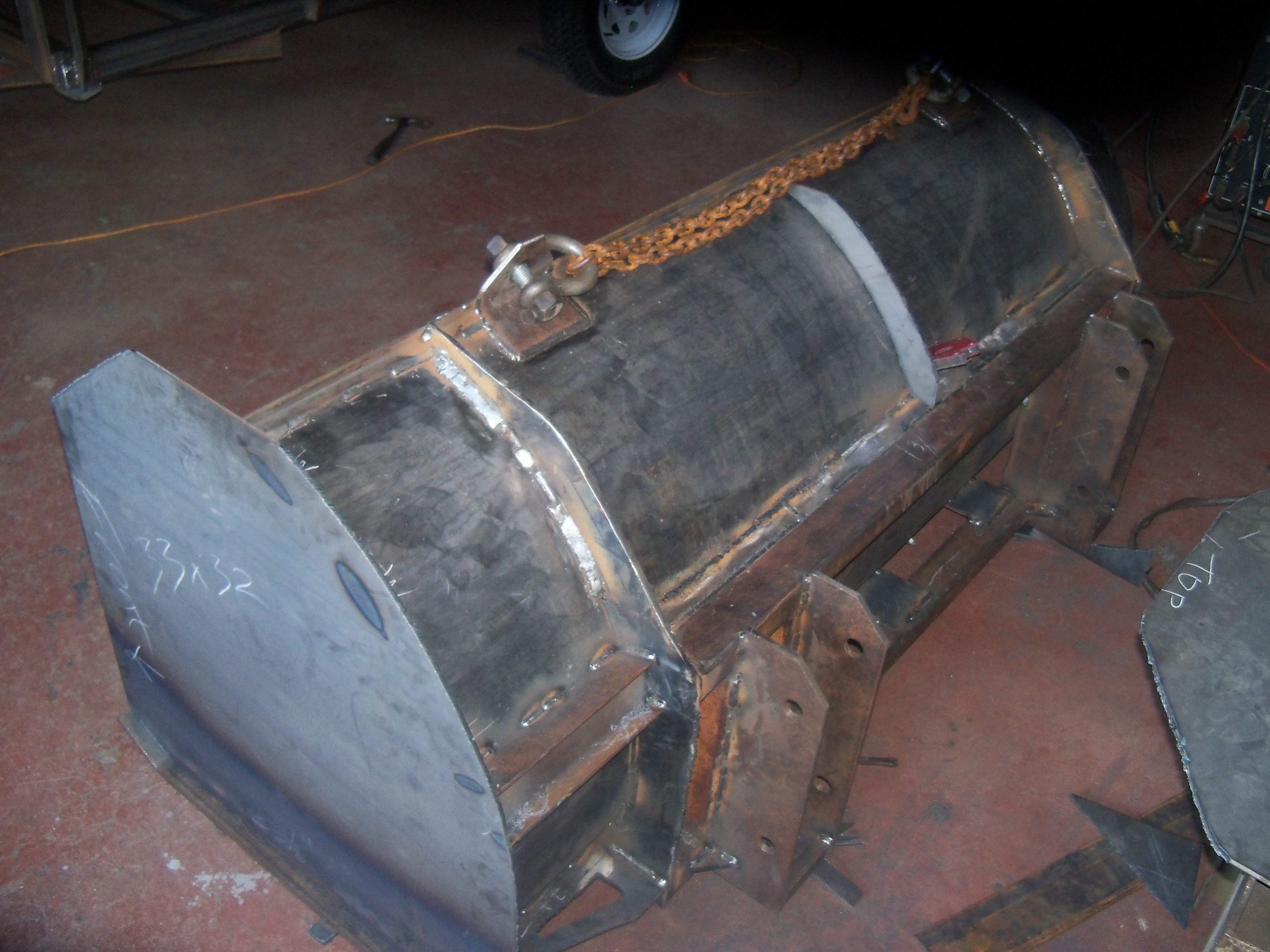

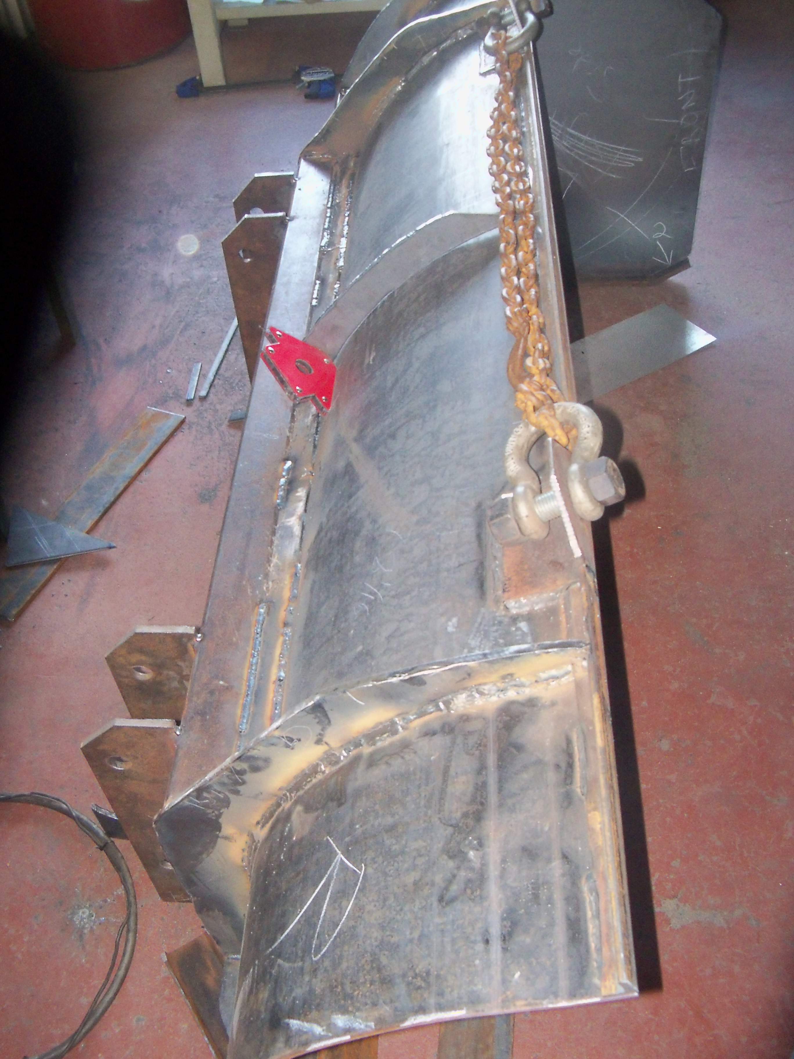

Thought I'd share some pics of the 6.5' snow pusher I am building. Will update along the way
Plow is 3/16" thick rolled steel, 32" high, 78" long
3/8" x 5" cutting edge
/ Snow Pusher Build #2
Looks like a good start. Are you working on that in a community welding shop or school?
Thanks for sharing, everyone enjoys the pictures.
/ Snow Pusher Build #3

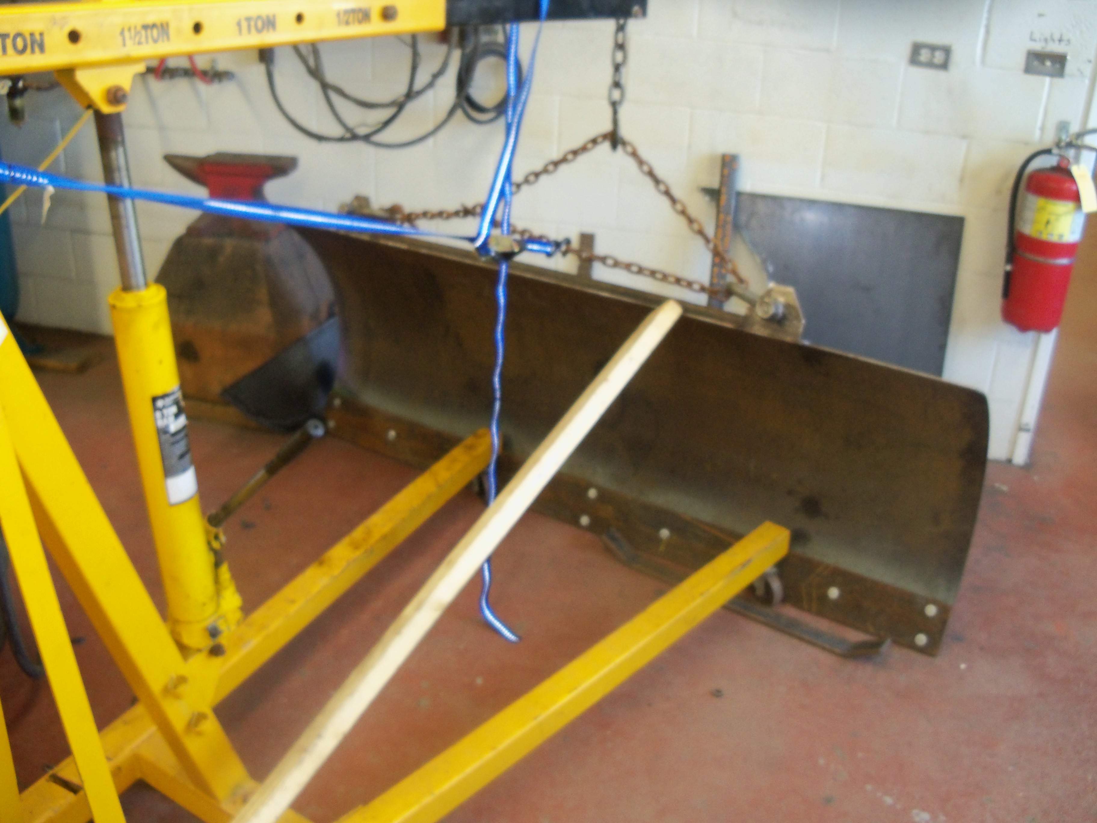

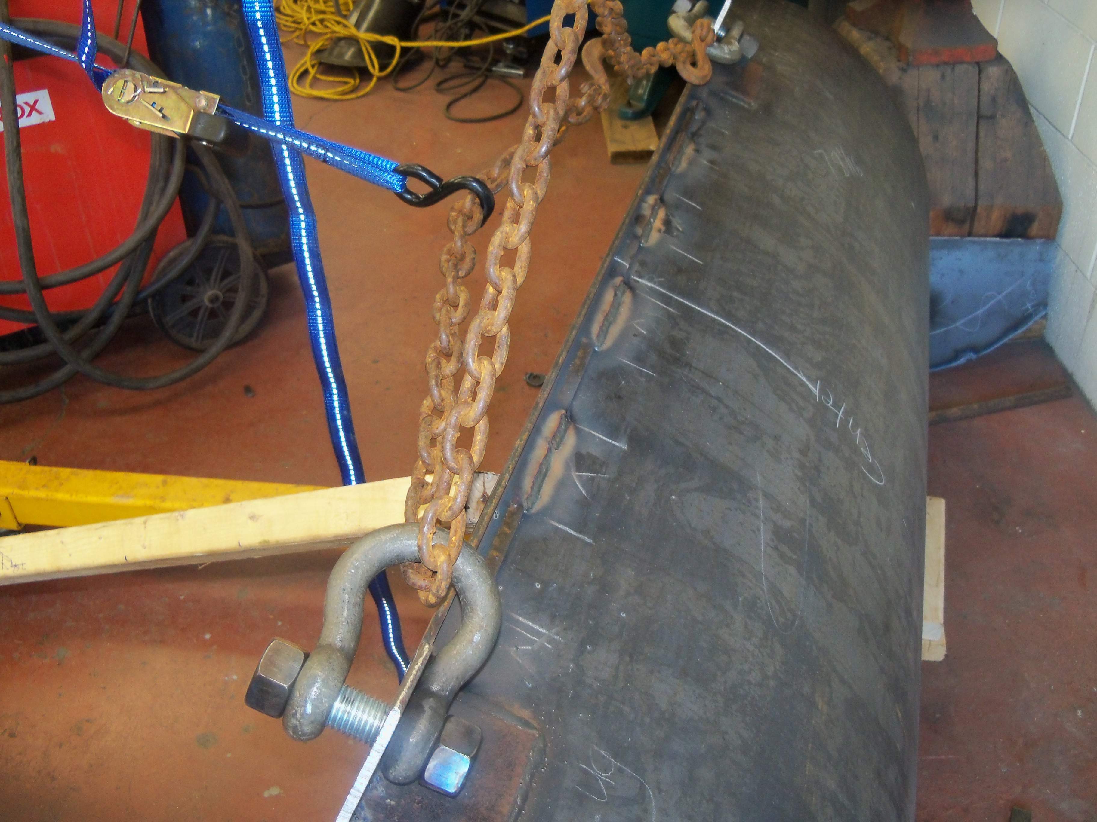

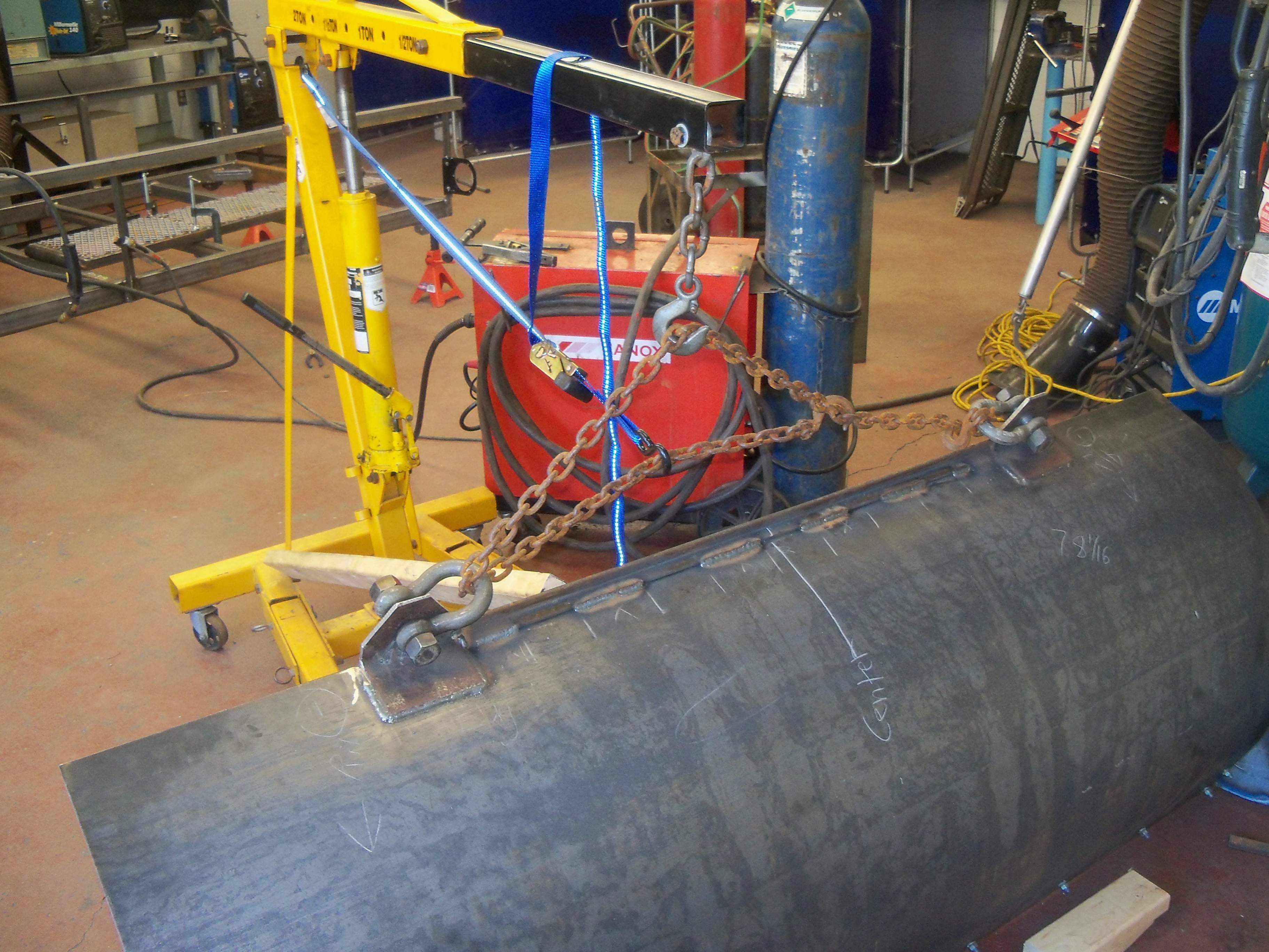

How did you bend the steel?
