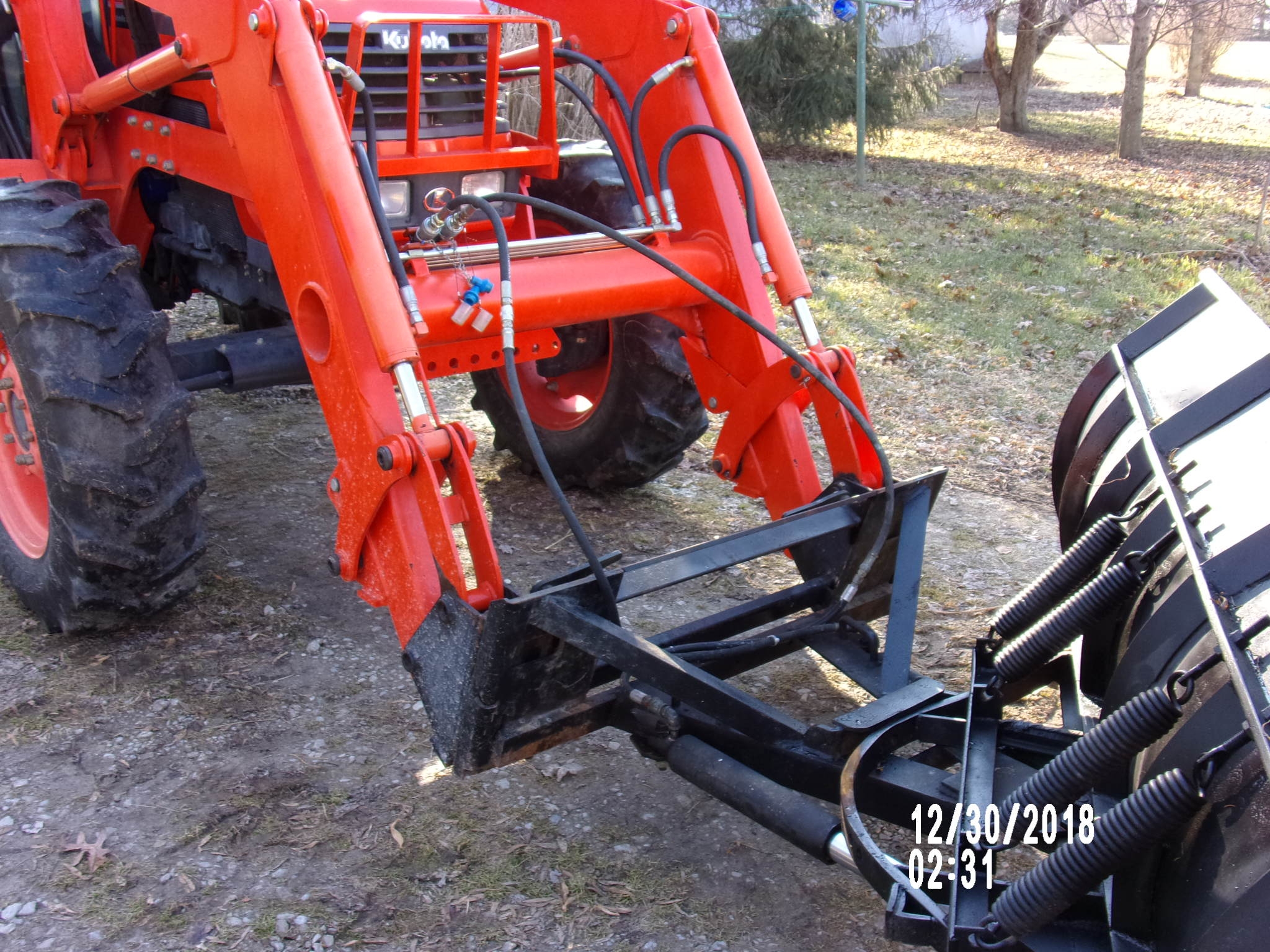

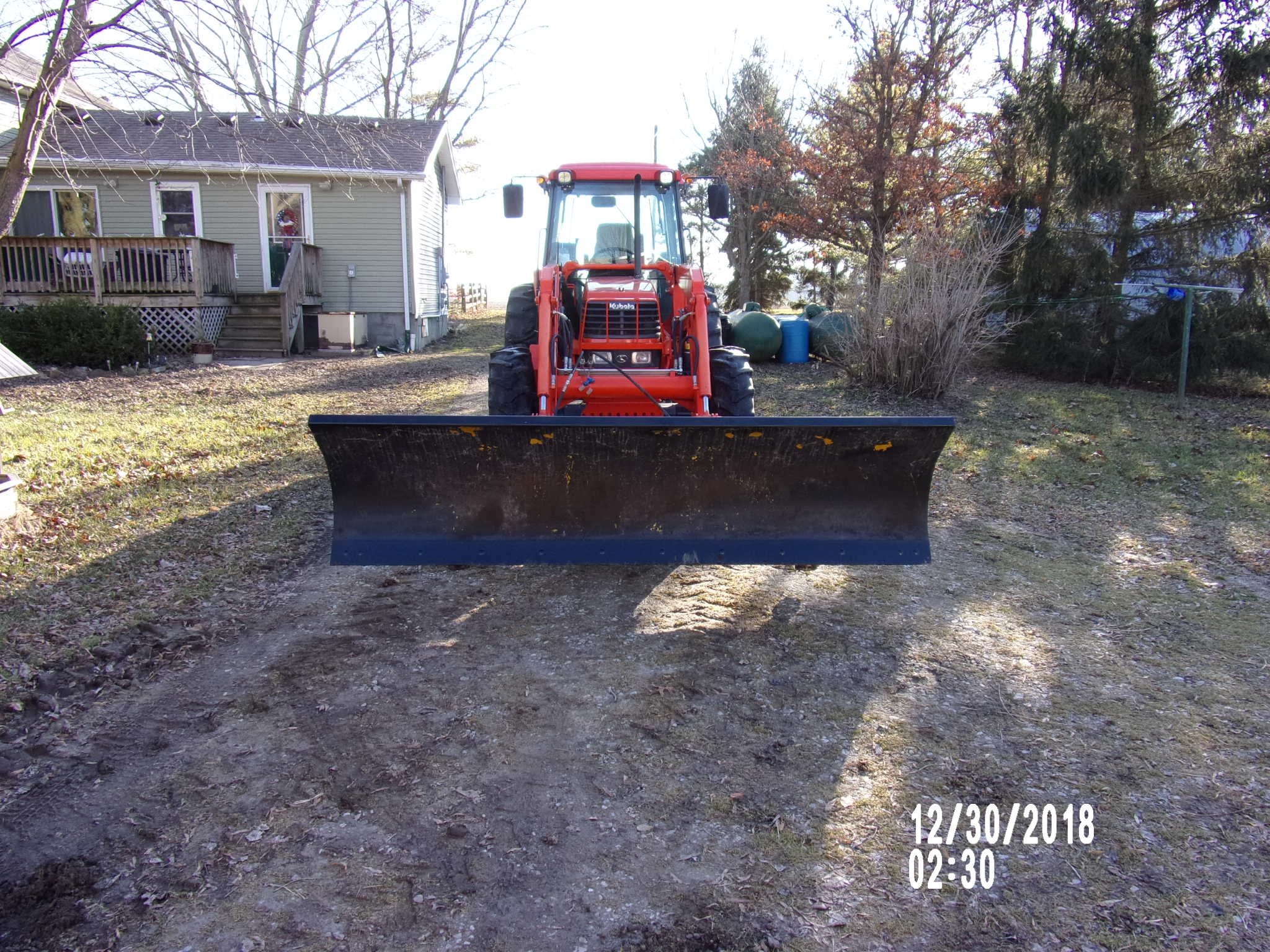

I have a 10 foot repurposed county plow with power angle and I run front chains only on my 90 horse Kubota.

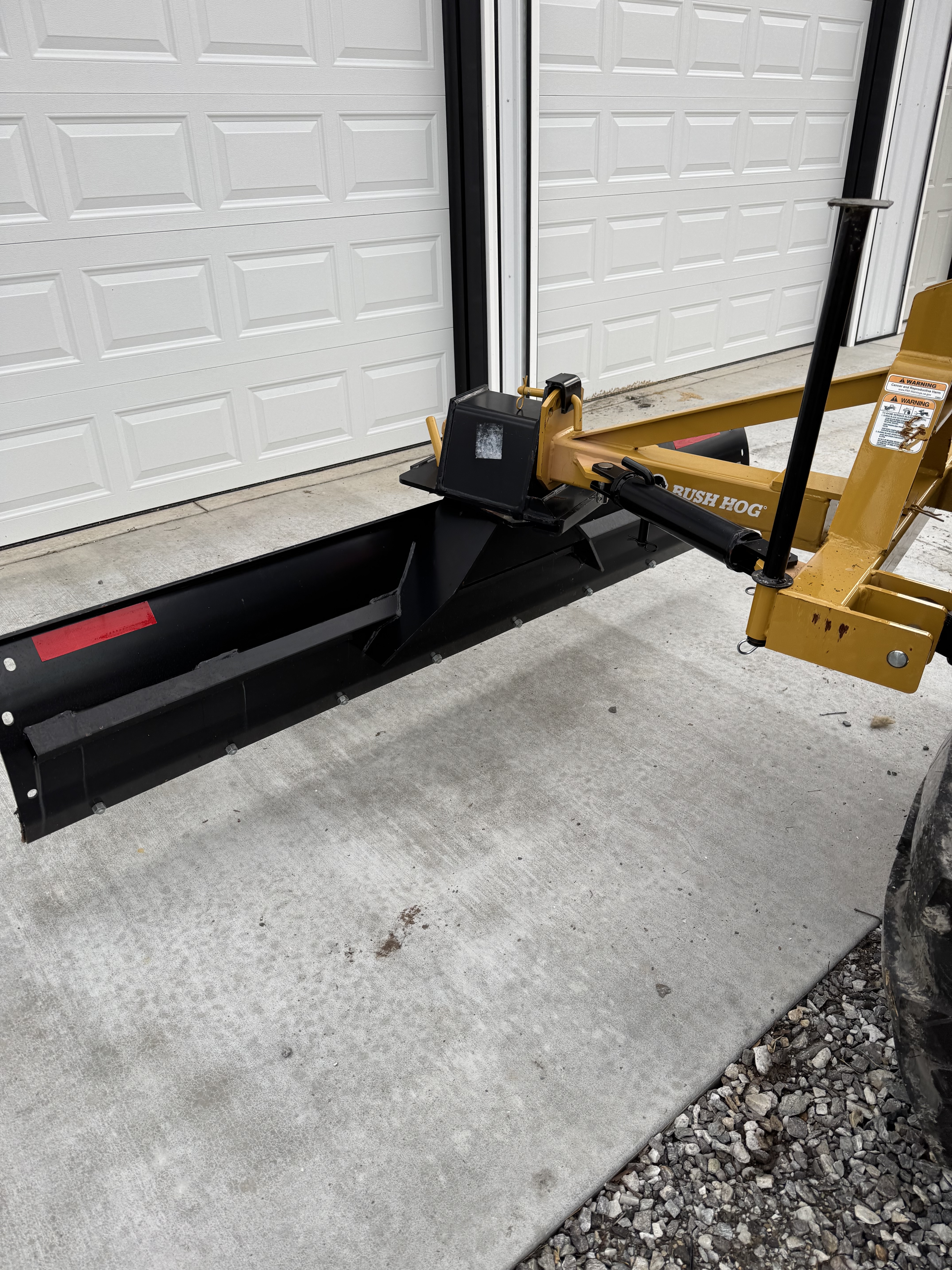

been really busy and haven’t purchased a plow yet, and expecting a big snow storm tomorrow. I decided to take some of the advice given and picked up an 8’ rear blade today (bush hog BH70-08). Looks like a nice blade and was $2000 cheaper than the price I got on a Woods from another dealer. Have it mounted reversed and we’ll see how it works.View attachment IMG_0558.jpeg

Be very careful pushing with that set-up,no relief springs/trips ect.They are made to "pull".Very expensive things can break.
/ What size snow plow?
#17
Thanks, I have no intention of pushing with it.
/ What size snow plow? #18
Ain't that the truth!
Not from a blade, but I did $2000 worth of damage by snapping off a lower 3 point arm connection point on the tractor case.
