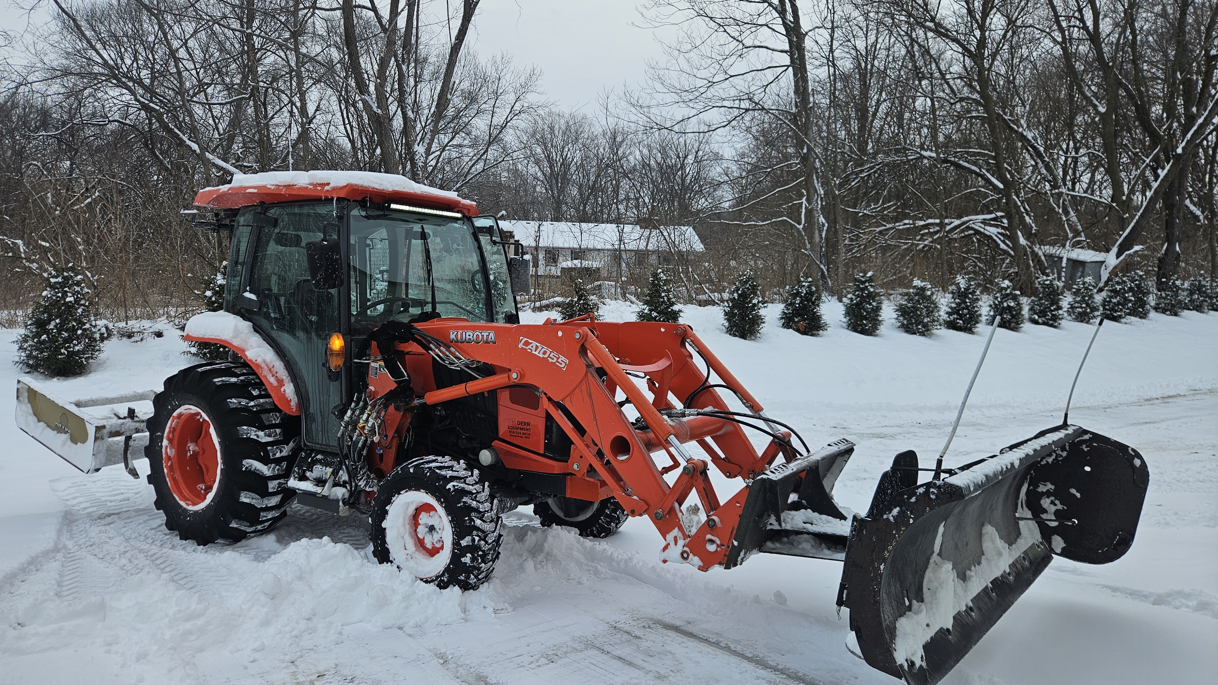

Just fyi if you do end up with one in the future I have an 84" quickattach brand plow and it covers my wheel width on my Kubota L6060 when angled. 20250218_095020.jpg
