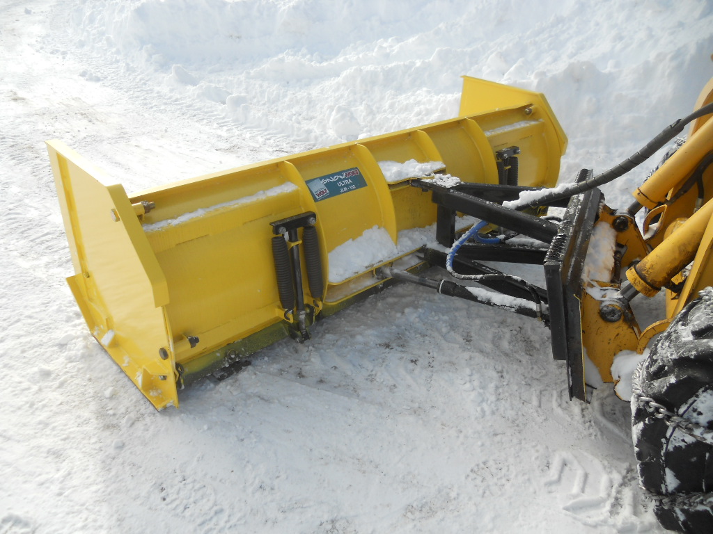

Is there such a thing as a pusher that articulates like a plow does? The ground I'm clearing isn't flat like a parking lot so it would help if the pusher had a way of keeping itself in contact with the ground.
I have a Mahindra 2538 HST Cab.

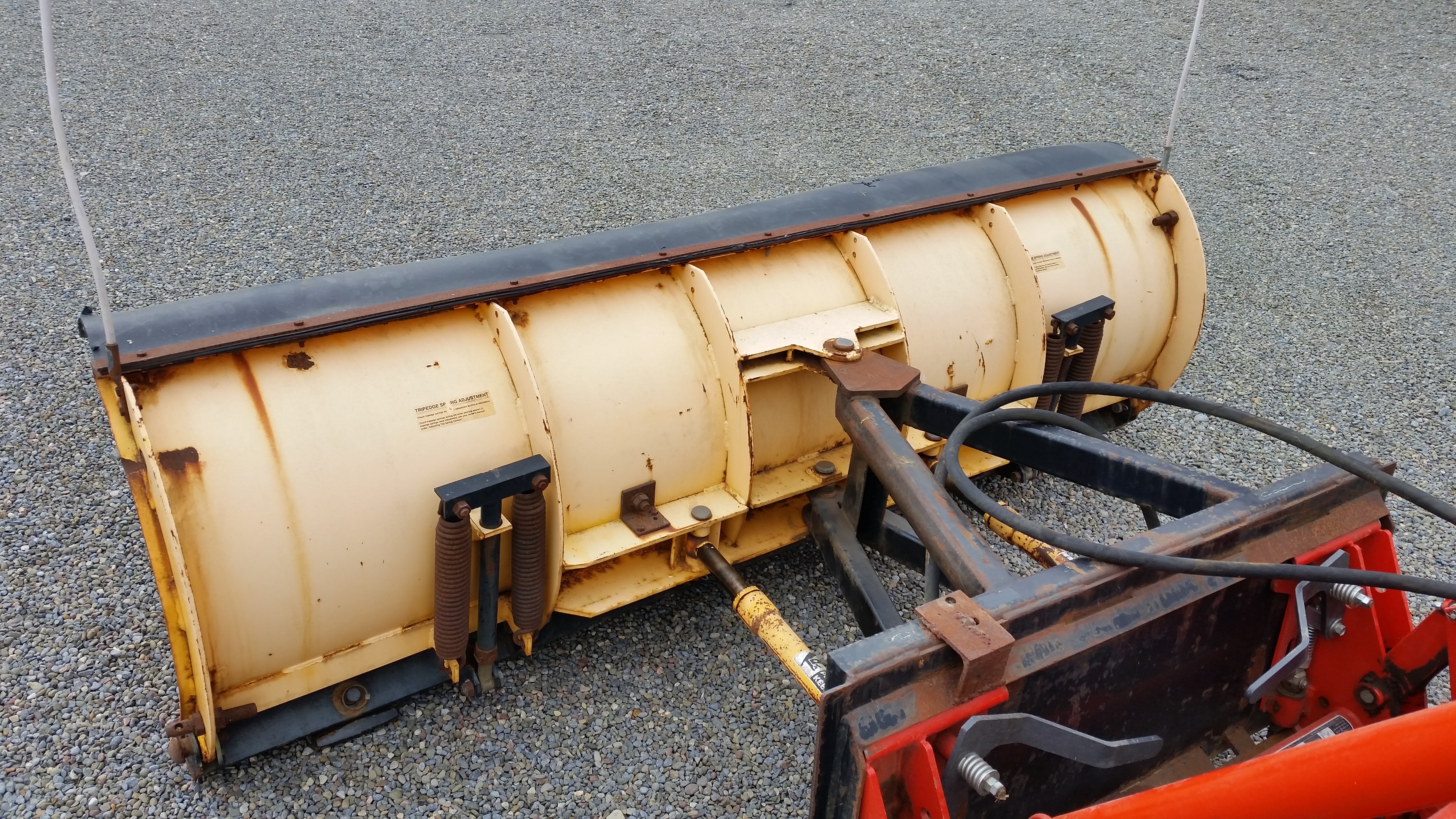

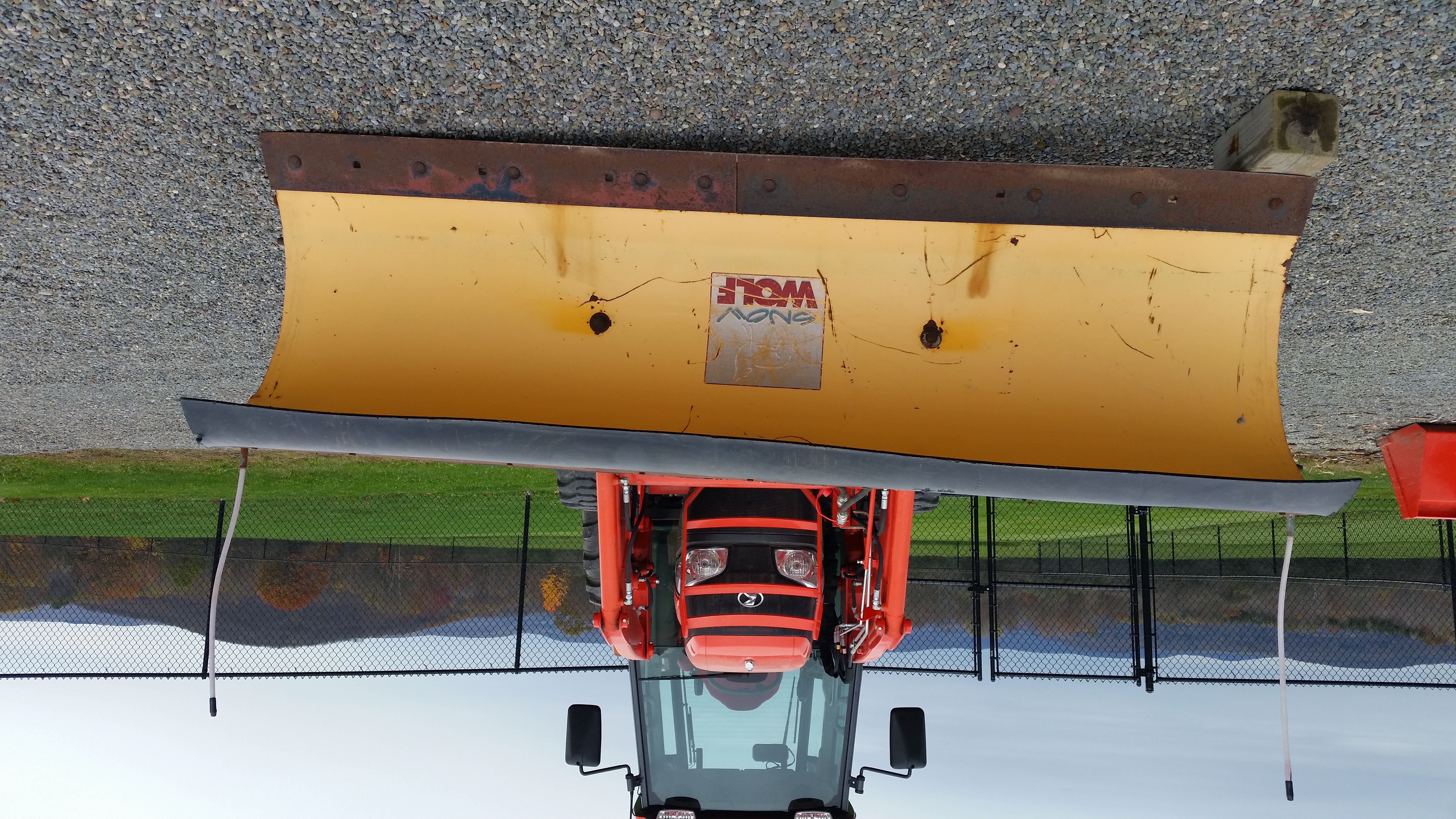

Snow Wolf has it, although not a true pusher box.
The plow is mounted to the frame vertically at 2 points (like a Diamond brand plow), the top hole is elongated L-R and allows for lateral movement. It's a very tough plow, I have not bent or broke it in front of that 5 ton skid steer, and I bought it about 15 years ago!
Of course I am confused about your question of what you want to float or "articulate". It does not float up/down like a truck plow dangling from a chain.
   / Snow Pusher with articulation? #34
This shows how the Snow Wolf tilts side to side. I regret selling this one.

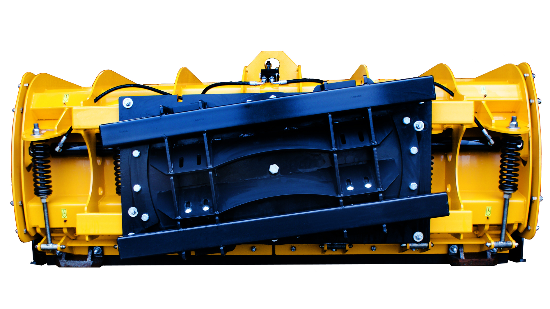

What you are talking about is called a lateral float system. Here is a sample which can be mounted to most quick attach adapters. Check with your HLA or Cotech dealers they should have access to them.
   / Snow Pusher with articulation? #36
The problem with adapters is they push everything further out. Tractors are already hurting with the loader hanging out really far. Then add in truck conversion plows that expect to be mounted a ways back under the bumper & it gets really awkward.
My first plow had lateral float & I mounted it to a SSQA to 3pt adapter. Lots of float, but it hung out way far & pushed sideways a lot. My new plow has no float but still hangs out a long ways. My to do list includes making a floating adapter between the plow frame & SSQA plate. I'll also tuck some of the plow frame under the loader when I do to pull it in closer to the tractor.
