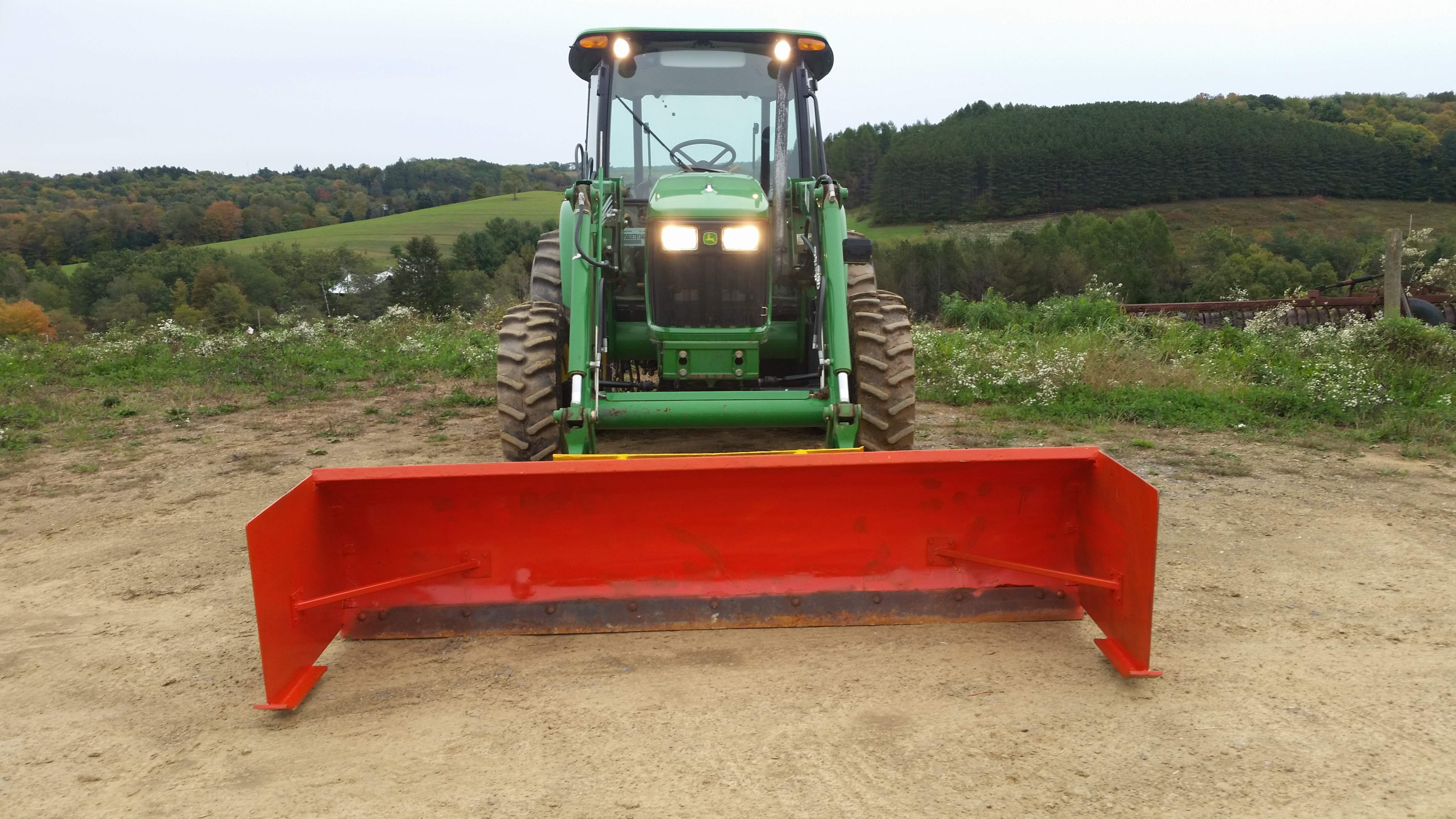

I personally hated the snow plow mounted on the loader and I[ have modified an older 9' meyer plow to be a snow pusher. I'm going to try it out this year and see how it works! ATTACH=CONFIG]444786[/ATTACH]
I did make a subframe mounted snow plow for the L3400 and it worked GREAT! Only problem was with a full blade of snow it didn't like going up hill to much even with the front tires chained, down hill and flat I could push snow till it was spilling over the top of the plow.

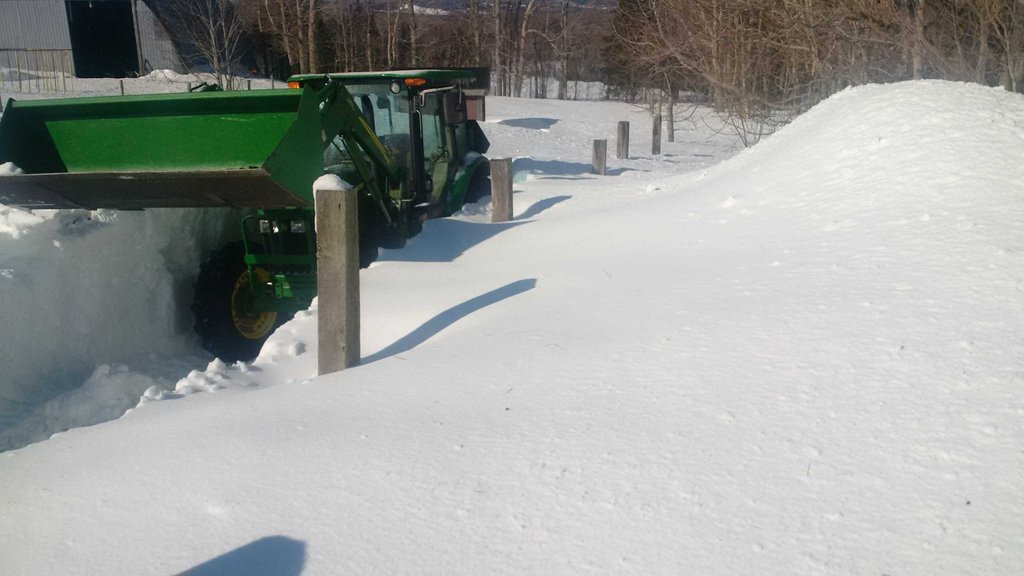

Maybe you guys don't get as much snow there.snow.jpg I can't push a heavy snow here, drifts get as high as the cab roof in places. If you only get 10-12 inches at a time you don't really need a blower, I just assumed you guys would get similar snow to us in NS, guess not.

Your snow pusher. The side wings have skids on them...but....they are higher than than the blade. Doesn't this allow the blade to dig in on gravel?

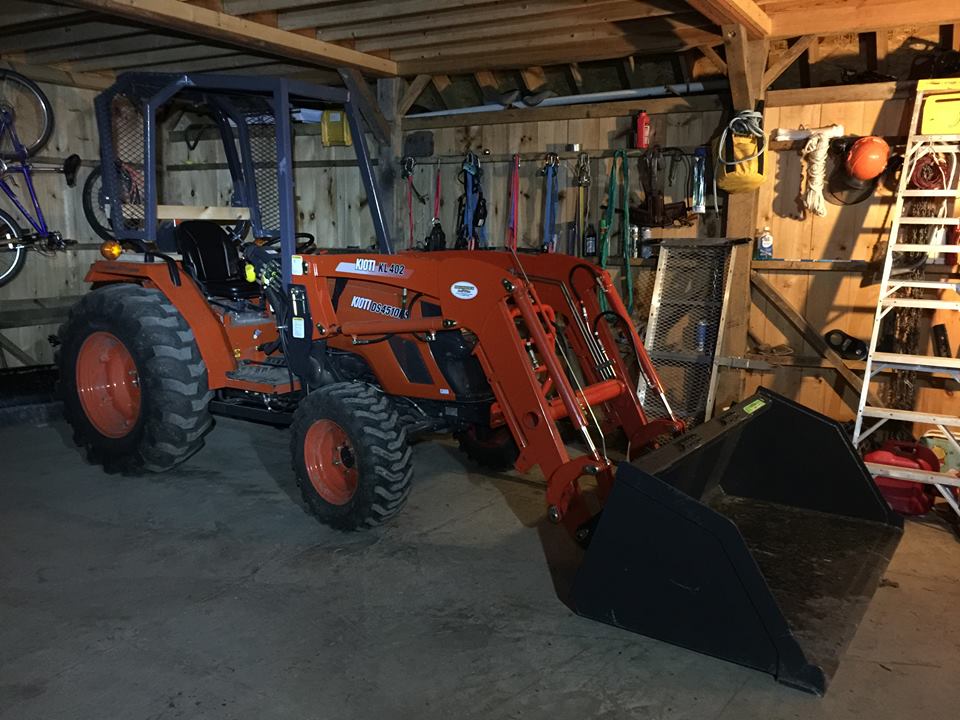

Standard buckets are too small for snow. A high volume snow bucked controls a lot of the spill (and is very inexpensive, mine was $650). Put some edge tamers on the bucket (I like to use 4 when the ground is soft, 2 is fine when not as soft). Link attached for edge tamers. 403 Forbidden These work so well that sometimes plow the whole back yard for the kids to play soccer. Doesn't even make a mark on the turf and the snow typically comes off right to the grass.
A FEL mounted plow shouldn't hurt your tractor. Tractors probably stand up to plowing better than trucks. However, FEL mounted plows stick out too far and for this reason will push the tractor sideways more than a truck. This is due to the ratio of the distance from plow to front tires vs the wheel base. The plow has more leverage on a tractor when mounted way out front and tractors have shorter wheel bases than trucks. However, truck + plow = big money. I don't think you will be able to plow 2-3 feet of wet snow with an angled plow on the FEL. But a truck would have problems with that amount of wet snow also. That leaves a blower or bucket as your only real option on the biggest storms. (that or hit it 3 times with the plow during the storm)
I like bucket up front, hydraulic angle blade rear and I can plow in both directions so there is little wasted movement. Very efficient.
Some pictures of snow bucket to give an idea of how much more volume there is compared to standard bucket. You can also get these buckets with much higher backs. I chose the lower back because our snow isn't that deep here and I valued the visibility with the lower back. Mine is a relatively narrow 6ft for reasons I won't go into. An 8 or 9' bucket with 42 " back, 42" deep with built up sides will clear a lot of snow with minimal spill over. The one in the picture has 28" back and 42" depth.
Why yes it does. I purposely built it this way though. I wanted to be able to scrape down to a clean surface instead of creating an ice skating rink in the driveway. I can always go back and add thicker skids if need be but I doubt I ever will.
