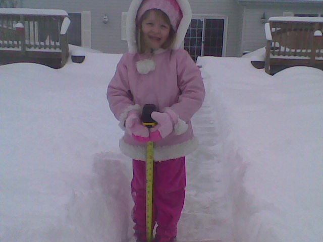

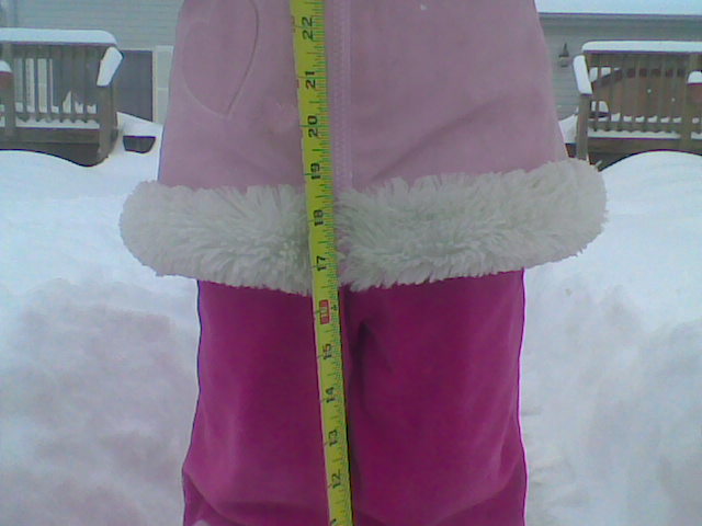

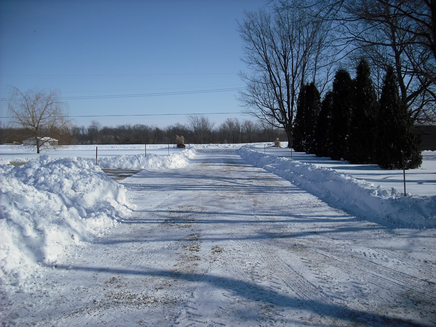

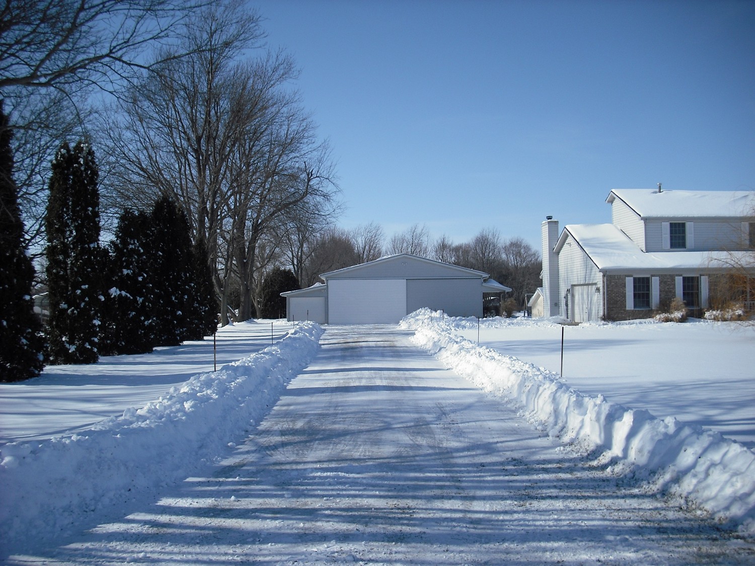

I use a combination of the front converted snow plow on my FEL and a rear 7' Woods Grader blade. After the ground is frozen you do not pick up much. I mark the edges of my drive with marker sticks about every 15 yards and make sure the snow banks stay on the drive, not in the grass. This way in the spring I just re-grade it out.
Here is my drive after a 18" snow. The other pictures are on my back sidewalk to my barn with my little helper Reece. As you can see very little gravel is in the snow banks.
