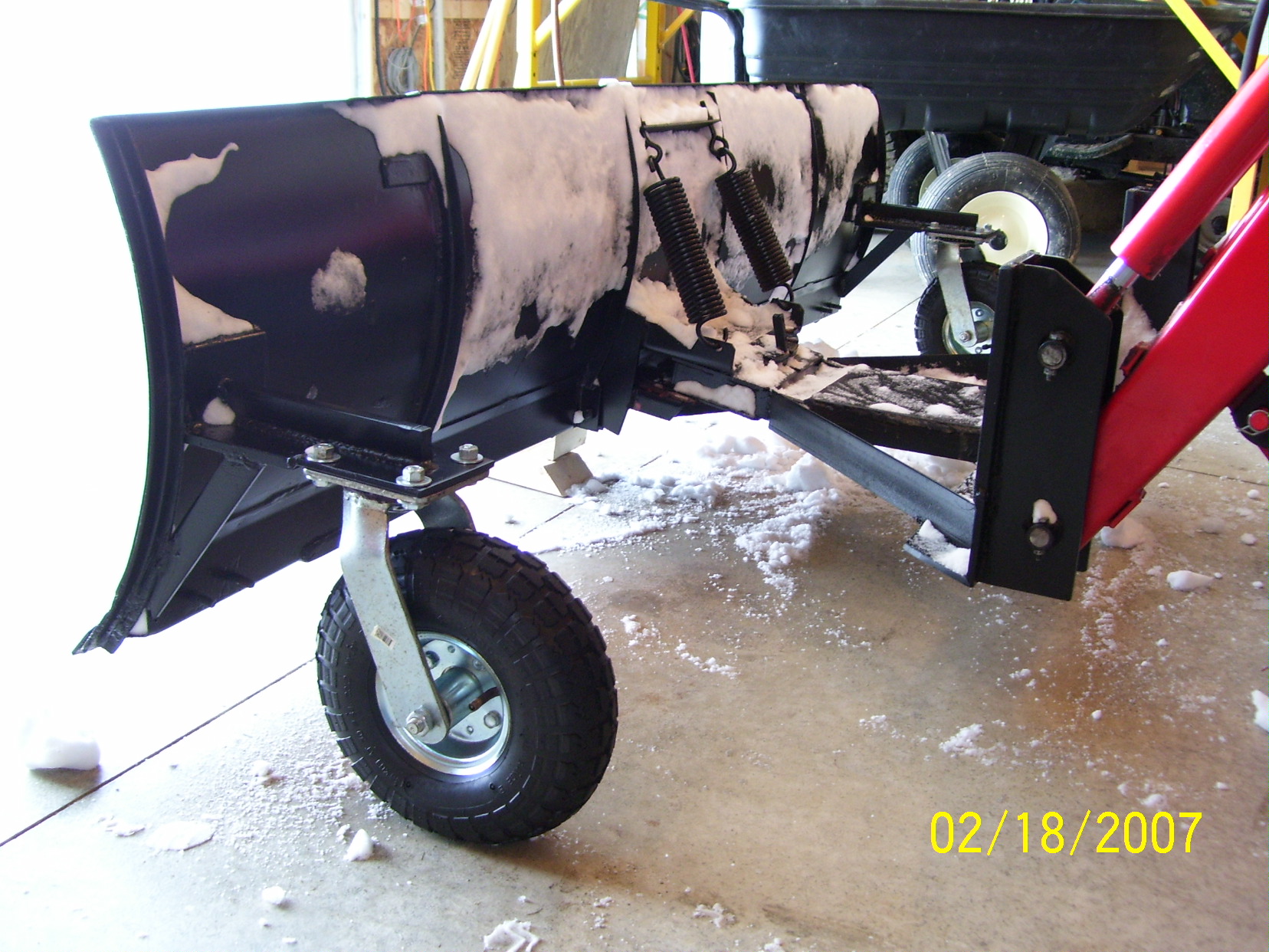

A set of gauge wheels makes for a simple solution.

I've always used our snowblower up here, yep I throw some stones if it's adjusted to aggressive but I just use the smaller tractor with the back blade backwards to work the area until it's frozen down then hit it with the blower when we get a good snow.
